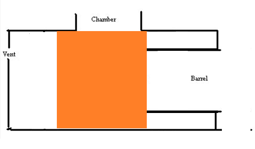

Though if i were making your valve id have the barrel come right up to where the chamber goes off and use a solid piston. First this would mean that there would be no choke on the flow except for opening time and that a solid piston will be much easer to make and will have a less chance of jamming and breakage.
something like this. The important part is where the barrel ends. Preferably use a light material for the piston.
Also talke note of the pic at the botton of this thread, You will have to sand out the fitting to make a good piston that will work.

You could round off the edges on the front of the piston to guide the flow to the barrel port.
( talking about the solid one)
You could use option two, but it will tumble.You need more length to the back piece to make it center properly.
