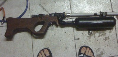

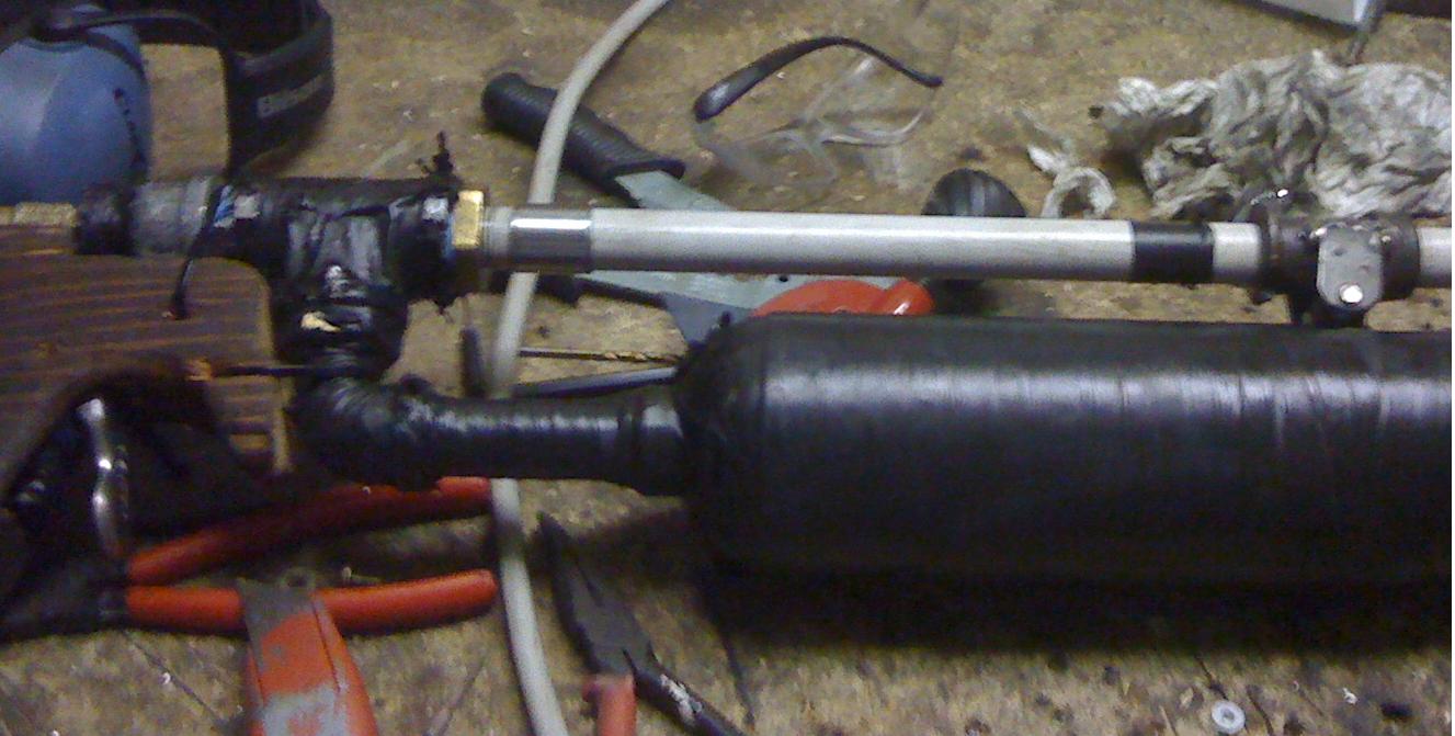

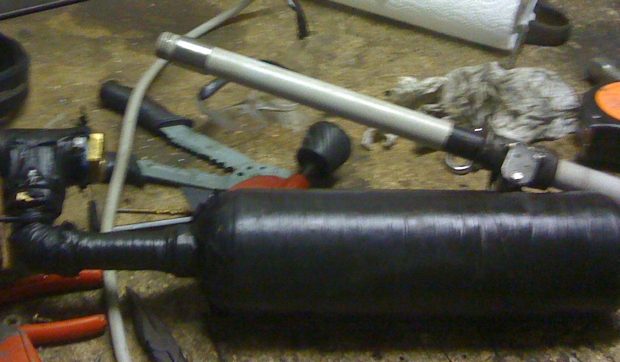

this is the breach closed
i made i kind of brake barrel breach this is closed

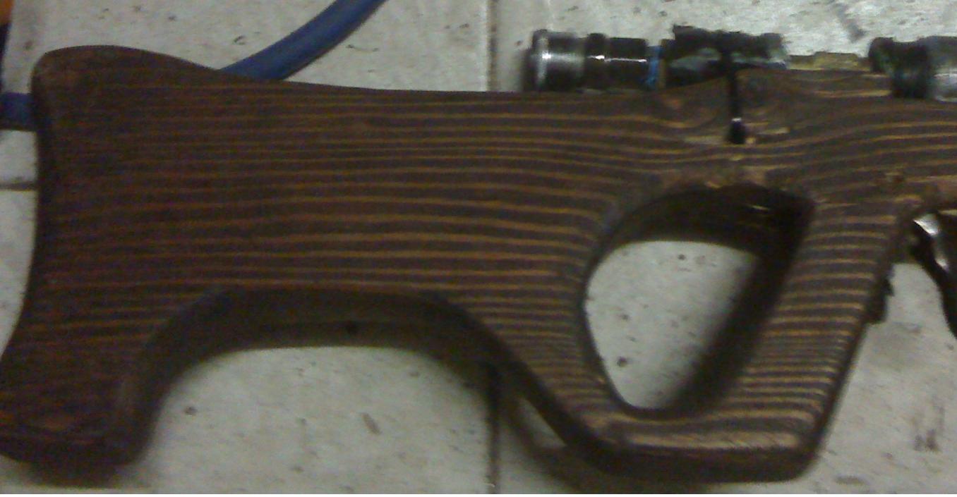

close up of the stock i used a jig saw for the bulk and file and sand paper to finish up. i nice coat of stain it looks good and holds nice but the cheak holder is to high
this is the gun in its glory<br /><br /><br />ps the toes are for jsr

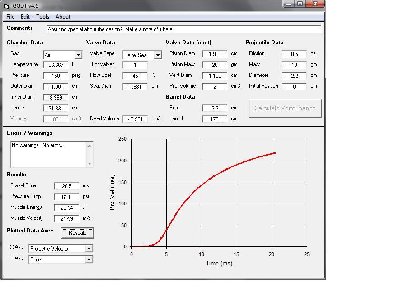

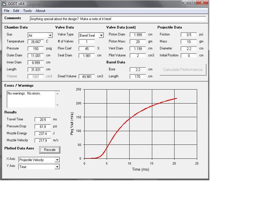

this is what ggdt tells me im not sure if its corect idk what seat dia is or flow coef

Do not care of the flow coef but the seat diameter is on what your piston "seats"
Thats some nice power !

Very nice style you got there.
Finally we see another break barrel breech.
It's been a while.
You could do some more work on the wood though.It;s nice as it is, but if you round off everything so there are NO more flat surfaces, it will look even better.
Right now it's a bit blocky still.But as I said, it's nice as it is.
Make that VERY nice!
Keep up the good work!

as for the stock i was going for a kind of sako trg-42 type stock for a hammer valve gun i made but it was week at 150 psi so i cut it in half and put it on this
