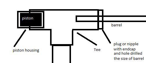

First off, might want to upgrade the blowgun pilot if the volume between the piston and the blowgun is large... And also for the barb problem... you can just put a cap with a nipple to connect it or a threaded plug and drill a hole in it to put the barrel through and the piston would seal directly into the barrel. What size is your barrel? I'm guessing half inch... If it is then this method might not work. But if you up the T size to 3/4 then it will.

- Untitled.png (6.31 KiB) Viewed 2080 times

a blow gun will be plenty for a 1/2 inch tee i use it on a 1 1/4 inch .
if you can solder cut the threds off a fitting and solder pipe in to it.
the pic above is wrong the barrel need to come 1/2 way in to the tee .

Sorry, I drew it in 2 minutes.-_- wrote: the pic above is wrong the barrel need to come 1/2 way in to the tee .
