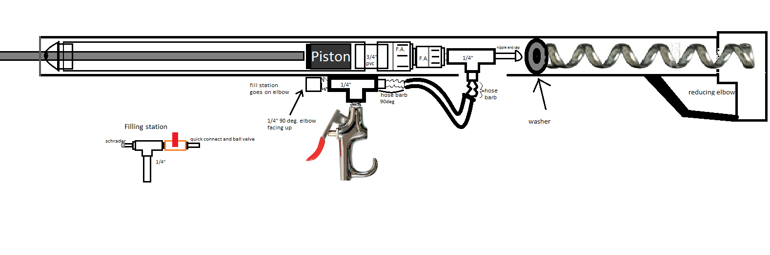

Should a blowgun be a sufficient pilot for this design or should I go with a QEV?
If your piston is tight and you minimize pilot volume, then a blowgun is a good pilot valve.
With a setup like this, there will be a lot of pilot volume.
I don't see why you are absorbing recoil of such a small caliber. Imagine the extra barrel length (power!) you would get if you dropped the spring mechanism.
And even then, you won't need recoil absorption.

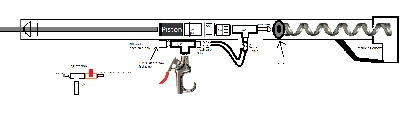

Hawkeye, that is a good idea but I put it on the stock so it wouldn't blow back with the internals. And psycix, I know there is a small recoil but I think it will be cool. Besides, if I am going to model it after the Barret 50 ccal, then I might as well make it work the same way...

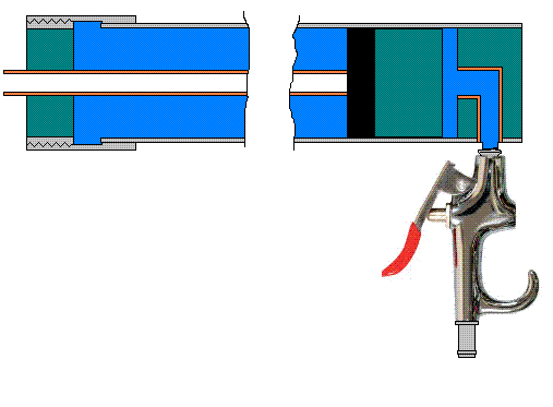

I see this obsession with large pilot volumes persists
Think how compact and efficient it would be with a bit of well applied epoxy, mounting the barrel in a threaded fitting would still allow the (also cast epoxy
)piston to be servicable and by having the quick connect in the blowgun you remove the need to have a separate fill station.
- coax.GIF (9.74 KiB) Viewed 3940 times
Sure it will still move back. The gun is just sliding within the stock tube so if there is a slot for the blowgun to move back in then you just need a comparable slot for the fill valve in the side. You'll just have to hang onto the blowgun a bit. Building a nice comfortable handle around it solves the problem.
If considered in the right light there is a lot of reason to. For single shot cannons I'd probably agree.jackssmirkingrevenge wrote:I see this obsession with large pilot volumes persists
A large pilot volume is wasteful only if the pressurised gas it contains is released to atmosphere. Pressurised gas is gas with work yet to do.
Brian wants to get the primary gas blast to do the work of working the bolt in his auto design but it's fairly busy that end.
Meanwhile at the pilot end the gas is escaping freely.
I drew up plans for automatic mechanisms a while ago but making a strong locking bolt and operating it was too complex. But if a quick connect can be that part then
/cliffhanger
Aside from the increased pumping effort, a large pilot volume means that pressure is decreasing at a lower rate and therefore the piston is opening slower, reducing performance.A large pilot volume is wasteful only if the pressurised gas it contains is released to atmosphere. Pressurised gas is gas with work yet to do.
To cycle a mechanism you have to steal energy from somewhere.
If you have the best performance benchmark being a single shot manually loaded design then any mechanical addition to that design will reduce performance.
If you don't make the trade there is no deal

Thanks for the data. I was thinking about a 6" chamber of 1" galvanized... but I guess it would take too long to pump.
Could've mounted a longer, more powerful gun in the same space or you could've made the gun smaller by removing the useless recoil absorption.Gun Freak wrote:And psycix, I know there is a small recoil but I think it will be cool. Besides, if I am going to model it after the Barret 50 ccal, then I might as well make it work the same way...
Or, by making the barrel longer and the chamber smaller: a more air-efficient gun with the same power in the same package. Just by removing the recoil mechanism.
Recoil absorption is only usable in two cases: to make insanely heavy recoil bearable, or to dampen medium recoil for improved accuracy in rapid fire.
In your case, where neither apply, the recoil mechanism will just make it less accurate as the barrel isn't fixed to the stock. So much for you sniper rifle.
Well, its your loss.
