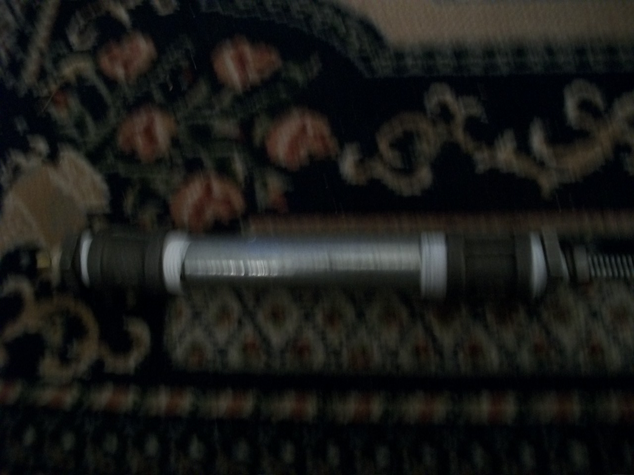

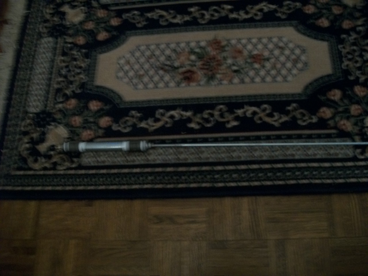

This is my metal BB gun. Its firing mechanism is a single shot hammer valve.
Its chamber is 3/4 galvinised steel and the barrel is 1/4 brake line. The BBs fit loosely so I use a paper towel as wadding. At 80 psi I can shoot a BB clear through a coke can at close range. Ill try shooting some pellets as soon as I get some. As for accuracy I post it as soon as I get to test it outside. A video will be coming soon. Right now it has a leak where the barrel slides into the chamber. Any ideas how I can fix the leak.

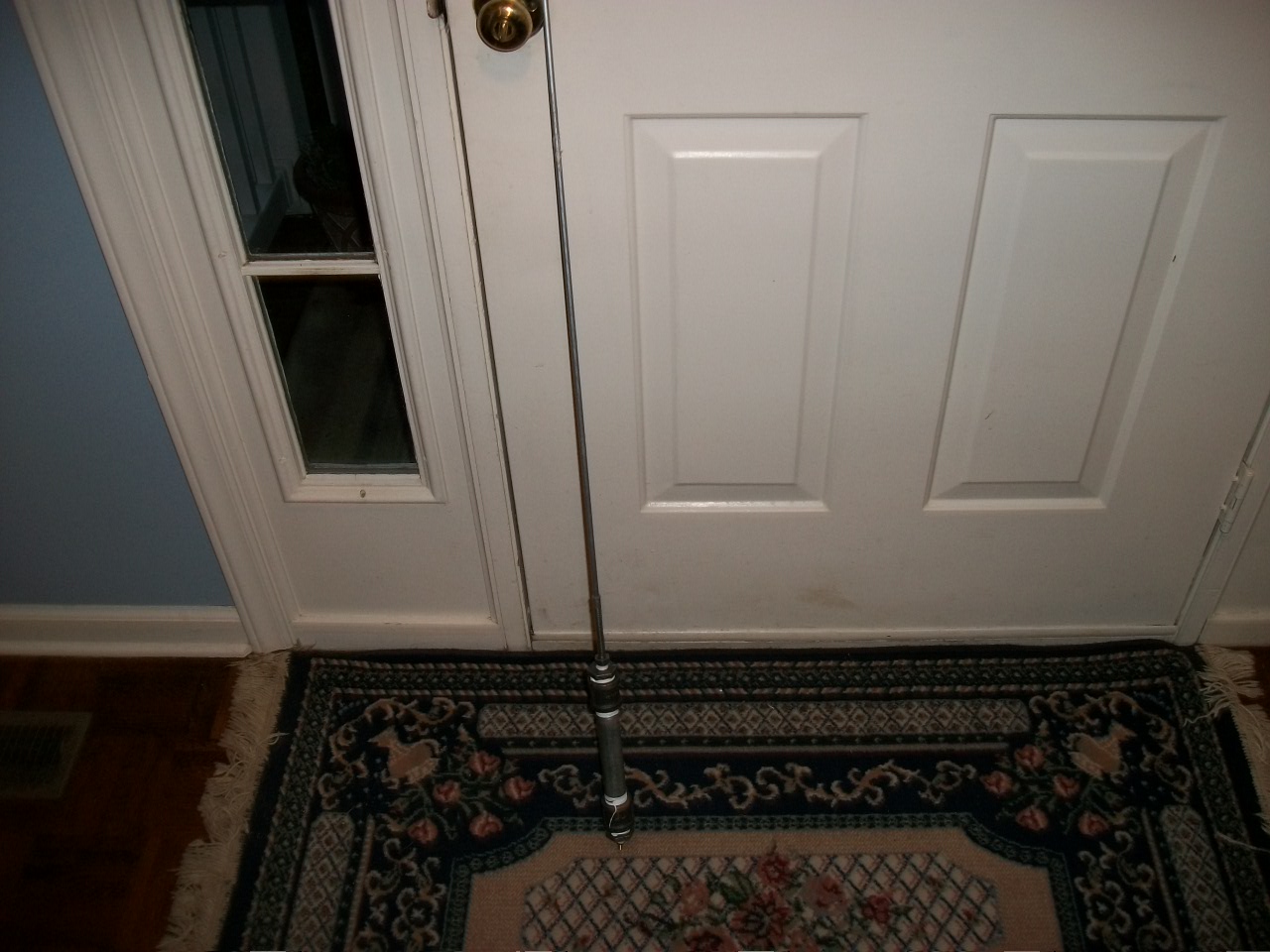

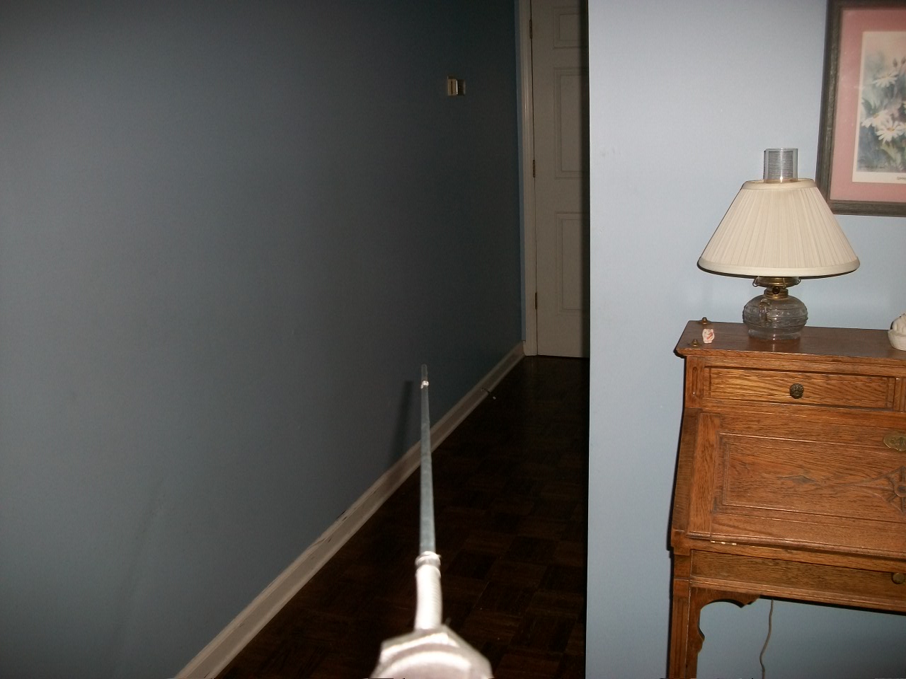

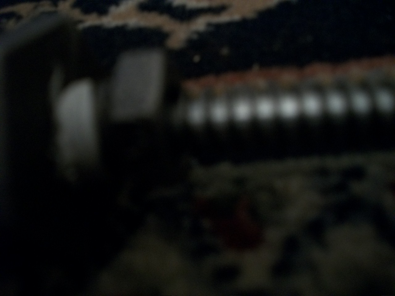

Down the barrel
Down the barrel

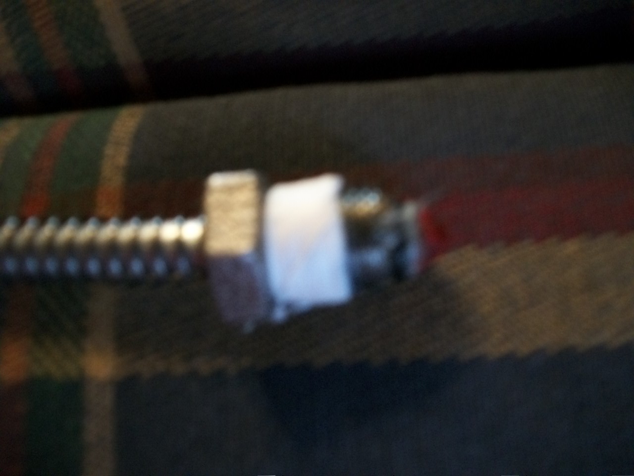

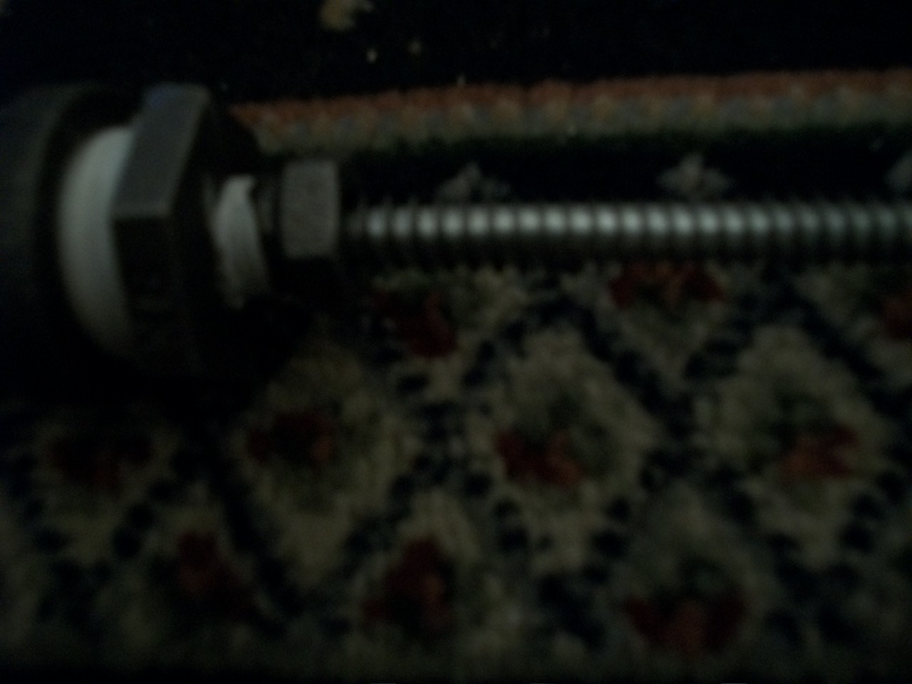

This is where the leak is.

Some epoxy should fix that leak... is there even any teflon?
The pics are really blurry too. Hard to see the gun.

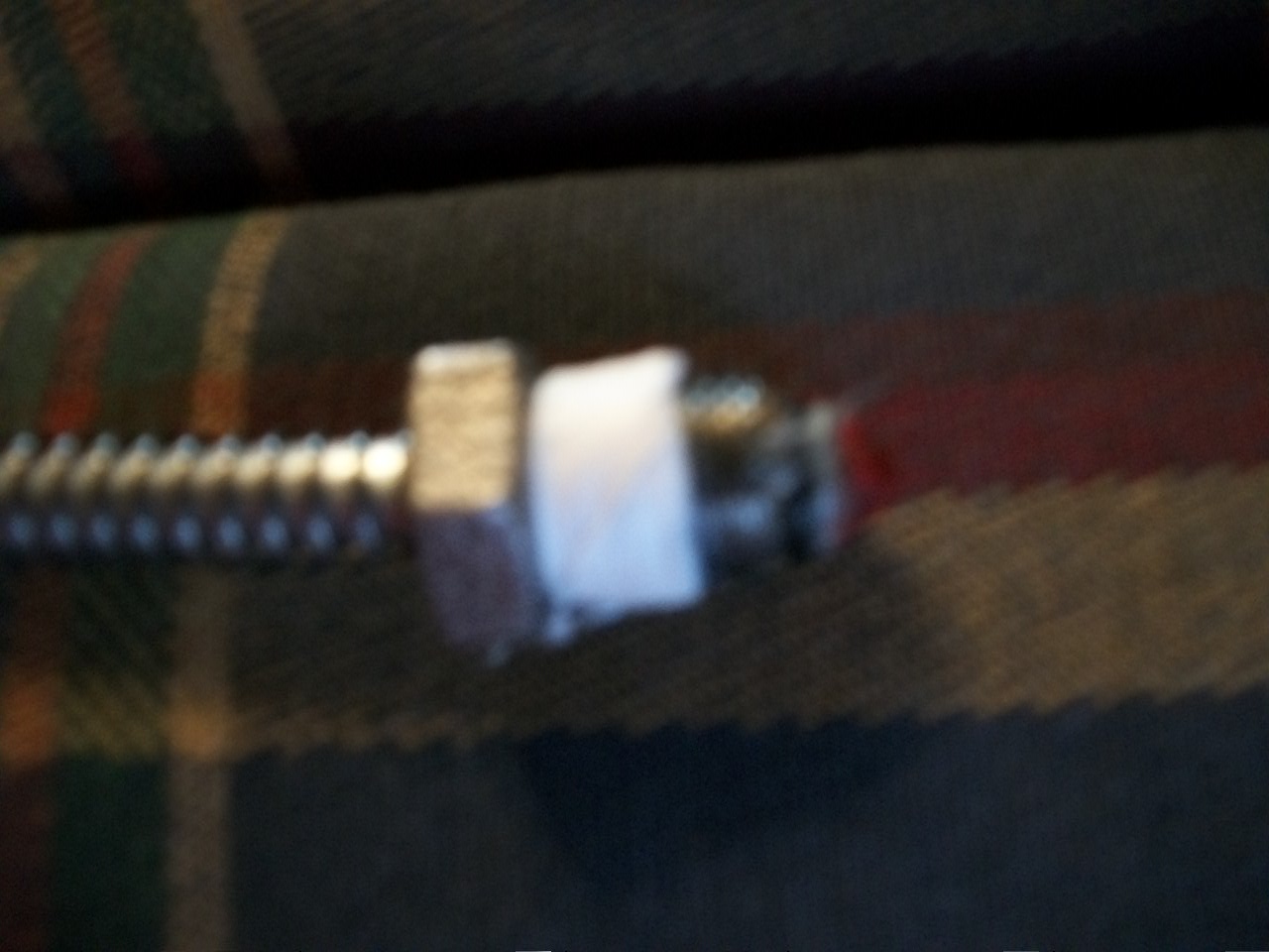

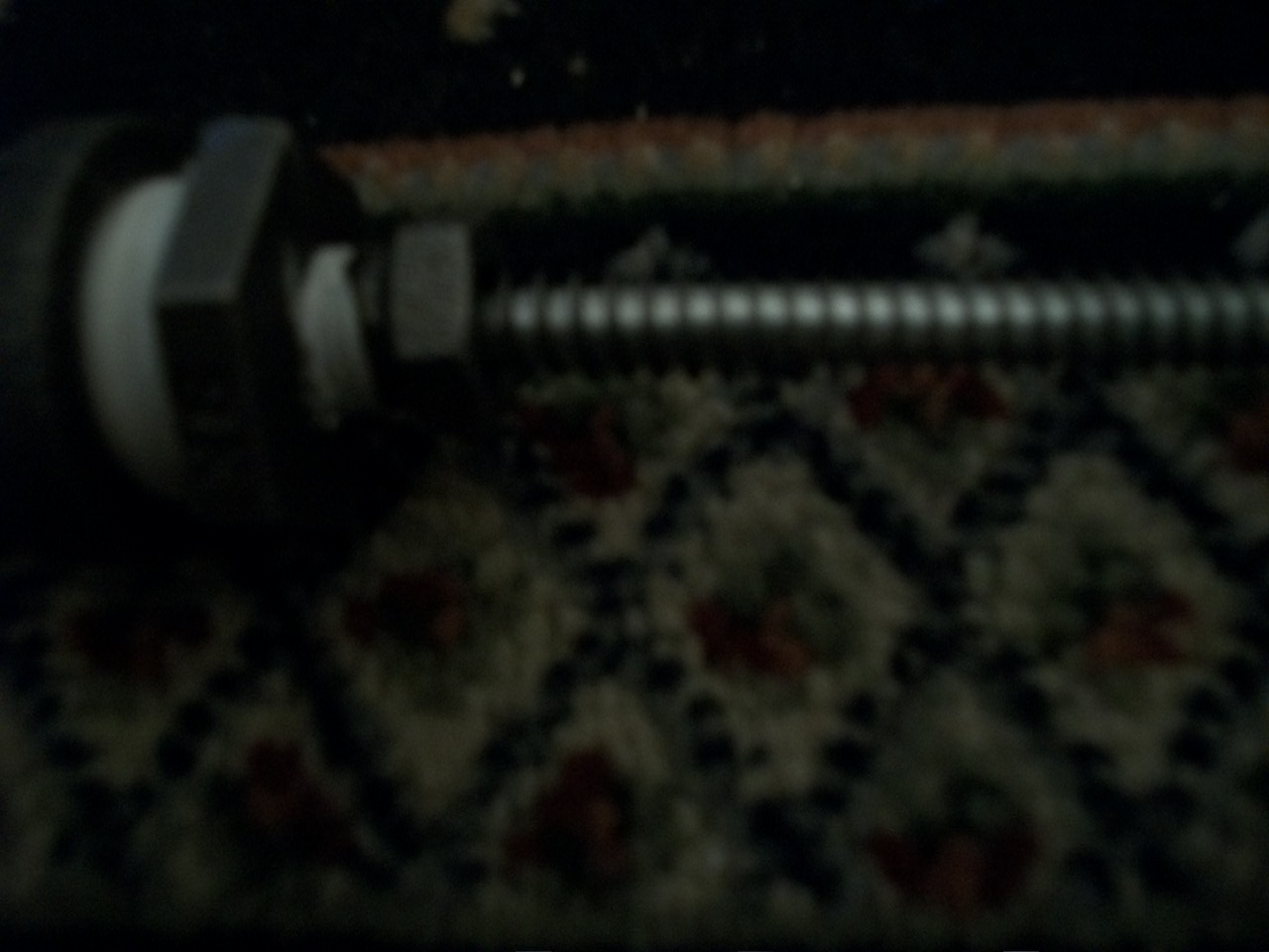

To fix the leak:
You must have a bolt or a nut or something wide on the blocked end of the barrel yes? To stop it from popping out? If you put an oring or a gasket around this so it forms a seal with the inside of the end cap, that thould stop the leak. Lol i used string and hot glue and made my own gasket.... But this gun never worked when i tried it, and i gave up. But i am willing to give it another go.

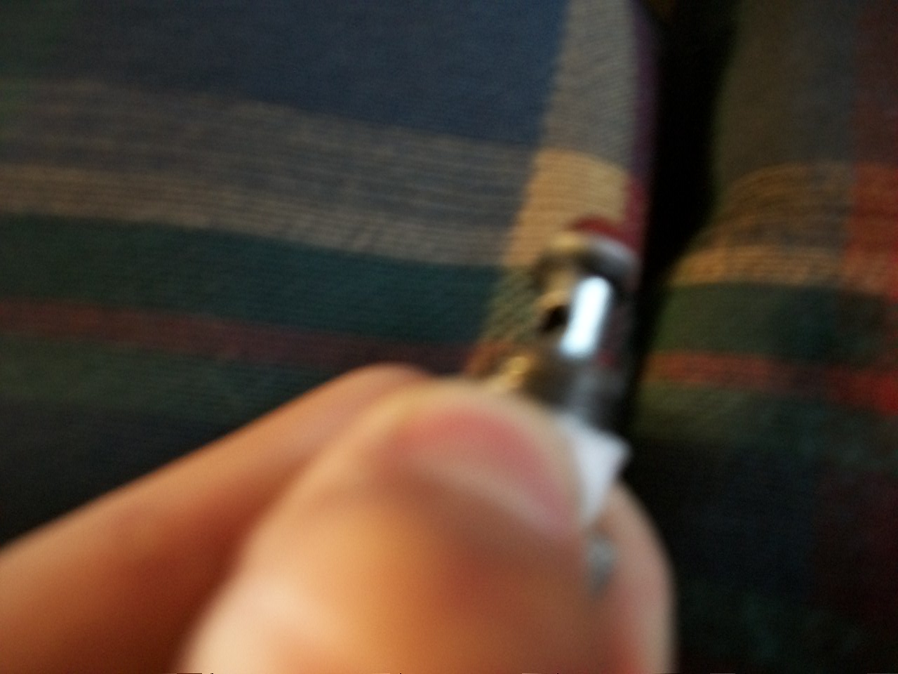

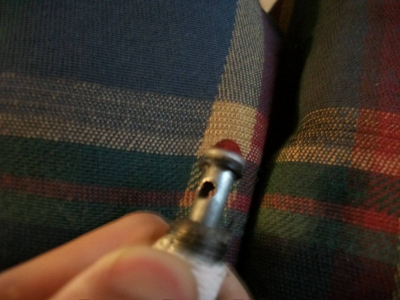

Ill take a picture of the internals in a minute. I got the leaks fixed by adding another oring.
