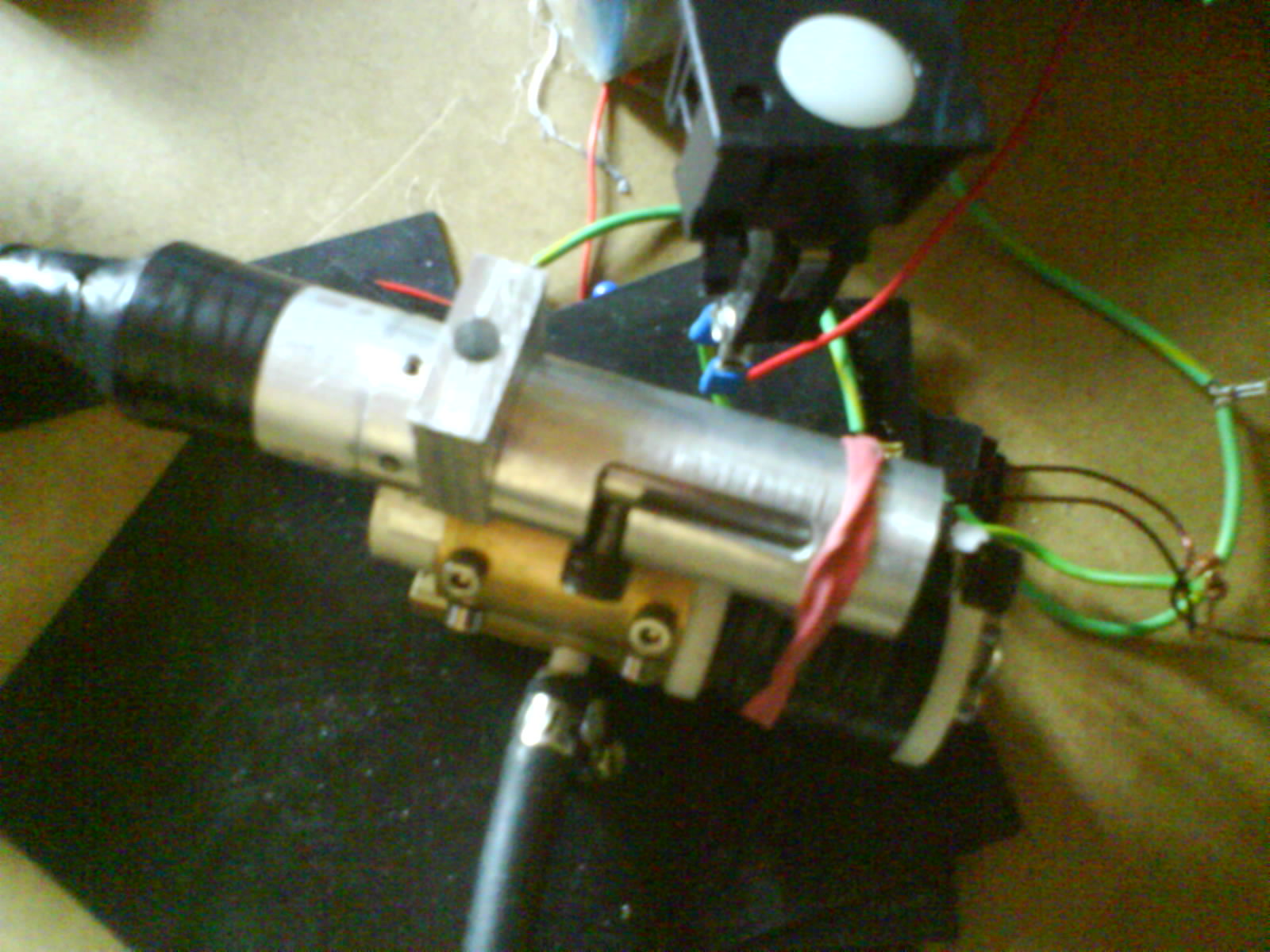

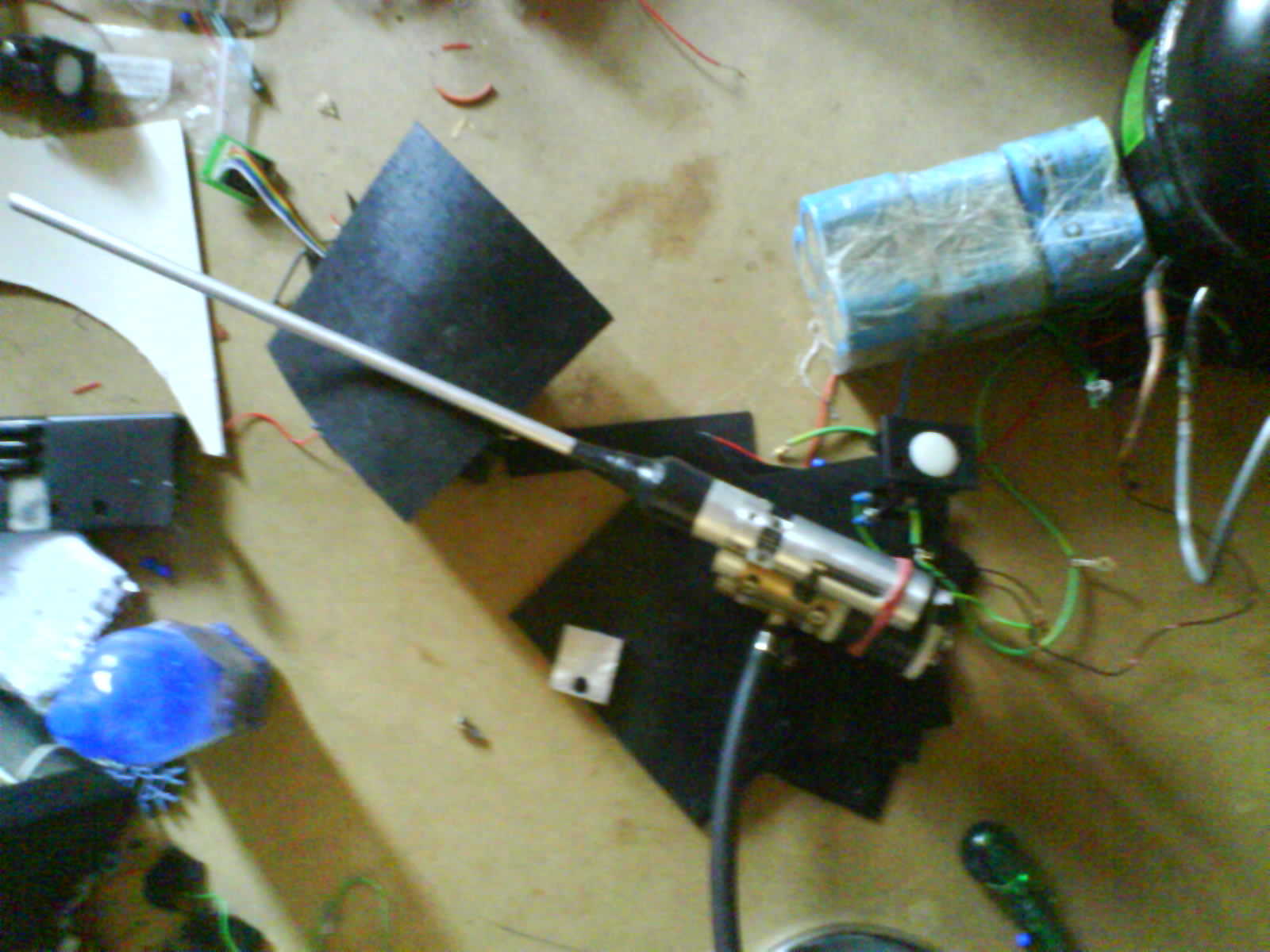

Picture 511 shows the whole of my setup.

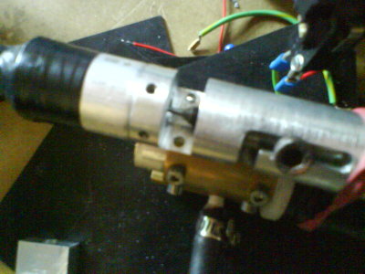

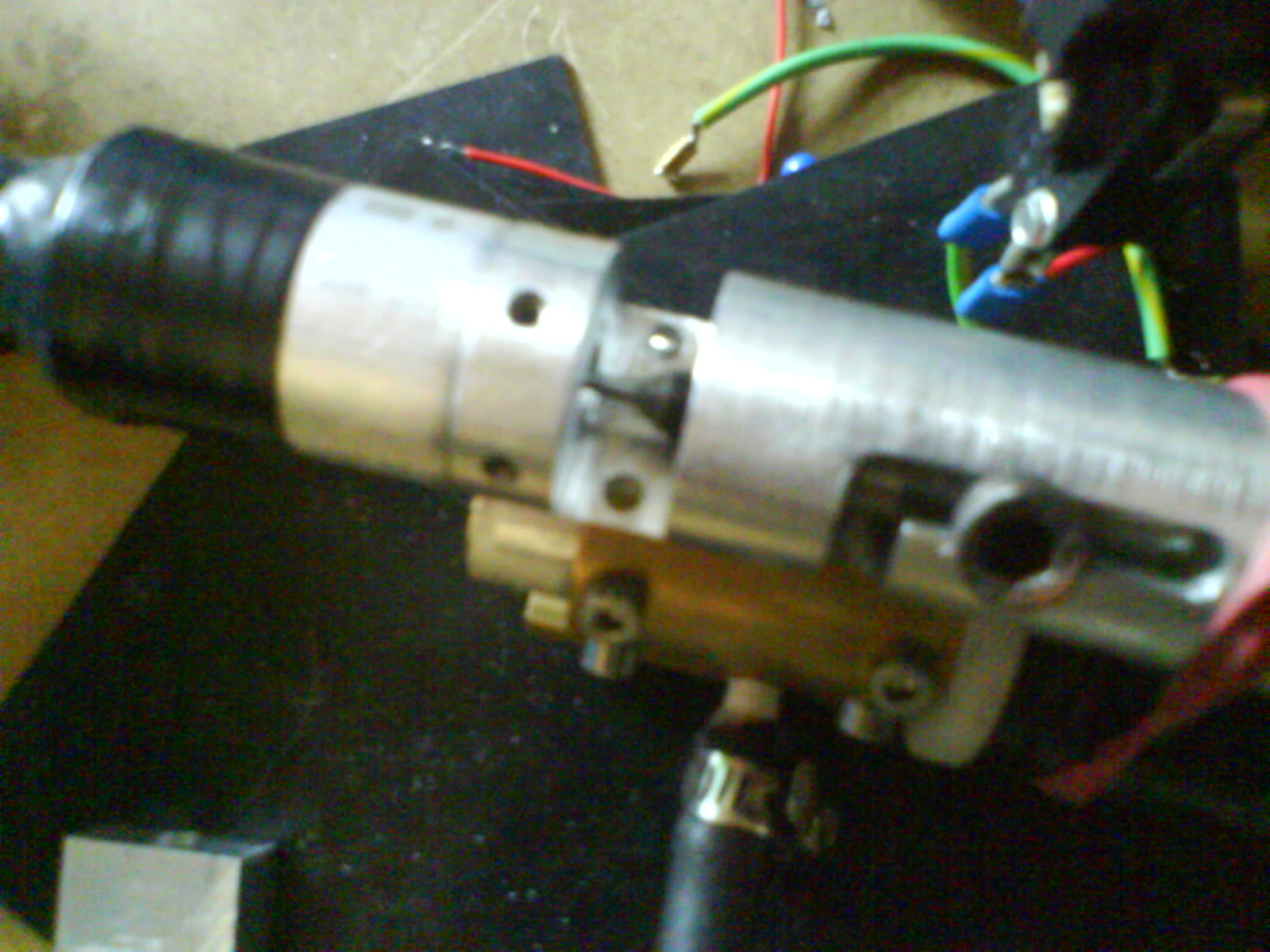

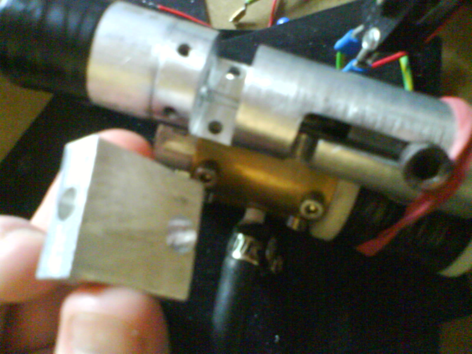

Picture 507 shows my valve and my bolt-action setup, I have inserted the magazine - my problem is that this simple magazine feeds about 3bb's into the barell - I need just one. Any suggestions of magazines that feed just one bb at a time - im trying to avoid using any more solenoids.
508 shows magazine removed - it is 10mm wide.

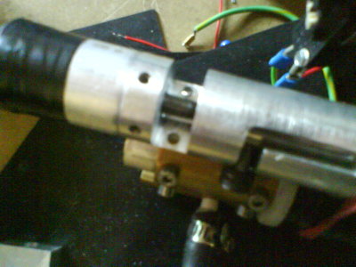

509 shows what pushes the bb's into the barell

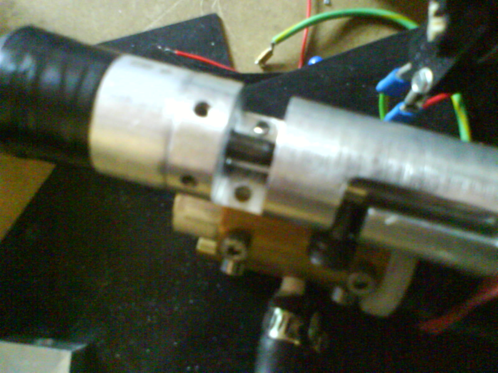

510 shows the bolt-action locked
The magazine needs to have a 8mm hole for the bolt-action plunger to be able to clear it, any smaller and I may wear the seal out fast.

That looks really nice. What is it powered by? I'm guessing pneumatic because you said valve but I wasn't sure. Is the capacitor bank for opening the valve?

Yes the bank is for operating the valve, http://www.youtube.com/watch?v=2TGLXjDSQ9s this is my fist attempt - results werent too amazing but its a new type of valve that has never been done before.
And yes it is pneumatic, not sure what pressure though because my gauge is knackered (I think about 200psi).

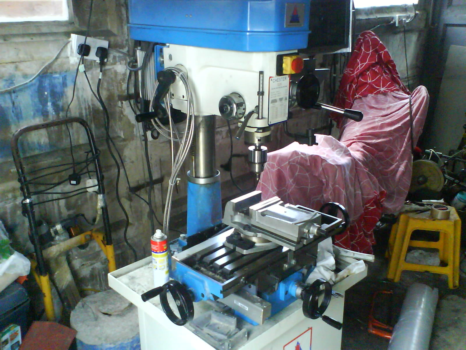

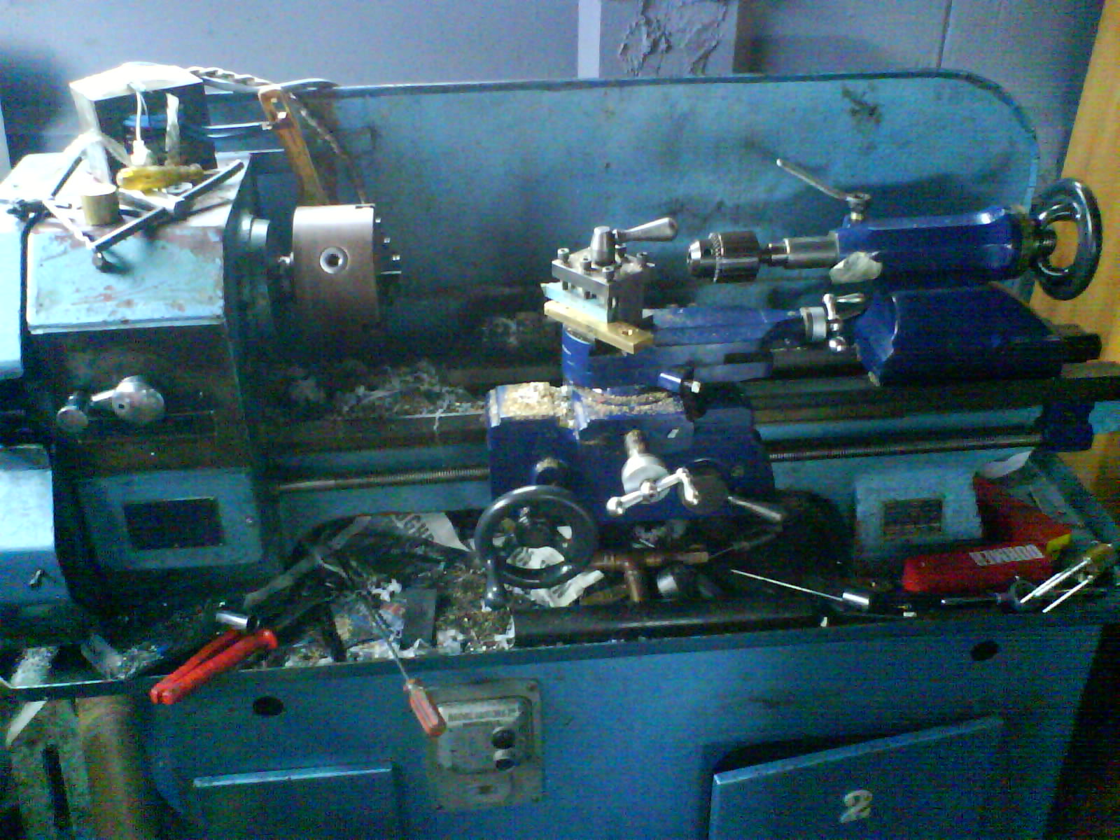

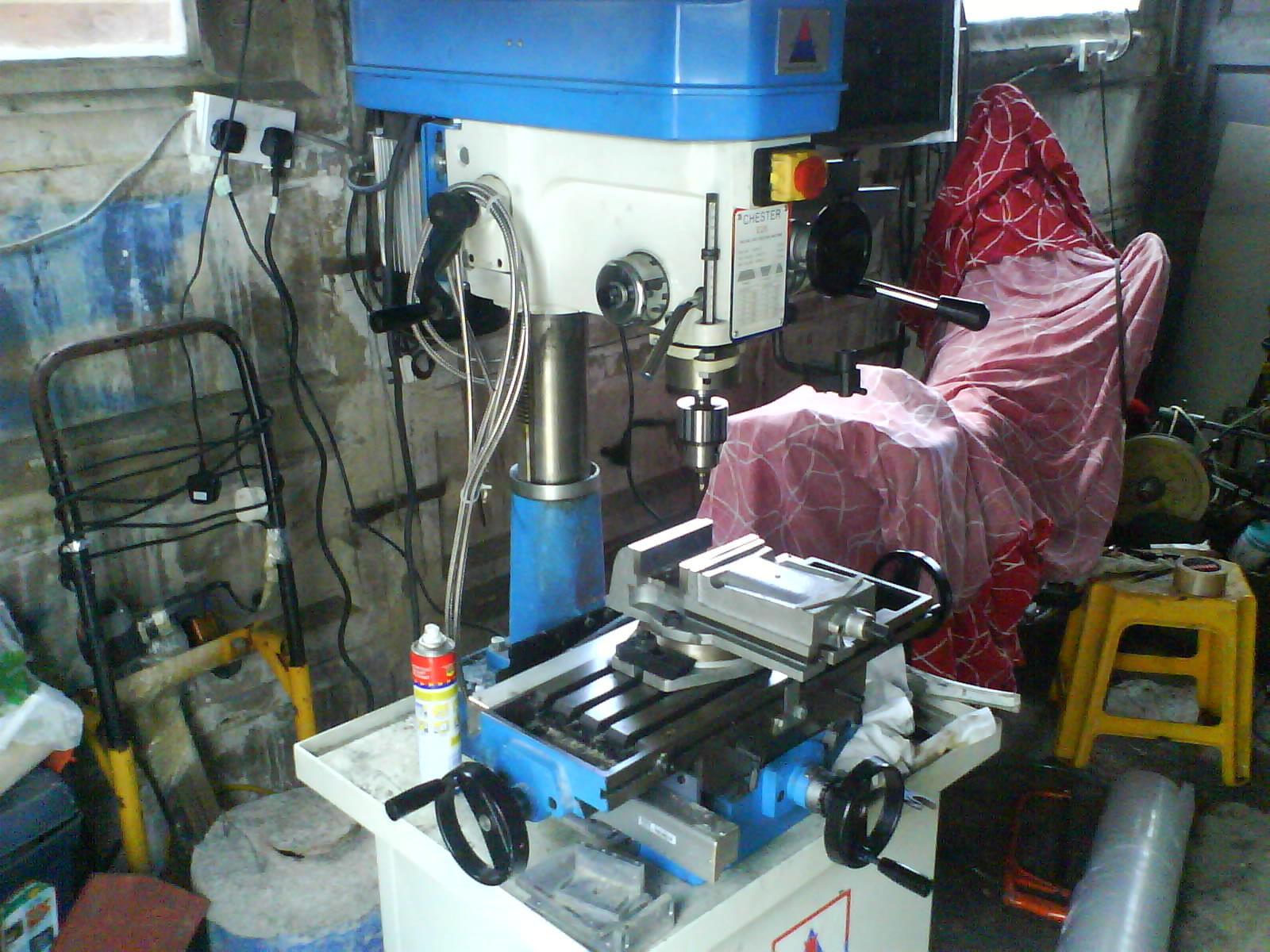

I have a lathe and a milling machine, the only thing I truly designed was the valve, the bolt-action was a bit of trial and error.
Im 17, and saved all my money for a milling machine, bought a motorbike instead and then got given a brand new milling machine by someone who happened to see the lathe in my garage - he simple came up to me and said "do you want a milling machine". I would have never been able to do anything like this without one.

I had the same impression, I thought he was joking, then I realised he was serious I thought it would be a crappy machine.
He showed me around his company, showed me the machine I was getting and promised me a job after I have finished college. He owns a business making industrial seals so I suppose he can just throw money away.
I also got a load of tools with it - was the best day of my life

As to the magazine, have you though of fitting an o-ring to the port to keep BBs from spilling out on their own accord as soon as the bolt is retracted?

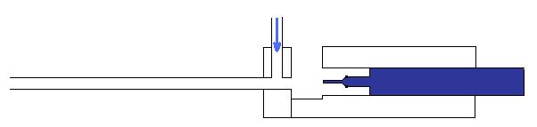

Finally the magazine
Im not quite sure how I would do that, could you give me some kind of diagram to what you are thinking.
The diagram attatched is basically my bolt-action setup. The port where the plunger goes is 6.8mm and the o-ring on the plunger is 7-7.5mm, edit this diagram to what you are suggesting.
The blue arrow is air
The magazine slot is 10mm
Thanks
Thanks
