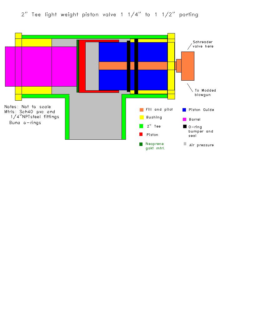

A good thing to start with is... a plan.
Know the parts, in general, you need, measure them accurately, and draw up a plan to scale to sort things out and optimize distances/sizes/etc.
I used this method to make a compact 1-1/2" porting valve a while ago...
Image Link
Didn't use the exact specs, but the dimensions are the same as in the drawing (1 pixel equals 0.01").
A good plan is key.
EDIT: adding to Crowley's post, the plug in the image I linked to sealed fine with the gasket method described (the orange disks are silicone rubber).
A heavy weight is placed on the plug during construction before drilling and tapping the holes for the bolts to hold the plug in. This way, the gasket is compressed when the plug is bolted in.
Image Link
A good plan is key.

The only thing i'm having a real problem w/ is the front part w/ a threaded adaptor. As for the back plug, i might just manage an o-ring seal w/ my drill, but could you elaborate on this gasket method please I'm really confused

If you'll look at the drawing, you'll see there are two bushings inside of the front of the tee. Both are cut down to fit into the same socket. One is threaded, the other is not.
EDIT: also, the back of the rear (slip) bushing is sanded down to fit into the interior of the tee to allow more area to bond to the piece of pipe the piston seals against. You may or may not have to do this for your valve.
EDIT II: Here's a link to an old thread I made while compacting a1-1/2" porting piston valve. Notice it doesn't use the newer design.

Thank you for your help, This weekend i will head to homedepot to purchase the parts, i will probably just go with an o-ring seal on the back plug, but i'll but a few for experimentation. Completion may be delayed abit because I am building an airsoft shotgun with my semi-auto system for a friend of mine.
Back to the valve, i will most likely use a cast hotglue piston, i will not add a peice of pipe in the tee as mark.f did, instead i shall have the barrel go much further back. I beleive this will eliminate most of the excess pilot volume almos to the point where i can pilot with a blowgun

1/4 the diameter applies where the air can enter the gap from all sides. In a T up to 2/3rds of the path is blocked by the body of the T. A larger opening will be required to keep the performance up.
It works well for coaxial designs. Even then I try to have the piston open at least 1/2 the piston valve seat diameter. I like the entrace to the barrel be the only notable restriction without a series second restriction of a small piston to valve seat gap.
