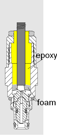

your gonna mod this for a piston valve, sweet,
maybe you can use all that space for epoxy to make sure that your pilot attachment thing holds,
however unless you can get a working rubber sealing face, the you'll probably need a significant pressure to get that to initially seal at lower pressures and the only way I'd imagine that happening is with a high breaking pressure check valve, or maybe you could get away with a strong piston reset spring and a check valve
wait I got it, you just want a valve that will operate as a semi auto so why not pneumatically adjust the spring tension see the diagram below, you should be able to make enough change in the spring tension to trigger the valve using a 3-way valve with low pressure air, this way you could also use a cheaper low pressure 3way valve to pilot the whole thing

- valve mod2.PNG (14.32 KiB) Viewed 3843 times
- valve mod.PNG (13.56 KiB) Viewed 3843 times
