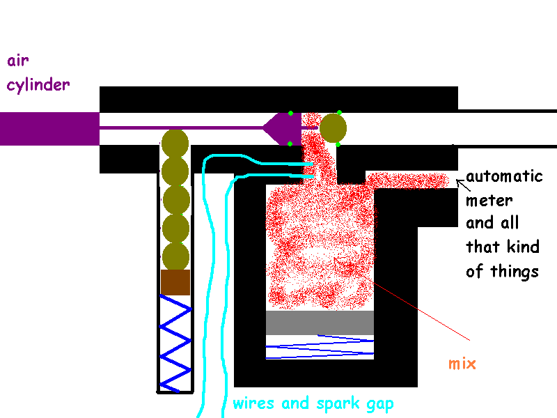

anyway this is what I have in mind... I could have used a simple piston valve but I decided to move this thing a step forward in terms of simplicity and use JSR's valveless idea
not everything is included in this pic.. I omitted all the valves, meter and circuitry needed for it to operate automatically.. it seems that it's a better idea than the valve + loading mech that I proposed earlier... mostly due to the fact that it would be easier to machine and can offer better performance... so it seems that I might abandon that project

- uhmm I hope you get it... there are no valves, meter and circuitry here... this shows only the most basic part of it... it could be either machined or built from standard fittings
how it works:
there is a spring loaded piston in the chamebr that vents the chamebr after each shot... as soon as the air cylinder retracts and loads new ammo into place the system is sealed (green in the pic is o-rings)... then the mix enters the chamber and forces the piston downward...
then the mix is ignited, ammo leaves the barrel and the piston is pushed upward exhausting spent gasses
the whole cycle starts from the very beginning - automated hybrid.PNG (32.78 KiB) Viewed 4823 times
If you increased the surface area of the purple part, could you simply have it retract during combustion and reset by a adjustable spring? Getting the BB tube 2-3 diameters stroke behind the loaded position, so the piston (purple one) doesn't have to move as far, faster ROF.
This looks like a very interesting build to me, I only see a few issues with it. One is just balancing the clip spring with the air cylinder with the firing pressure with the attachment force of an o-ring with the size of ammo to the o-ring. Such a build would probably require a LOT of trial and error. The only other issues that I can see with this is your reloading piston. Depending on the firing pressure (before and after combustion) you'll probably have a lot of issues with heat buildup, o-rings sealing, and your reloading piston staying together.
I do have one suggestion for improvements on this though. If you can find a way to fill the chamber quickly enough (and I do admit that springloaded chamber is brilliant) you might consider trying to run the ignition system through the sealing head on that spring, thus providing an easy fully-auto firing mechanism, and easily calculable.
Just one more thing that you've probably already thought of is a valve to protect your expensive metering system. Other than that, I love the design and look forward to something being built.
EDIT: It also looks to me like this would finally provide us with a high-power automatic, which would be freakin' awesome!

I am mostly worried about valveless part of this design...
but even if I had to use a piston valve this thing can be built... from my point of view it seems as an easier route that building a 3000psi pneumatic
lol maybe becasue I've never built a hybrid before... I guess I would have to build some basic hybrids first
If I remember correctly others have been come up with the same idea too... if you think of it it is the simplest way to vent the chamberand I do admit that springloaded chamber is brilliant

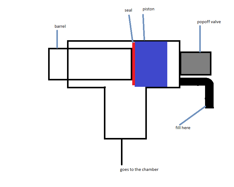

Here is an idea to poke at...
how about a standard barrel sealing piston valve that is piloted with a pop-off valve.
here is my idea of how things may work.
at the moment of ignition the pressure in the chamber increases forcing the piston to move back this will compress the pilot volume and thus will the pressure rise causing the pop-off to vent and the piston valve to open
this is just an idea that I just dreamed up maybe you guys can poke a few holes in it cause I really did not put much thought into this.
- piston valve utilizing a popoff to vent
- consept.png (12.52 KiB) Viewed 4758 times
The voices in my head may not be real, but they have some good ideas!
no, what I am suggesting is to use the regular pneumatic piston valve for a hybrid but use a pop-off to pilot it, cause I think the ignition will cause the piston to move back compressing the pilot volume and that will cause the pop-off to vent the pilot volume this will be a a type of piston hybrid . Have you read my previous post at all or are you guilty of ignoring text and skipping to picssaefroch wrote:This is a pneumatic, correct? Aren't we discussing a hybrid design?
