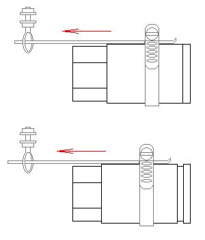

I think that it'd make an excellent "ghetto-style" trigger, for a howitzer-design cannon... The Female Quick-Disconnect would be attached, via a hose clamp and some thin aircraft cable, to make an effective lanyard.
The user faces away from "downrange" and places the lanyard against their outside hip. You simply twist your hip, to fire.
Or, have the FQD facing forward and rigged so that the user pulls it from the rear, to disconnect.
