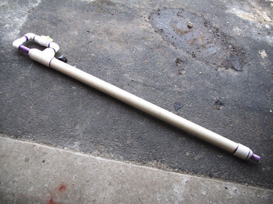

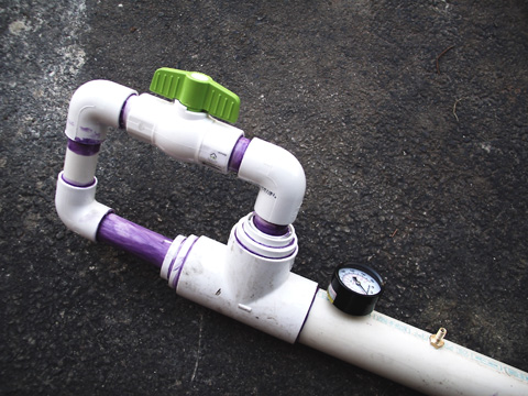

I am a new member here and after looking around for a couple of days I found this post http://www.spudfiles.com/forums/viewtop ... tml#282119 which was a question about a design for a coax cannon. I have made simple combustion cannons in the past but wasn't really familiar with the other types of cannons before looking through this forum. I decided that the design didn't seem to difficult after looking over the plans and drew out a simple plan for it and began my creation.
Dimensions:
2inx4ft chamber
1inx5ft barrel
I used these pipes because I had them as left overs from some other projects.
I have pressure tested it up to 140psi which is as high as my compressor will go (don't want to go much higher anyway, gauge only goes to 160psi)and I can't hear any leaks. I used thread tape on the gauge and shrader valve to get a good seal. Now all I need to do is give it some color.
I am taking suggestions for color schemes or designs because I have no idea what to do on this thing. I think for my first coax pneumatic it isn't bad.
I do need help with one thing though. I wanted to put it in GGDT but wasn't sure how to set it up. Can somebody help me with the numbers for GGDT? And I would love to test this out but I live in the suburbs and my neighbors might get mad if I start shooting things around my yard, but I'll do it anyway after I come up with some nice ammo for it.

Looks ok, but is it servicible, and it looks like it has some dead space like pointed out in the original topic, as for the paint how about camo or flat black, any chance of a video

isn't it is just a ball valve cannon with the barrel inside the chamber? not a piston valve? yeah also the dead space was pointed out in the other thread, did you even read it drako? it has a negative effect, but probably not that noticeable. nice cannon. will look nice with a paint job.

Yup, no piston valve here folks. Chamber is pretty damn huge, cut it in half but leave the barrel at the same length. Aside from that, not a bad build.

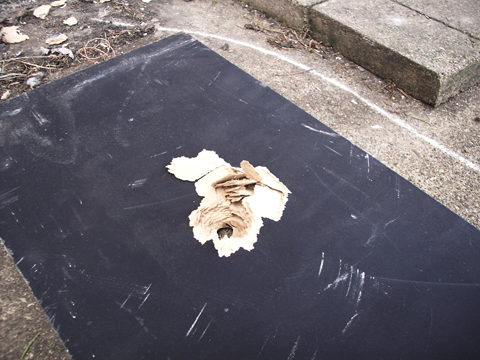

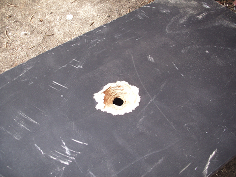

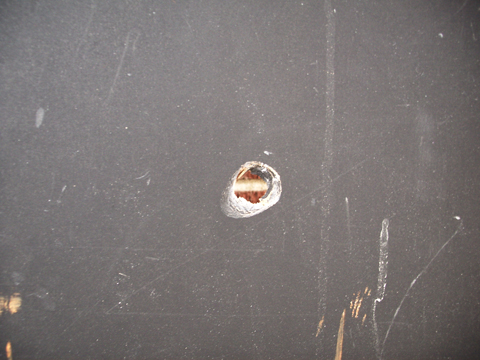

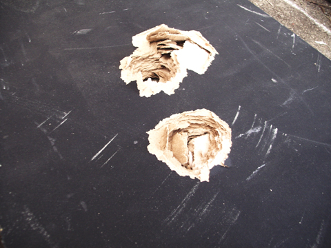

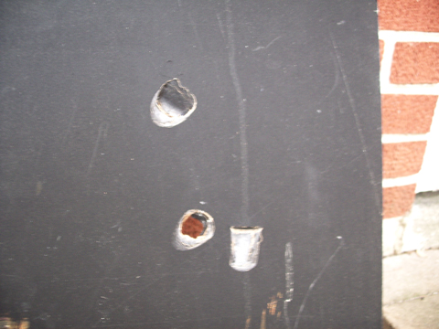

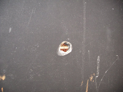

Here are some damage shots and picture of the paint scheme. I was shooting at 3/4 inch MDF because that is what I had laying around. I took three consecutive shots without having to make new ammo. It didn't do as good of damage as I had hoped but I was using air compressor pressure so it was only at 120-130psi.

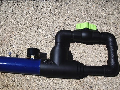

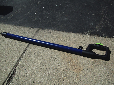

paint scheme. went with flat back and blue because I had the colors in the garage.
paint close up
paint close up
first shot front damage
first shot rear damage
second shot rear damage.
front damage third shot is upper damage. second shot is lower right. sorry about the focus, my camera didn't like this picture
final rear damage
final rear damage

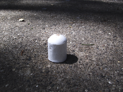

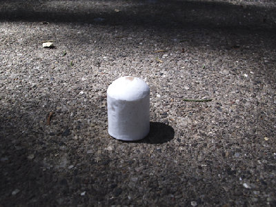

Ammo still good. Made from white casting resin. apparently indestructible.

Only 130? Dont go higher than that with pvc, nice paint scheme though.
