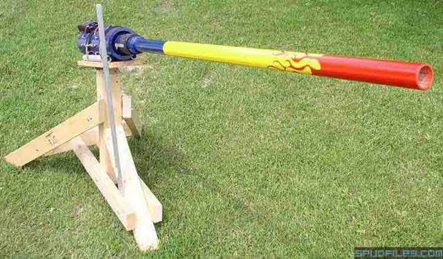

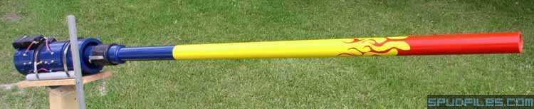

This cannon is called Quadzilla because comes from the fact that there are 4 sparks inside the chamber that spark simultaneously from a 200,00V stun gun system, and all of the electrodes are stainless steel. This chamber includes a fan to help the fuel mixing and exhausting gasses. It is a breechloader that uses cam lever couplings in the breech loading system. There is no on-board propane meter, so the overall weight of the cannon is fairly light. This cannon also has a stand, as you can see in the pictures, which allows for persists changes when shooting for distance.
This cannon was also painted with <a href="http://www.krylon.com/product/gp_produc ... 07">Krylon Fusion</a> paint which is the perfect choice for all plastic spud cannons. There are multiple barrel attachments too, like a Breech Loadable Rifled 1.5" SCH 40, Breech Loadable Smoothbore 1.5" SCH 40, Sleeved Golf Ball Barrel, and 2.5" SCH 40 Tennis ball barrel. This gun can also use the burst disk attachment and its various size barrels. Quadzilla will soon be getting a 3" barrel for pop cans/bottles and a 2" barrel for limes and large spuds.

Real nice Paint job, as Fred said I love the flames also

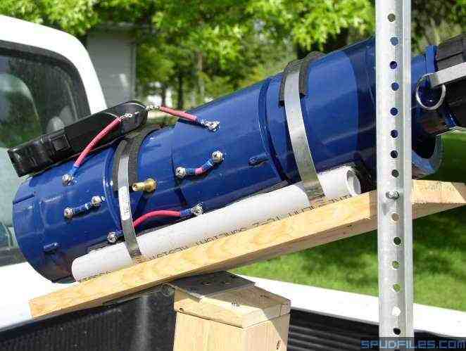

Nice stun gun, screw placement.
Cool Cam fittings

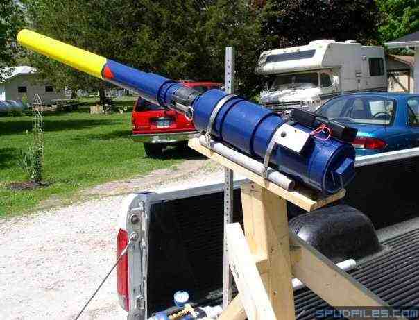

hey boogieman i like what i see!! could u tell me the size of ur combustion chamber on quadzilla?that would be great
- boilingleadbath
- Staff Sergeant 2
- Posts: 1635
- Location: Pennsylvania, USA
It looks like maybe 4" wide and 18-20" long.

whith the converter in the middle of the combustion chamber is that glued down and what is it used for
- boilingleadbath
- Staff Sergeant 2
- Posts: 1635
The COUPLER is there so he can put the bolts through a double thickness of pipe. (ok, the coupler's a fitting, not a pipe, but whatever) This is recomended, as it lowers the chance of the electrode coming out or the pipe failing.

yeah but would u glue the coupler down or would the screws hold it down
, incase ur wondering im kinda knew to the spud gun scene

All pipe and pipe fittings are put together by using primer and cement. In the Quadzilla his method of ignition required him to put screws through the chamber that would carry an electric current and provide a spark inside the chamber.
Since putting any kind of hole in your chamber isn't a good idea, he decided to use couplers to ensure that where he needed to make a hole and put a screw, the PVC would be twice as thick for added safety (pipe slides inside of couplers and is glued there, making parts of the piece twice as thick).

how did u wire quadzilla
its not how u showed to wire 4 sparks on ur website
