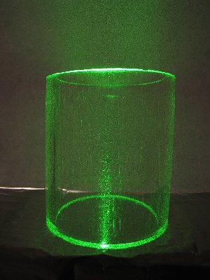

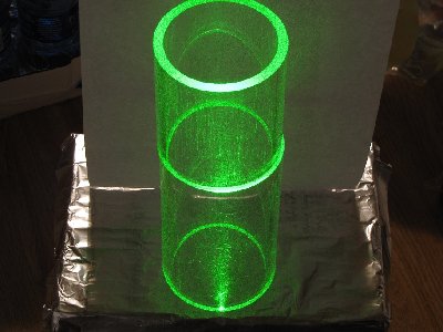

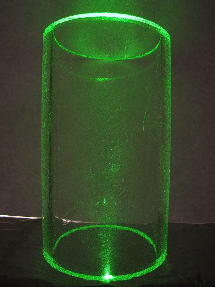

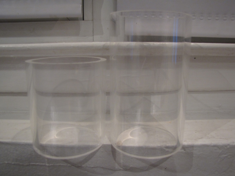

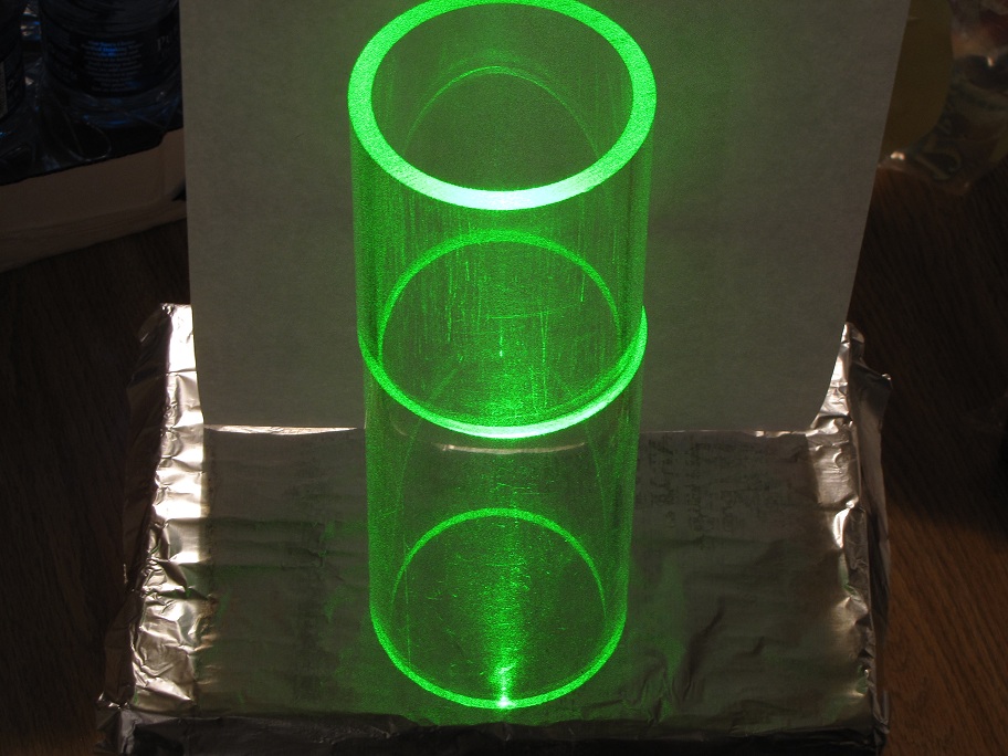

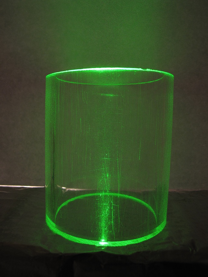

So I found some clear PVC in my university's machine shop and then I saw another and thought, "If they were only longer I could make a combustion cannon." So I want to glue them if at all possible. Can anyone reccomend an adhesive?

I would suggest gluing the joint, as well as making a bracket that would hold the completed chamber together with a compressive force similar to that achieved with a basic C clamp.
If I were in your situation, I would do the above, as well as strengthen the glued joint with a coupling of some sort.

Well after a little math, assuming combustion is equivalent to 100 psi, There would be 678 lbs of force or 238 psi of pressure on the glue. Would you let super glue support that?Hubb wrote:How about super glue? It should support a basic combustion launcher.
I want to keep a clean look, a brace would be sloppy looking.Gaderelguitarist wrote:I would suggest gluing the joint, as well as making a bracket that would hold the completed chamber together with a compressive force similar to that achieved with a basic C clamp.
EDIT: I find that super glue (Cyanoacrilate) has a shear strength of 1000 PSI. This gives me a safety factor of 4.169. Is this good enough for spudfiles?

Make sure you know for sure what that clear plastic is made of. If it is PVC, then PVC glue and joints can be used. If it is polycarbonate, superglue might not bond to it. Test a small drop of superglue on an end that will be covered by a fitting. After it is set, see if you can peel the glue off. If you can peel the glue off, then don't use that glue.
PVC cement on poly tubing will dry and can be easily peeled off. PVC cement on PVC pipe will soften and bond to the PVC.
I do not recommend using plexiglass for a combustion cannon. It is brittle and will craze and crack with stress leading to shrapnel when it fails. Plexiglass is solvent welded with a compatible solvent glue.

Just use a coupler.
That is.... if it is truly pvc.
One strip of white (or other color) could actually look really good.
Better yet, use a T and then use it to hide your spark plug... and wire.

on a side note since no one has said this... all the clear pvc that i have ever seen had a bluish tint to it. that doesn't appear to, so how sure are you that it is in fact pvc? also if it is, does it have any marking to describe pressure rating?
