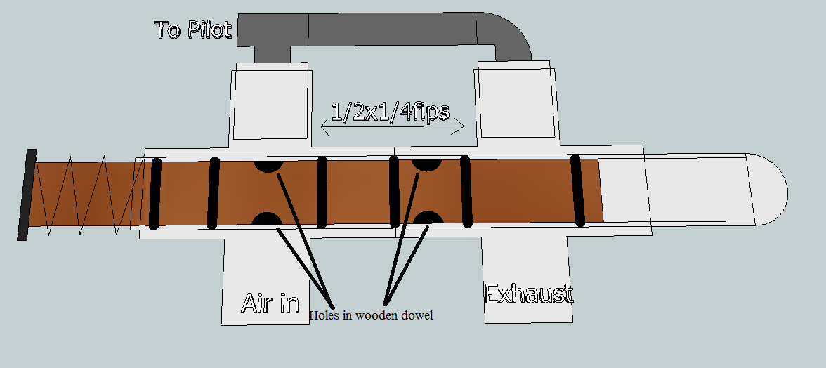

I drew this up today... Might make one just because I can't get any DVC's around here. I already know the pilot volume would be kinda big, but that's why I reduced it to 1/4". Discuss.
EDIT: Sorry I forgot to draw an o-ring on the far left side so when it is pressed no air from the compressor gets in. Updated the drawing.

there are other ways. this one reduces part count, ports, and pilot volume.
yes, the drawing was done in paint in around 30 seconds.

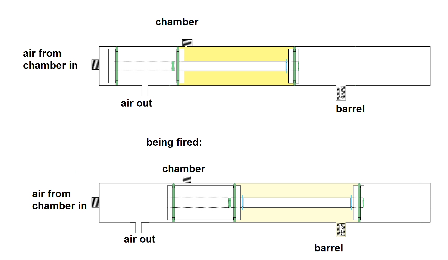

I think it would be easier to build an unbalanced valve, like this one -> http://www.spudfiles.com/forums/5-qev-a ... 20674.html

well you can build a simple DCV like the one in iknowmy3tables' post from a 1/4" T (preferably one with male threads)
make sure that the inside of it is perfectly smooth... then get a bolt or threaded rod, a couple of washers and an o-ring to build the part that slides in it... then add a couple of fittings and that's it
I've never built one but it's an interesting design as it has some advantages that I listed in the thread
the biggest disadvantage is that fact that it it's not balanced but you can always find a way to overcome this problem (like using a lever)

In the original drawing, it is assumed the air can only cross through the holes in the dowel. This incorrect. Without a seal between the source and chamber, that path will leak past. Same is true for the chamber to the exhaust. A dowel does not make a ball valve seal between both sides.
ramses is close, but needs the exhaust port moved over to one end. The ports in the dowell need lengthened so in one position the inlet to pilot are connected in the middle the pilot is sealed, and at the other end the pilot is vented to exhaust.
Poland spud needs to look at the force on the end of the spool from the source air. You have to push against the source air to fire it. A mechanical failure will launch the spool out. Designs with not pressure on the ends of the spool work the easiest unless the pressure on the end of the spool to cause rapid motion is desired such as the QDV. Having a mechanical stop on the design would work nice as the valve would remain on supply air until forced to fire. The force on the spool would limit the size to lower pressures and smaller diameters.
The design for Spudtech's propane meter would be perfect. Inlet on one end, exhaust on the other and pilot in the middle. Somewhere in the forum is a drawing of that meter. It moves easily and would do the job with the center tapped to the pilot and the overall length shortened to reduce pilot volume.
EDIT; Dug and found the drawing. Fuel would be air supply, chamber would be exhaust, and the center would have a port to the pilot. Meter volume can be drastically reduced.

yeah I know but this is the simplest design I can think of... and, as I pointed out myself, it is unbalanced (which has some advantages)
this thing can be built without using any tools... but it goes without saying that in case you have access to machining (though I guess that even a powerful drill press would do) you can directly copy the design used in most commercial DCVs

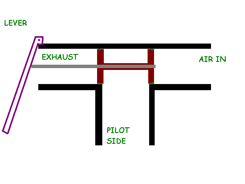

I just drew up a picture very similar to that, but mine only had 3 o-rings, greatest thing about it: it can be semi-auto!Technician1002 wrote:

Tech, I fail to see how that design would work... as the connection to the air is cut off when the spool is pushed forward. Or am I missing somehing? And Poland, you design seems very prectical... I couldn't find the thread on it though.

the thing that technician has posted is a meter... you can put a port in the middle and what you'd get would be pretty much what commercial spool valves look like...
in that particular design there is no 'middle' port as the guy didn't need it (the volume between the two pistons/seals/whateveryoucallthosetworectangualrthings is the metered volume)

sorry I could have posted a pic showing what typical spool valves look like in my first post but I assumed you've seen them earlier... lots of people post them and you can see it in the animation I posted in the thread on the semiauto MKIII and on DCVs... ohh BTW you can also find a few pics in some of the links posted there
ohh and you don't need 3 o-rings... two would be enough... and yes you are right you could use that thing as both the pilot valve and the main valve at the same time
However, the most important thing if you want to use a 3 way as teh main valve is to ensure that the valve opens fast enough... most indirect acting valves open relatively fast, as they have a smaller inbuilt piloting valve that switches the spool...
You can also design a valve that would be balanced in one position but as it begins to move it becomes unbalanced and speeds up its own opening... damn I know it's damn hard to understand this without a pic but it is a fairly simple concept
