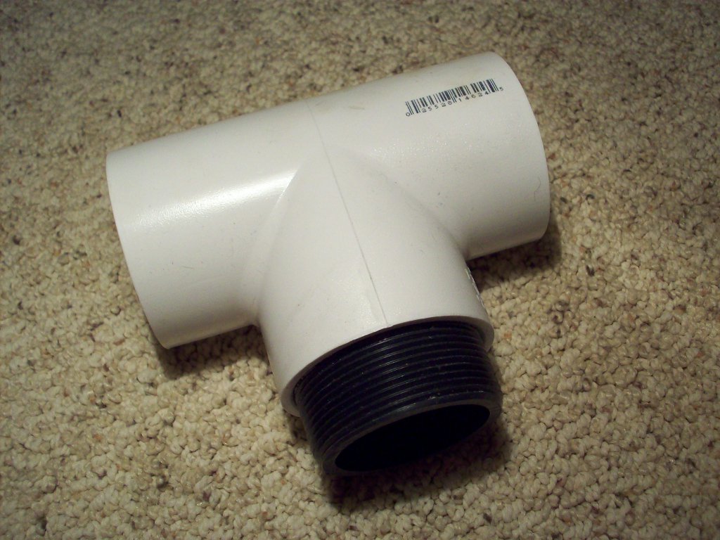

I'm building a 2" Tee piston valve for a golf ball gun. I want to put a bushing on the bottom port of the tee to make it detachable incase I want to take it off for any reason. But it will have a 2" chamber, so the smaller hole leading to the barrel through the bushing, will that limit power? And what would be the easy solution?

Threaded Tee, I think I saw some with only the bottom port threaded

Yeah I was thinking of that... Good idea. Slip by thread tee should work. My bad...

Ehh yeah I wouldn't do that because the design is similar to yours, with the stock, so it would be really awkward with that sticking off the bottom.

I'd say to make the chamber porting (bushing) the same or greater size than your barrel port, and you'll be fine.
If you want to use a 2" threaded connection, though, find a 2xn" SCH-80 PVC threaded nipple, and cut past one set of threads the same socket depth as the bottom of the tee. This makes for a compact male connector, but you may have trouble finding the right nipple. I have to drive about 45 minutes to buy mine.

Those fittings are actually pretty difficult to find for one, you won't find them at your average hardware store like home depot(why do you think he sells them?), and secondly, for the problem MR.C described it would reduce the length between the chamber and barrel thus making a more appealing cannon.Gun Freak wrote:Or not.

Yeah that is true but here is a site that has them for 3.50 in 2" and 1.50 for 1.5", the prices here a great.

Jsr basically that's a large nipple correct? If you want gun freak all you have to do is buy some o rings and some machine screws and you can attach it however you want.

Mark, thanks, I think its easier to get a threaded tee though.
