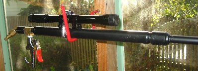

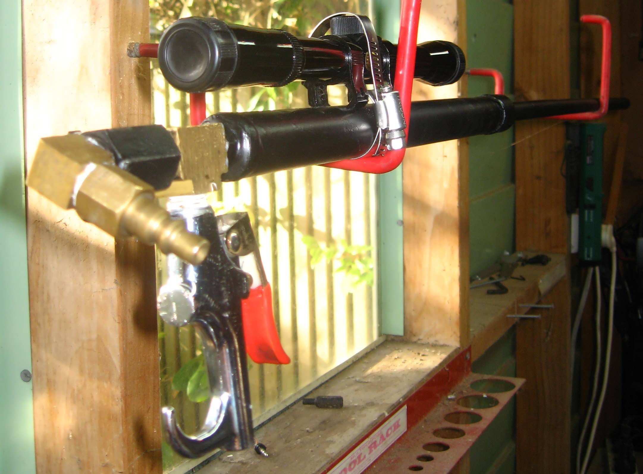

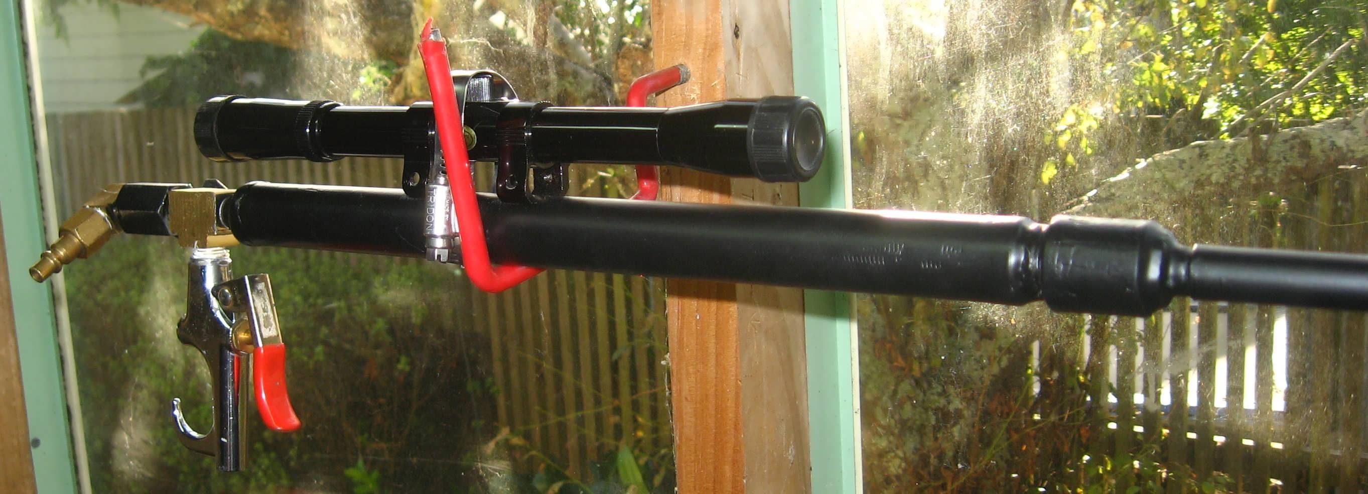

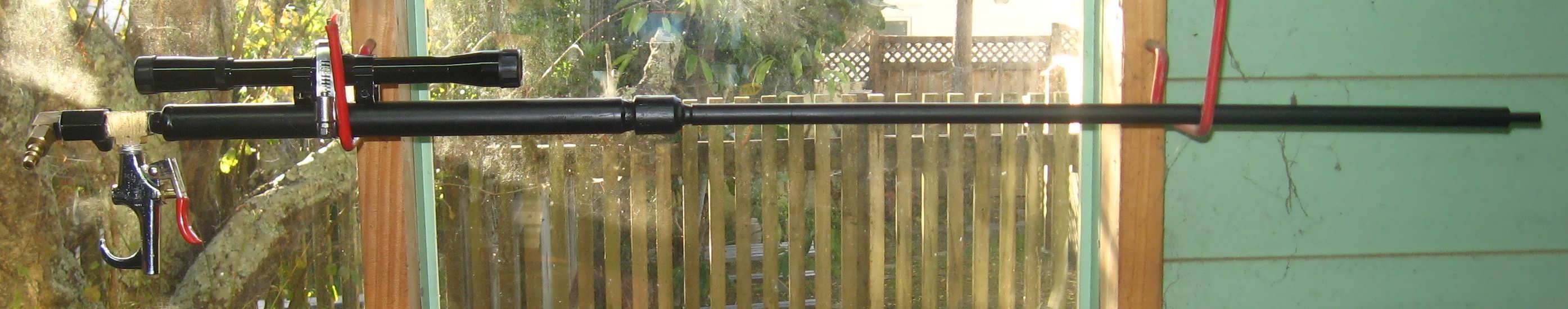

Nothing special here really. Just an upgrade on my previous 6mm coaxial. Added a 100cm long brass 6mm barrel, perfect for BBs. Painted black, was previously silver/grey. Everything else is pretty much the same, the only difference is that I can swap out the barrels on this one for when I buy a new length of 8mm brass tube for some ball bearings I have. 6mm barrel has a 10mm copper surround to protect it from getting bent.
Will take it up to 500PSI once I get my fridge compressor finished. In the mean time I take it up to 300PSI with my track pump. Performance is far greater than the previous version (which only had a 20cm barrel).
Anyway, picture time.

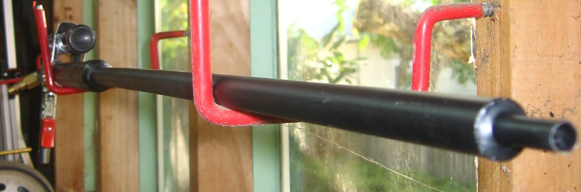

Not sure why the barrel surround looks bent. It's straight as an arrow.

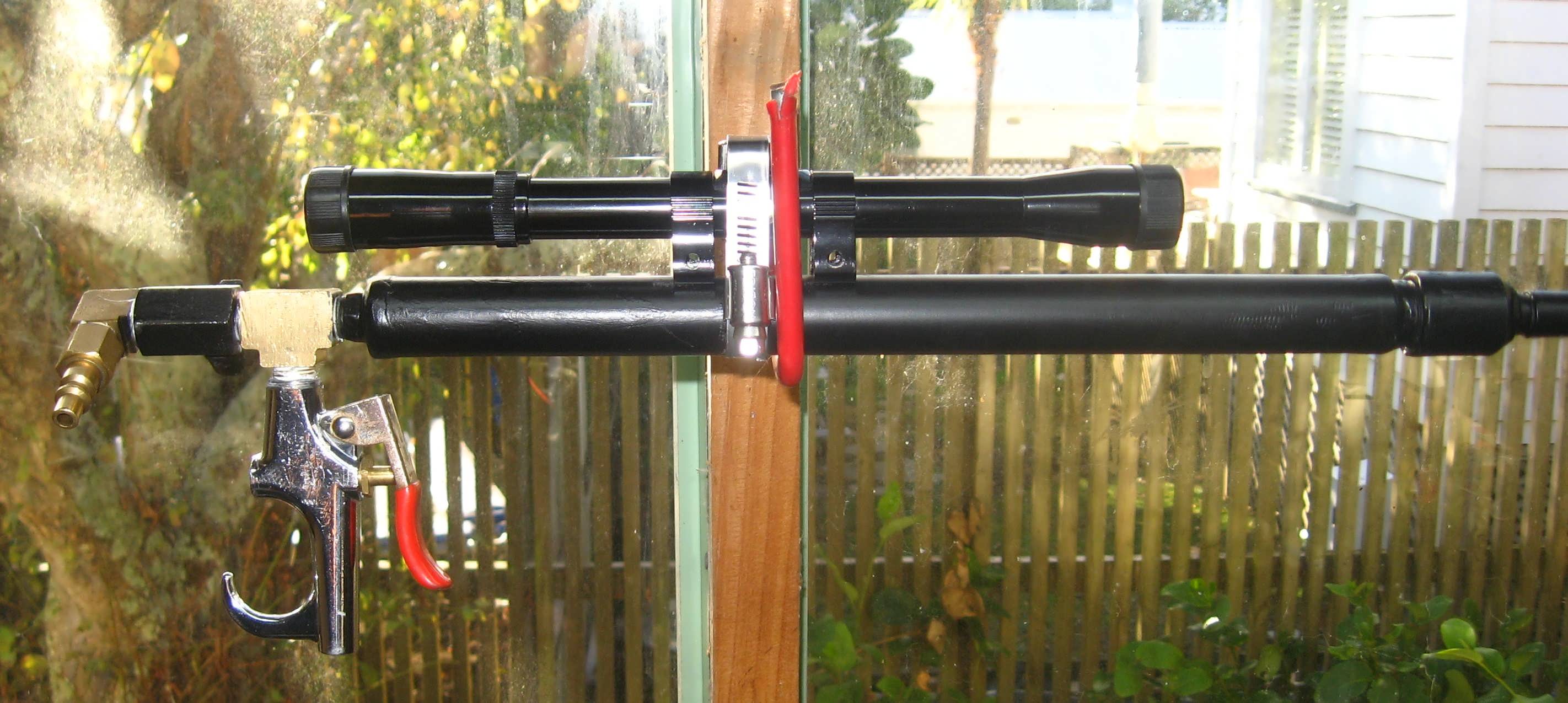

A suggestion...make a dovetail from a piece of flat steel by beveling the edges with a file.
Epoxy it on...thus eliminating the hose clamp, and providing a more secure and consistant mount for the scope.

any way looks awesome! i like flat black, gives it a nice clean look... how ever you didnt paint the blow gun?? CBF, or is there another reason
I've never painted a blowgun before. I might do it, just for the hell of it, otherwise i'll just polish it a little bit to get rid of scuff marks. The blowgun is modded by the way, performance was only a little bit less than the push button valve and the push button valve ended up having seating issues at 300PSI.

I'm assuming you used the same valve design as the previous one mentioned
Yeah, can't even remember what the piston is made from but it looks like a piece of wooden dowel that had (for some reason) a hole through the middle of it because it looks like i've filled it with bondo. There's an o-ring also.
Guess I could. Still have to attach the dovetail with epoxy like you said. I'll give it a ago, got a free afternoon today.
