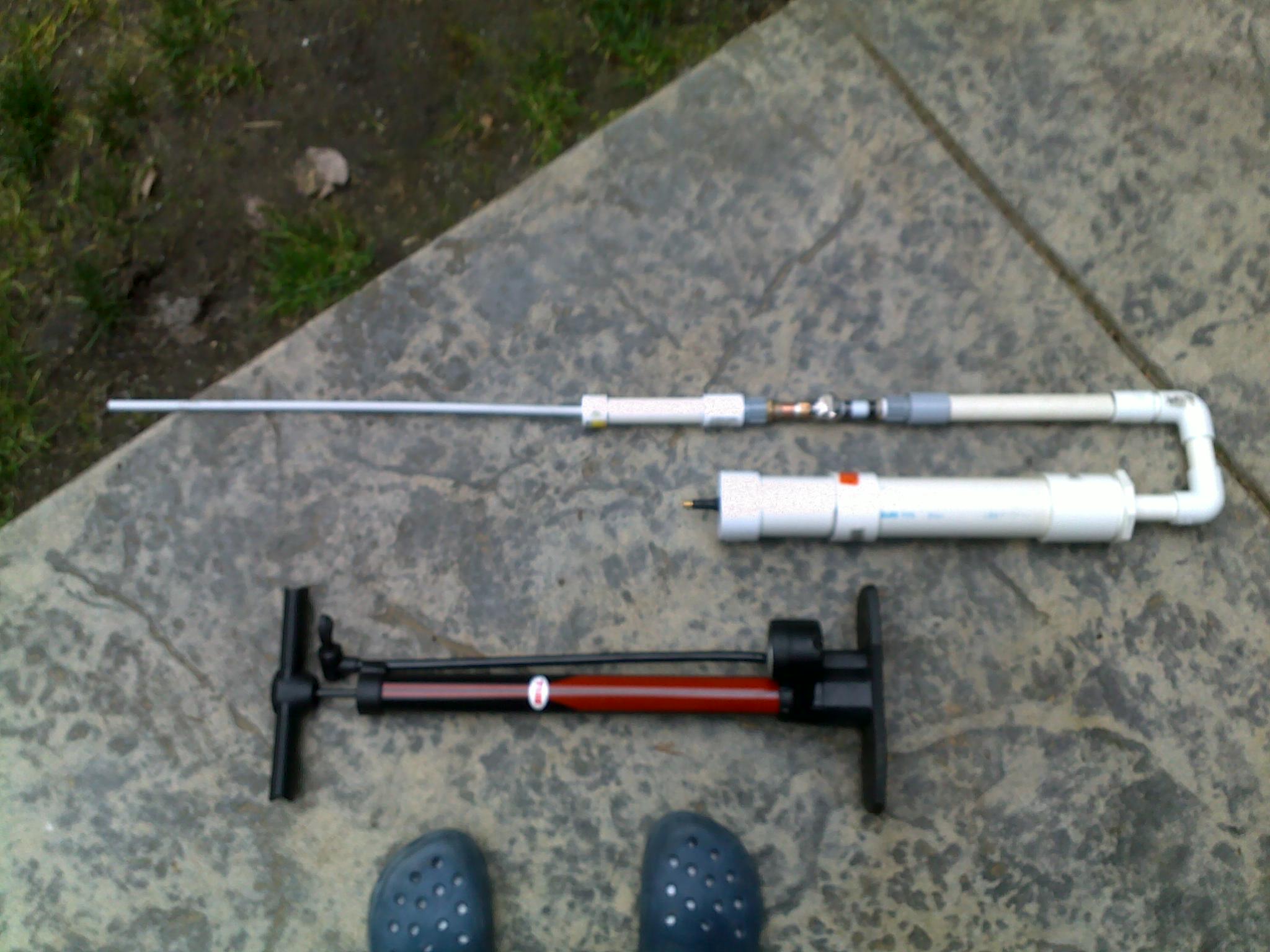

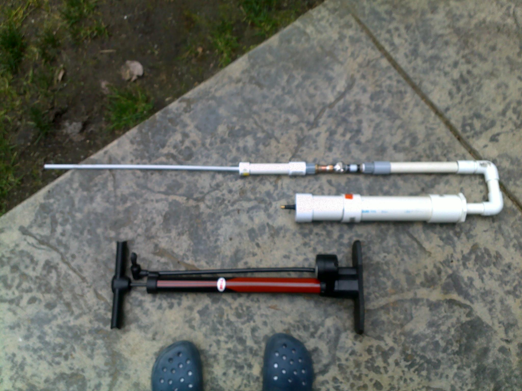

for my barrel i just used some connector rod for toilets (really cheap
) and a ¼ inch BV
im so cheap 8)
