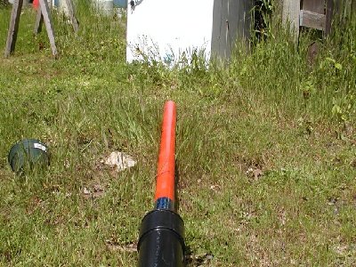

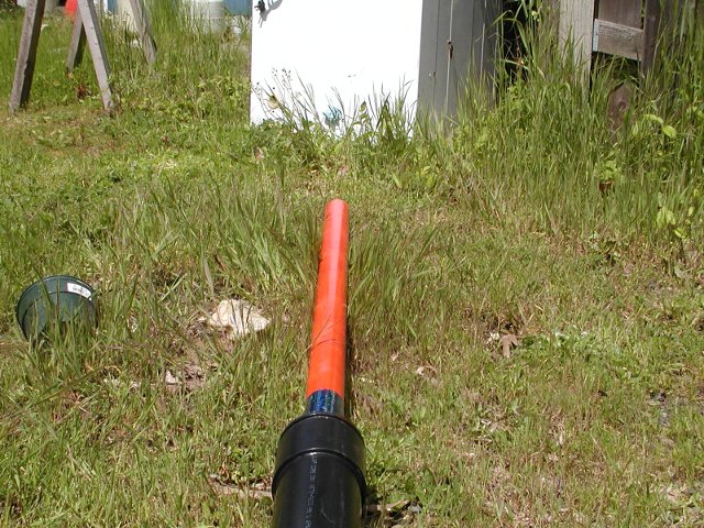

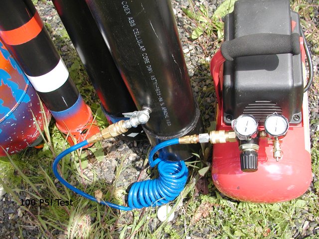

I annually test an ABS Cellular Core cannon to over 90 PSI every year and have had no failures. Your results may vary. I still need to do this year's test. I'll post the results later.
My personal results are here. The pressure tests are at typical spray and pray spudguns. Do not use exotic fuel such as welding gas or add pure oxygen.
http://www.spudfiles.com/forums/abs-cel ... 17968.html
This test is for ABS only. This does not apply to cell foam PVC.

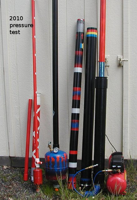

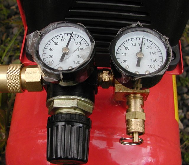

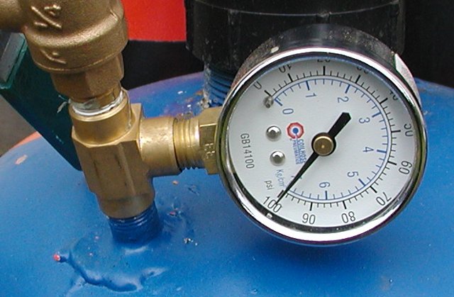

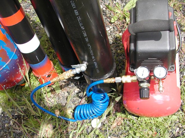

Edit, I had the time to do this year's pressure test. Results are below. Click on the photos to enlarge. The cannon pipe label is clearly shown. It is ABS Cellular Core DWV.

I used to fill the cannon with water in fear it might grenade. Now that I have seen several videos and photos of the failure mode of the stuff, i don't bother anymore. i hook up the airline and just stand back a few feet with proper eye protection, heavy pants, jacket, etc. 100 PSI can make a very loud report, but it is probably not going to expel shrapnel. I stand clear of obvious bits that can be thrown such as the fill valve, and valve core. After the pressure test, I operate below 3/4rs the test pressure for the remainder of the year. This year's pressure test is done. While I was at it, I went ahead and tested the other cannons.
This 100 PSI test is well within the maximum pressures you can expect from a spray and pray or propane cannon.

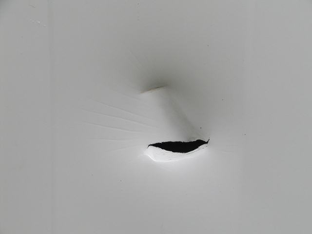

I found a page with photos of an ABS spudgun that split.
http://www.spudfiles.com/forums/abs-can ... t8573.html
Please note that this did not make shards.
