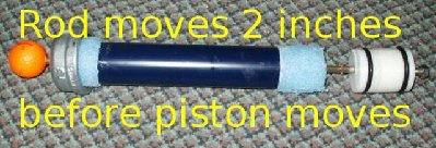

Using a spring or a sligshot rubber, would the ball valve open quicker if the spring was triggered and immediately began pulling on the handle, or would it be quicker to accelerate a mass and slap the handle open?

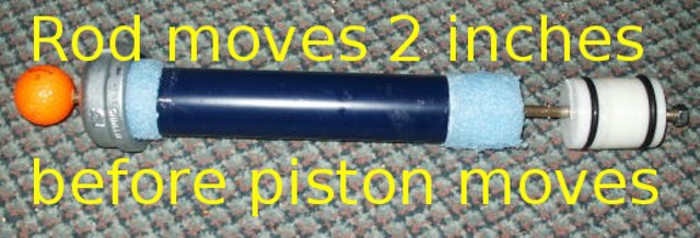

Hit a dragster with a train traveling 200 MPH and then consider the quarter mile time. You do have to consider the forces in your sudden impact and acceleration when striking something to accelerate it.
My valves are opened by an impact followed by heavy acceleration from air pressure. It gets the slow starts fixed. :D The trigger rod has mass and free travel distance before it engages the piston. It works best with a sharp pull.

Back on subject with another example.. Golf. Place the club right behind the ball and swing, vs swing and hit the ball. Which shot with the same force of arm power gives better distance and faster acceleration of the ball?
Same applies to a spring loaded mass with speed before reaching the valve. It starts to open later as you have to wait for it to make contact, but after contact, the valve speed in getting open is faster.
Again, this is used to eliminate slow startup of my valve. The golf ball, rod and hand picks up speed before contact with the valve piston is made. After contact the piston picks up speed rapidly from being struck.
QDV sliding hammer opens the valve.
