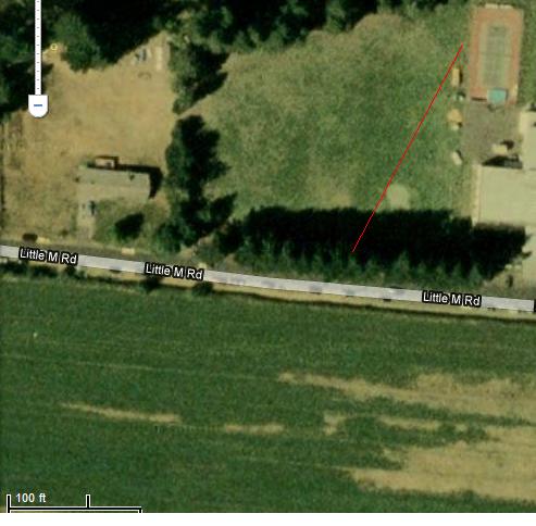

I'm going to toss this out for discussion. Find the hang time in this video. You can hear the can land. The thud is not very loud due to the distance. The sound reaches the mic after the landing due to speed of sound.
Here is the exercise. Find the hang time. A photo of the launch to landing is included below.
From the hang time, what is the approximate apogee? The can was a full 12 oz soda.
From the height, what was the approximate muzzle velocity?
Here is the landing. Watch the orientation of the center court net as we approach. It landed just past 1/2 court.
Pop can hang time.
- Technician1002
- Posts: 5189
- Pop can flight path. The launch site was powered by my car beside the road. A 30 foot extension cord was used to get past the trees.
- Pop can Launch.JPG (35.99 KiB) Viewed 4625 times

the delay in time before the sound reaches the microphone creates about 0.026871198 second of difference so the can hits the ground about 0.02687 second sooner then is heard, neglecting air resistance one way you can solve for this is:
~muzzle velocity(in fps)=(time recorded between launch and impact -0.026871198)16.087
pretty simple, I wouldn't bother with 2D kinematics because for all I know the wind could have affected the horizontal trajectory,
but if you insist I would still use the equation only let the answer equal the vertical initial velocity, then the
horizontal initial velocity = (distance between launch and impact site)/(time recorded between launch and impact)
then plug in the horzontal and vertical values into this Pythagorean therom based equation
~muzzle velocity=sqrt( (horizontal initial velocity)^2 + (vertical initial velocity)^2 )

I think the delay is a little longer than that. SOS is just over 1,000 feet/second. The distance is about 300 feet, so wouldn't the delay be closer to 0.3 seconds?

I thought you said 30ft awayTechnician1002 wrote:I think the delay is a little longer than that. SOS is just over 1,000 feet/second. The distance is about 300 feet, so wouldn't the delay be closer to 0.3 seconds?

The flight path is provided in the original post with the map scale in the lower left corner. 30 feet is the distance from the road where I parked the car to the compressor on the other side of the row of trees. The car provided power to run the compressor at the launch site. The extension cord is way too short to reach the landing site.
The launch angle appears to have been within 10 degrees of vertical.

Without knowing the Cd it is really impossible to determine the muzzle velocity from hang time or apogee height.
Even an 0.3 second error due to the SOS is pretty irrelevant in this case. In the video it looks like the hang time is about 13 seconds, so an 0.3 second error is only about 3%. The accuracy of the velocity calc in the absence of a decent estimate of the Cd is probably in the range of at least 50%.
The terminal velocity of a soda can is probably in the vicinity of 100 fps. Since that is probably significantly less than the muzzle velocity any calc that doesn't take into account the Cd is wothless.
The equation for hang time to muzzle velocity ignoring friction is;
Muzzle velocity = gt/2
where g is the acceleration due to gravity (32 fpss, 9.8m/s^2) and t is the hang time. So, on the moon, (assuming the moon had earth strength gravity) the muzzle velocity is just 16 times the hang time. A 10 second hang time would mean a 160 fps muzzle velocity.
Using what appears to be reasonable estimates for the Cd of a 120g spud a hangtime of 10 seconds corresponds to a muzzle velocity, ignoring air drag, of ~160 fps. Using a couple different estimates for the Cd of the spud, 10 second hang time corresponds to muzzle velocities in the range of 250 to 600 fps. So, inclusion of Cd in the model increases the calculated muzzle velocity anywhere from 50% to 400%. (So a 3% error in the time from the SOS is pretty darn insignificant.)

The projectile shape is known. What is typical Cd's for a short cylinder. I was approximating between 0.7 and 1.1.

I'll help out. The can was launches somewhere in the 300-400 FPS ish range. We didn't measure it. This is based on cannon performance from prior measurements and approximate pressure used. The end first orientation is effective for only the very fist part of the flight.
As far as I can tell, the can wobbles on the way up and soon flies sideways. The sideways flight continues on the way down and is a stable orientation for falling soda cans. All high lobs I've done with full soda cans land flat on the side with no exceptions.
This turning of the can sideways does seem to scrub off quite a bit of velocity from the shot. I have considered adding a tail to a can to see if it helps.
The school I mentored on a shirt launcher has added streamers to shirts they launch to maintain the end first profile. They are getting much better range by doing that even with the drag of the streamers. I'll post some picks of shirts with streamers later to show this.
I remember hitting the wall at trying to exceed 400 feet with a rolled up shirt. It is a difficult distance to pass. Lower pressure shots flew further than high pressure shots, etc.
