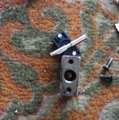

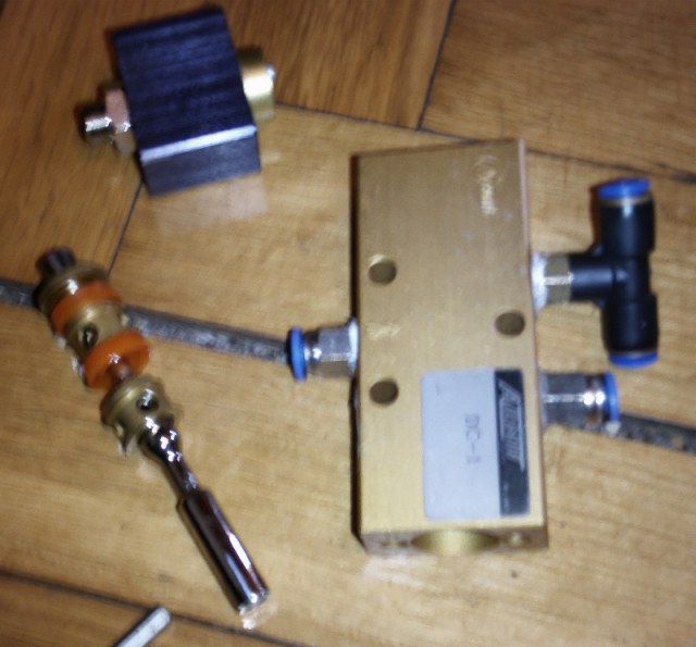

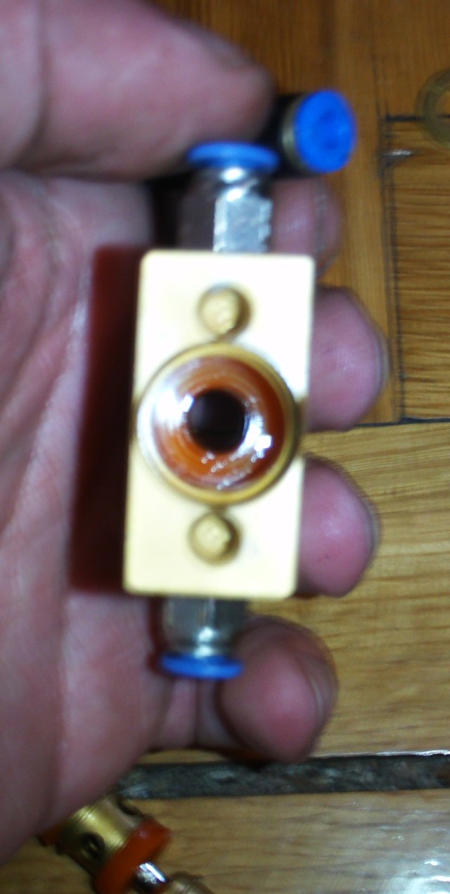

nice I am surprised that you decided to build a spool valve... it seems it would be easier to build a poppet valve
I am wondering whether it has better or worse flow than off the shelf DCVs?
I am asking becasue you can find a lot of DCVs for under 15$ on ebay so the question is whether it makes sense or not?
If its flow is better then you might have built something very useful
Ohh btw you can also use the design where the spool is just a rod without o-rings... teh seals themselves are thick rubber washers sandwitched between solid spacers and spacers that have holes cut through them so that air can pass (sounds complicated but it isn't - I'll try to find pics of it)
