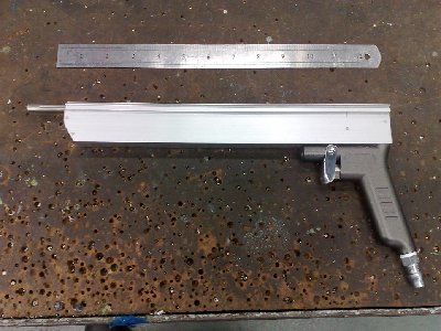

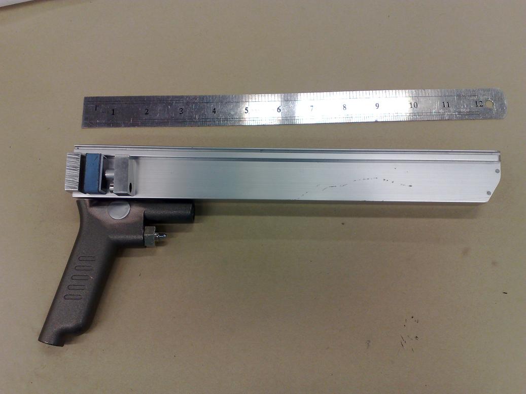

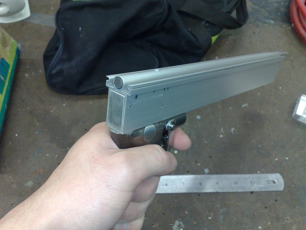

my kind of coaxial pistol gun
made from aluminium extrusion and a modified blow gun. the barrel has a hole drill down into the lower chamber and into a alloy block where the air travels in a Z path through the block and the piston seals up against it as in a standard coaxial. a hole underneath the end of the barrel in the block allows air to enter the pressure chamber infront of the block.
with this configuration i am aware that it is not as efficient as a standard coaxial with the restrictions and change in direction of air flow, but that was not my aim, i wanted a semi realistic pistol with decent power which this has.

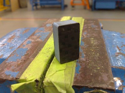

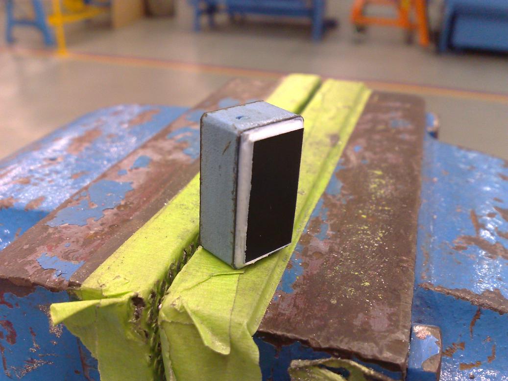

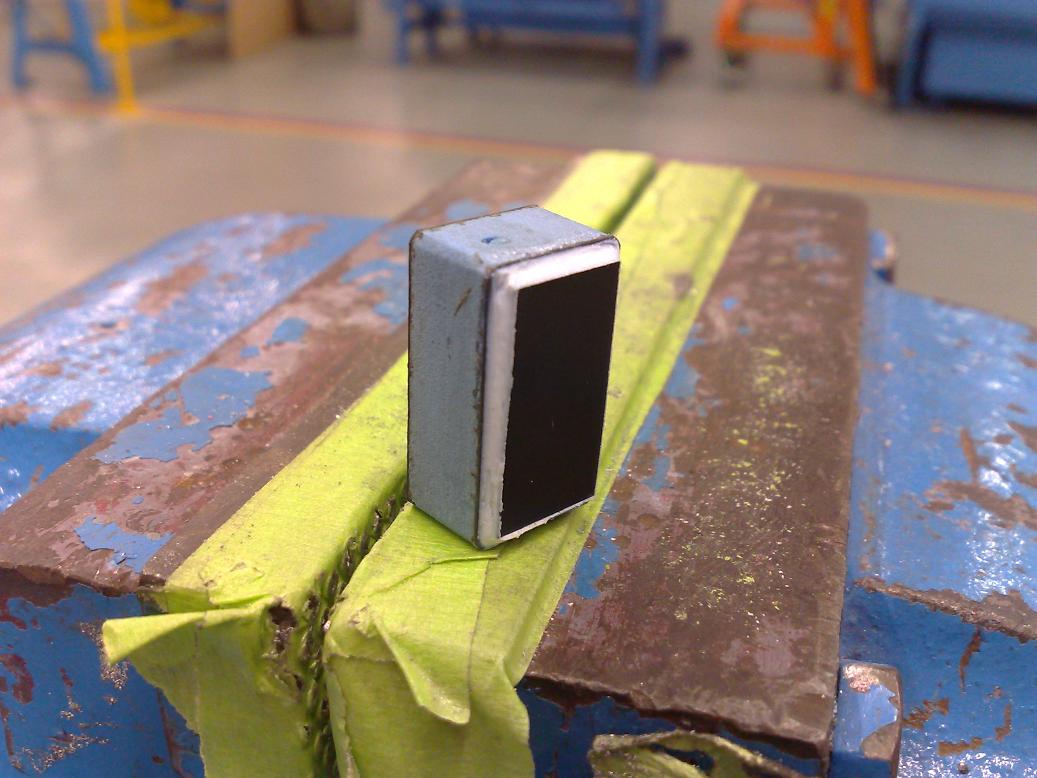

the rear of the carbon fiber piston, the blue stuff is a filling compound
the front of the carbon fiber piston

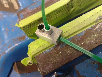

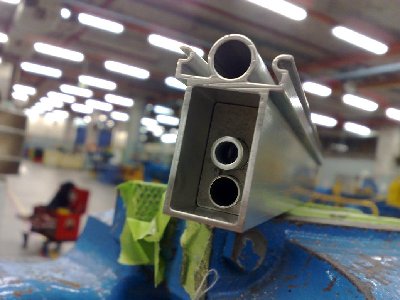

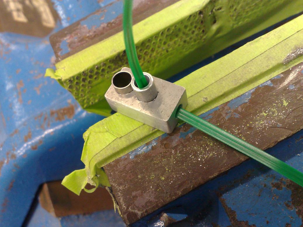

the barrel Z block in its position inside the pressure chamber

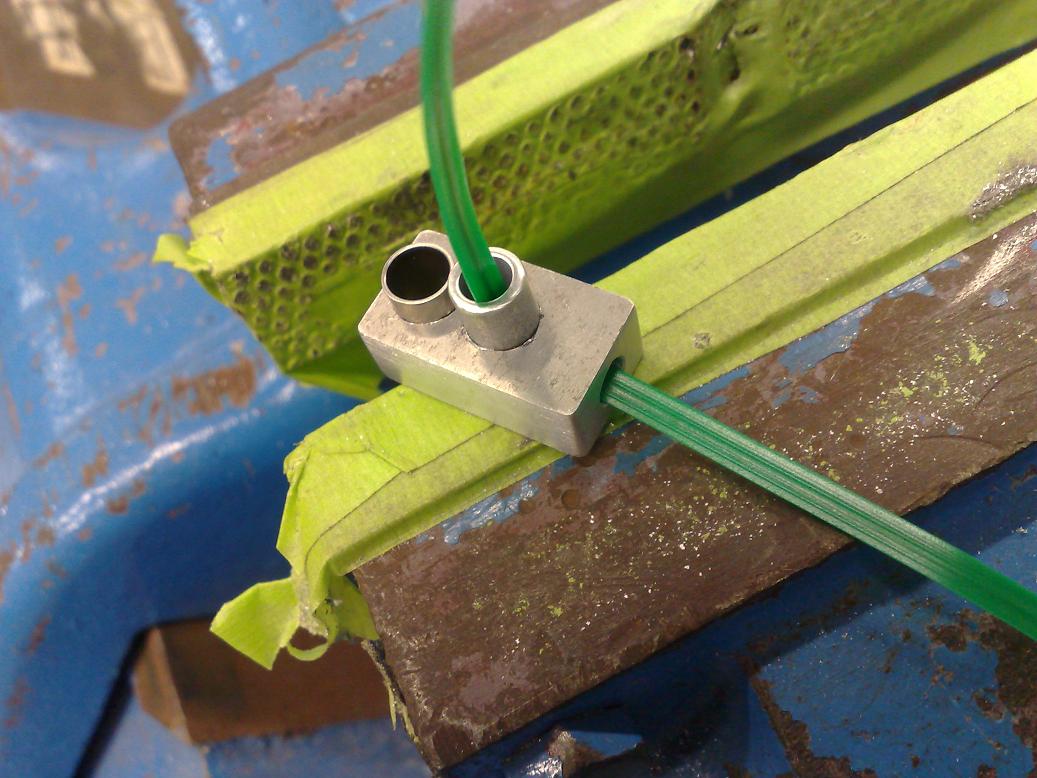

the barrel Z block
the barrel Z block
the components in their positions

chinnerz
Posts: 470
NICE!!!
Carbon fiber piston eh..... interesting
qwerty
Posts: 678
The first square piston on spudiles? anyway looks great you could try making the blowgun/handle a little thicker to make it more realistic.

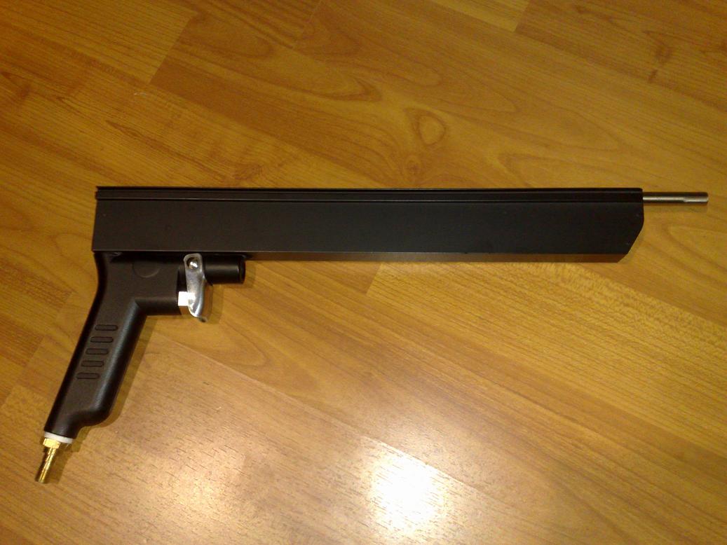

new paint job
new paint job, satin black
