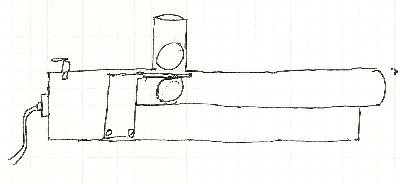

I just got into pneumatic spud cannons and I think its awesome! So I was looking at a lot of semi-auto designs and it annoyed me how you would have a dry-fire 2 out of 3 shots. Sure these were fast, but I wanted reliable :o
This probably has so many issues in so many different areas, but I thought hey, you guys are professions, why not give it shot and see if you can help me out?
P.S: The piece of PVC that lets the ammo in is attached to the piston. This is not to scale all either.
P.P.S: There's a lot in the drawing that doesn't work out but bear with me; this is just a concept that I drew up really quick. The length of the stopper would have to be just right to let a ball out after all the pressure would be released. Also, the area behind the piston, would have to be the right length.

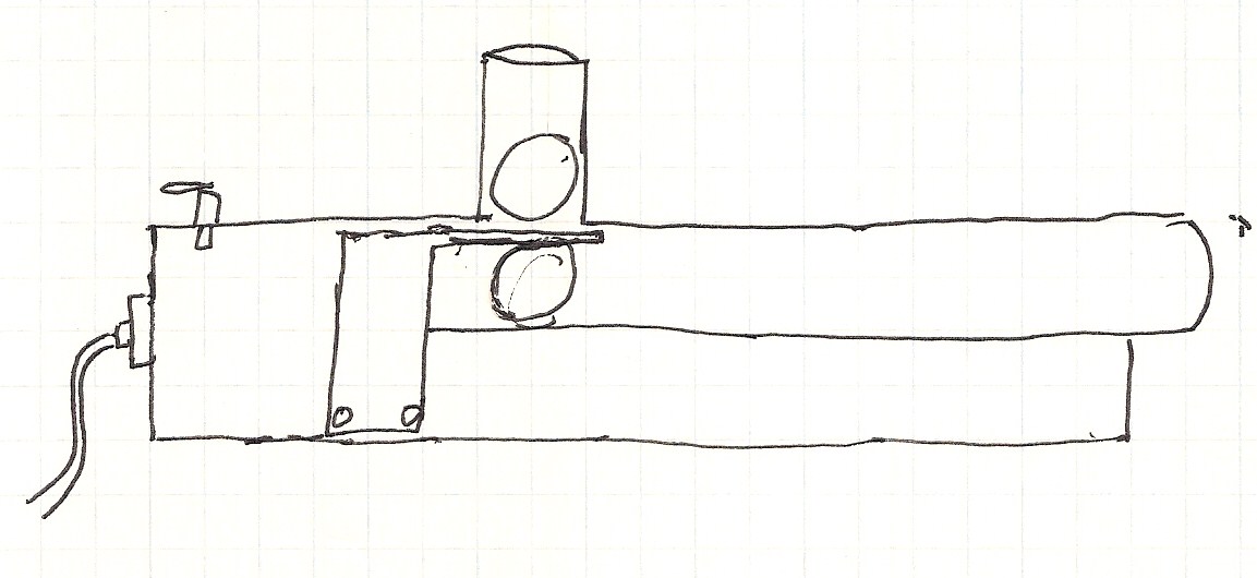

The dots are the leaks. This design makes the top chamber redundant(useless) though.

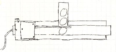

Version Two! <br />I would have to add some strong supports for this to work...
Version Two!

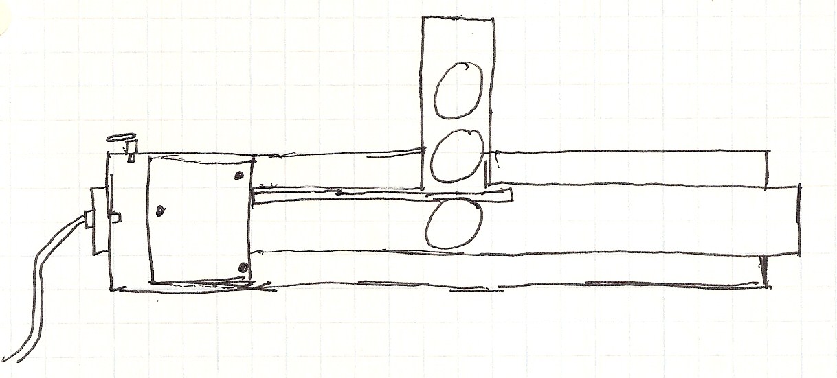

Coaxial design is non é coretto! I just done like how a separate chamber looks. This would require some extra cutting.

If you have airflow in behind the piston your trying to pilot, you wont create anywhere near as much of a pressure differential on the piston so it will either actuate really slowly or wont actuate at all. The solution would be to either use another ball valve which wouldnt be real semi-auto, or use a dcv which adds complexity.
Also the chambers volume may be emptied, making the piston close before ammo has time to drop in.
And if its a coaxial your drawing it will be incredibly difficult to get the magazine to seal with the chamber and the barrel.
Having just built one, I can tell you using a dcv and pneumatic cylinder may seem more complex but in the long run it simplifies many more problems.
p.s. its p.p.s ;)

Thank You! You're insight has been very helpful! I made a second version. I will try to refute your issues :P
  1. making the piston close before ammo has time to drop in: This would be operated at a low P.S.I, causing the piston seal slower, giving enough time for the ammo to drop in. If I did the math, I think I can come up with several solutions such as a bigger chamber behind the piston.
  2. it will be incredibly difficult to get the magazine to seal with the chamber and the barrel: Very true, and to make sure, the magazine is circular, which I would think would make it easier to seal.
  3. actuate really slowly or wont actuate at all: It will operate very slowly, simplicity and reliability is more important in this design than function.

Ah, I see and no size of ball valve would allow me to release air faster than it was pumped in?
Mathematically, this could work? Extended section is the same size as chamber.

No a most ball valves would vent air faster than its coming in the point is there is more pressure behind the piston if more air keeps coming in as you vent it.
