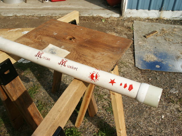

Presenting The Mouse Musket
I refer to The Mouse Musket often to help describe construction ideas and piston theory. I had a request to post this so here it is in all it's glory.
The musket started as a concept before I joined SF as about my 4th piston cannon. This was up to that date my most advanced cannon. Since engineering is a hobby as well as a job, I looked at my past failures and looked to improve upon them. This is the result.

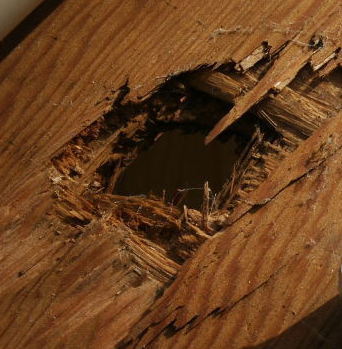

In testing to see if it met the design goals, a fast valve would be needed with good flow to get high speeds on light projectiles in the short barrel. I didn't have a chronograph. I decided to splat a gumball on a sheet of plywood to see if it would dent it. To my amazement, it punched a hole right through it.

A decent shot of the Musket artwork finishes this series of photos.  This cannon lasted 5 years.  It broke almost a piston per year. The sandpaper glued to the board is the piston size adjustment tool. ;-)
This is the exit side of the hole.
Gumball hole.jpg (37.4 KiB) Viewed 7495 times

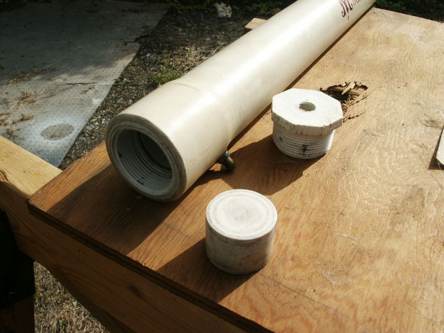

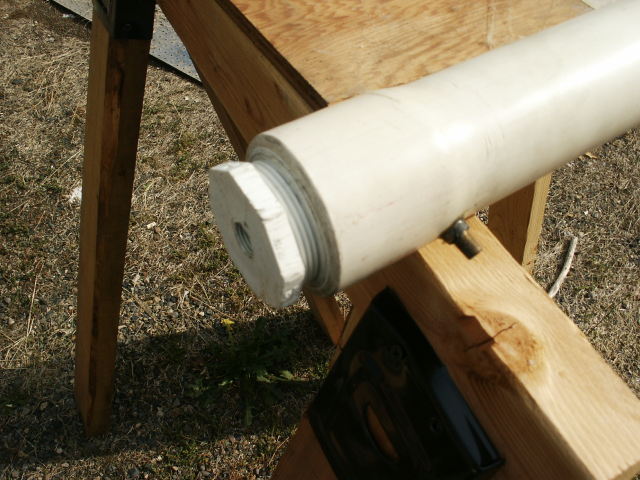

A 1.5 inch pipe plug with a hole for either a blowgun or 1/4 inch ball valve finished the cannon.  Note the hole in the plywood.  This is a gumball hole.  The o ring seal area on the piston face can be seen.

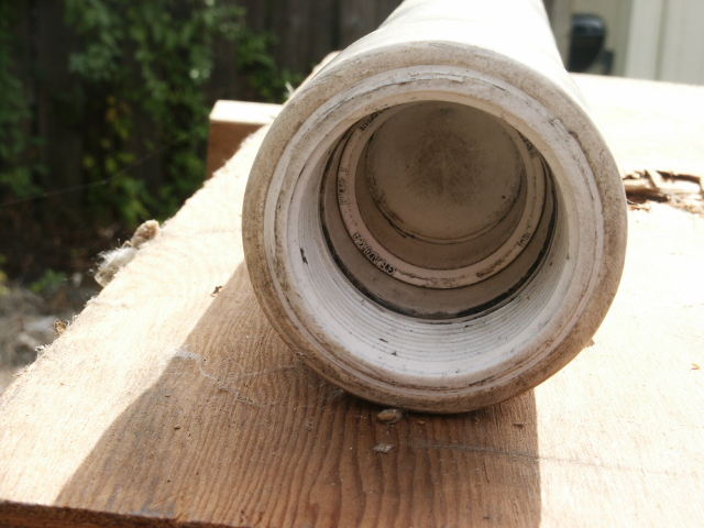

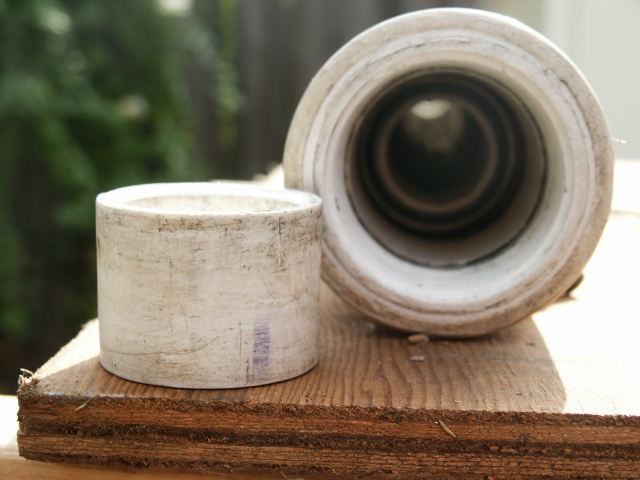

With the piston out you can see the valve seat.<br />The piston was gently sanded on a piece of sandpaper glued to the plywood until it just fit inside the breech.  Note the sanded appearance.

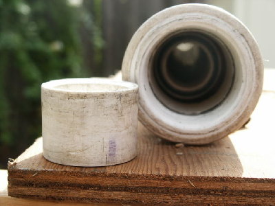

This shows the original PVC 1 inch pipe cap as a piston inside the 1.5 inch inner cylinder in the female adapter.
The Musket Breech showing the 1.5 inch female adapter inside the 2 inch chamber

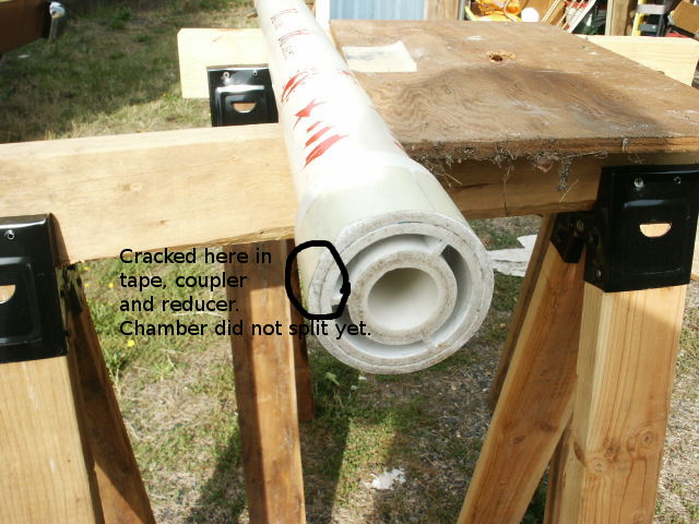

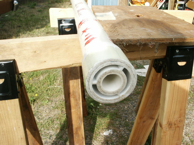

All good things must come to an end.  This got knocked over and cracked the coupler.  The crack spread inside to the chamber wall and reducer inside.  The reducer crack leaked.  The leak was discovered before it blew up.

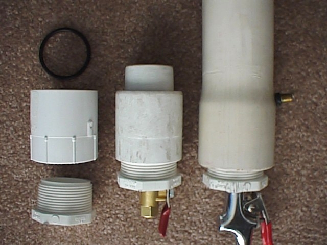

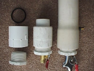

Musket breech detail.  Female adapter with 1.5 inch pipe is added in the 2 inch chamber.  The o ring becomes part of the valve seat.
