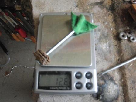

Cheap and dirty cardboard sabot nail dart.
Cut some cardboard disks with a piece of sharpened barrel tubing, hot glue them to the head of the nail, hot glue T shirt tail.
They flies straight and true however, not as fast as the shotshell sabot that has a better barrel seal.
This dart is in the ~600 fps range even though it weighs less than the shotshell hull design.
IOW A cheap, quick dart, that weighs more than 10 times heavier than an air rifle springer pellet and yet it goes at the same speed.
The cardboard has some potential:
Add more disks for a better seal.
Curve the first one into a nose for aero.
I've used the lid off a pop bottle. It is stiffer and less mass. I'm working on softening them to custom mold them to my barrel sizes.
