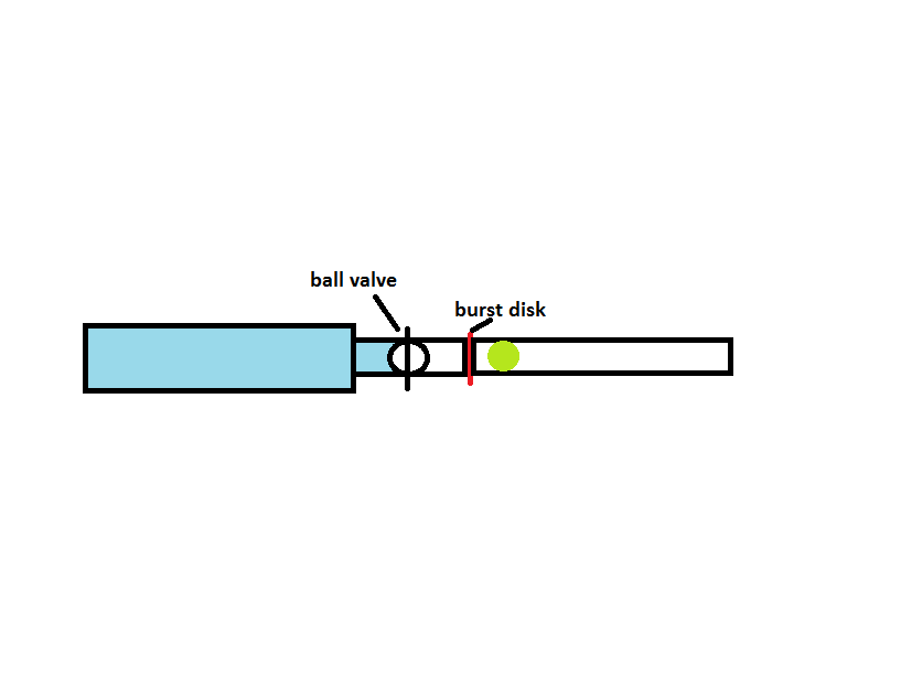

use a ball valve in combonation with a burst disk
edit damn it Ranger you beat me to the post while i was doing my drawing
use a ball valve and a burst disk its safer
- BDBV.png (11 KiB) Viewed 3398 times

Look in the "hybrid showcase" sub-forum and you will see alot of burst disk guns. They are not pneumatic but you can use the disk setup from them.rootuser wrote: I'm not sure I understand how the burst disk is inserted and re-inserted
Unions is what's used the most.

Here's Where I got my idea. Also some of his videos
Basically (well technically
) Its a piece of duct tape inbetween a coupler and another piece of pipe. When air is applied the tape bursts and makes a loud POW!
Hint. Sand the coupler and the pipe so that they are a very loose fit this way the duct tape will not be hard to load.

On this page there is a sound recording of a 1 inch fast piston valve dry fired at 80 PSI. A burst disk will have more of a pop sound as it opens faster. Fast piston valves are loud with a short barrel. Burst disks are even louder.
http://www.spudfiles.com/forums/present ... 21108.html The sound file is a wav near the bottom of the first post saved as a zip file. A larger cannon will make a bigger sound.

Well I'll tell you what, when I put a 2" tee with a hole in the middle on the end of my 1.5" GB barrel, it makes the most piercing bang I have ever heard at 60 psi, I don't dare go 100 psi.... it is a 2" piston valve with a massive 2" chamber BTW.
Ranger, a ball valve in combo with a burst disk is mych safer cause you know when its going to go off
AHahahahah!!mikemurph wrote:yea, the ammo has been changed to a more aero dynamic projectile. it consists of the back half of a dart, and a hot glue ball
Yep, short barrel and burst disk is going to make a lot of noise. definently have a valve behind the burst disk so you know when its going to fire.

With a tee muzzle break on the end...
