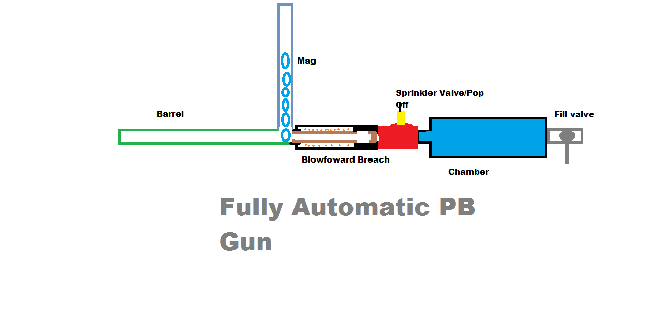

I saw a few posted on Spudfiles the other day and got an idea, it was a paintball machine gun. It was a blow forward breach. It seemed to have some dead space. I drew up a diagram of how it works as I understand. Am I misunderstanding how it works. Also where can I get a saftey pop off valve thats pops at 60 psi. I could not find any reasonably cheap ones on ebay.

Actually, that's a chopped version of clide's diagram
You need a ball valve between your pop-off and sprinkler valve to use this as a trigger, otherwise it will just fire as you fill it.
Our benevolent sponsor has 10 buck safety valves, 140 psi but I'm quite sure you can take these apart and fiddle with the spring.

Cool thanks, the ball valve in the back will act as the trigger, I just accidently made it closed when I was drawing the paint pic
That is all.
I think you should have a valve between the pop-off and the sprinkler, sprinklers need high flows to reset otherwise they will just honk.clemsonguy1125 wrote:Cool thanks, the ball valve in the back will act as the trigger, I just accidently made it closed when I was drawing the paint pic

Wouldnt it have the highest flow since theres no valve restricting flow to the breech, and the popoff wont pop till 60 psi.

When you open the "fill valve", the sprinkler valve will not be sealed, the pressure in the "chamber" needs to be at least 15 psi or so before the valve will stop honking, which will make for a pretty awkard firing cycle.

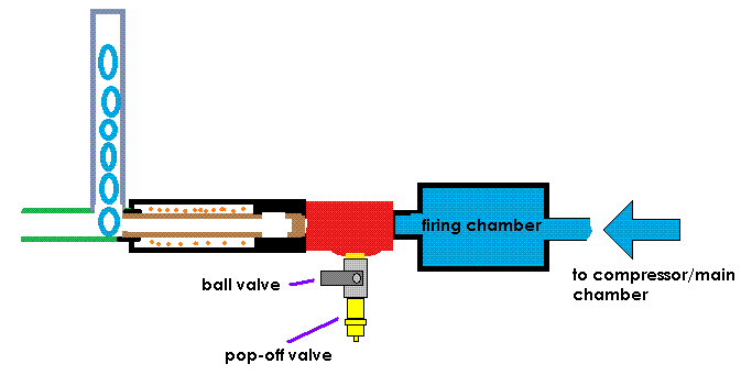

Your best bet is something like this:
- pbmgmod.GIF (7.5 KiB) Viewed 4455 times

Ok cool, so I guess Ill use a 1/4 ball valve for that

I was talkin to spudtyrannt and he said the valve would honk even with the BV before the pop off
