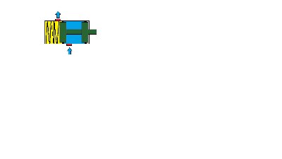

I was wondering if this design would be feasible as a BHV (Balanced Hammer Valve). All thoughts, questions, and suggestions are openly welcomed. I addressed this in a previous post but I would like to consider myself slightly more knowledgeable at this time.
This was my first attempt at a diagram on paint so take it easy.

you believe correctlySlauma wrote:This is basically the design used in most blowguns use I believe.

So then this valve is balanced. Huh seems like more people would scale this up and use it. So am I right in assuming it the configuration I presented I would only be fighting the force of the spring to open the valve being balanced. Then the same spring force closes the valve when whatever being used to open it is no longer applying force to the valve stem. Has anyone used this as a main valve for a airsoft gun. Seems like it could be ideal for low or high pressure of course factoring in working pressure of the materials used for construction and the such.

Such a valve would have terrible performace, probably even with airsoft calliber, unless the pressure is insane. BTW anything over 200 psi is insane to me 8)

Antonio tried it and had poor performance

... but with a short barrel and low pressure as he was using, this was to be expected. Most commercial pneumatics with hammer valves operate at 200 bar, not 8 barclemsonguy1125 wrote:Antonio tried it and had poor performance

Nut most members don't have access to 200 bar, I don't even have access to 200 psi until I order my shocky

There are other avenues to add power - modding the blowgun for higher flow, using a stronger hammer etc.

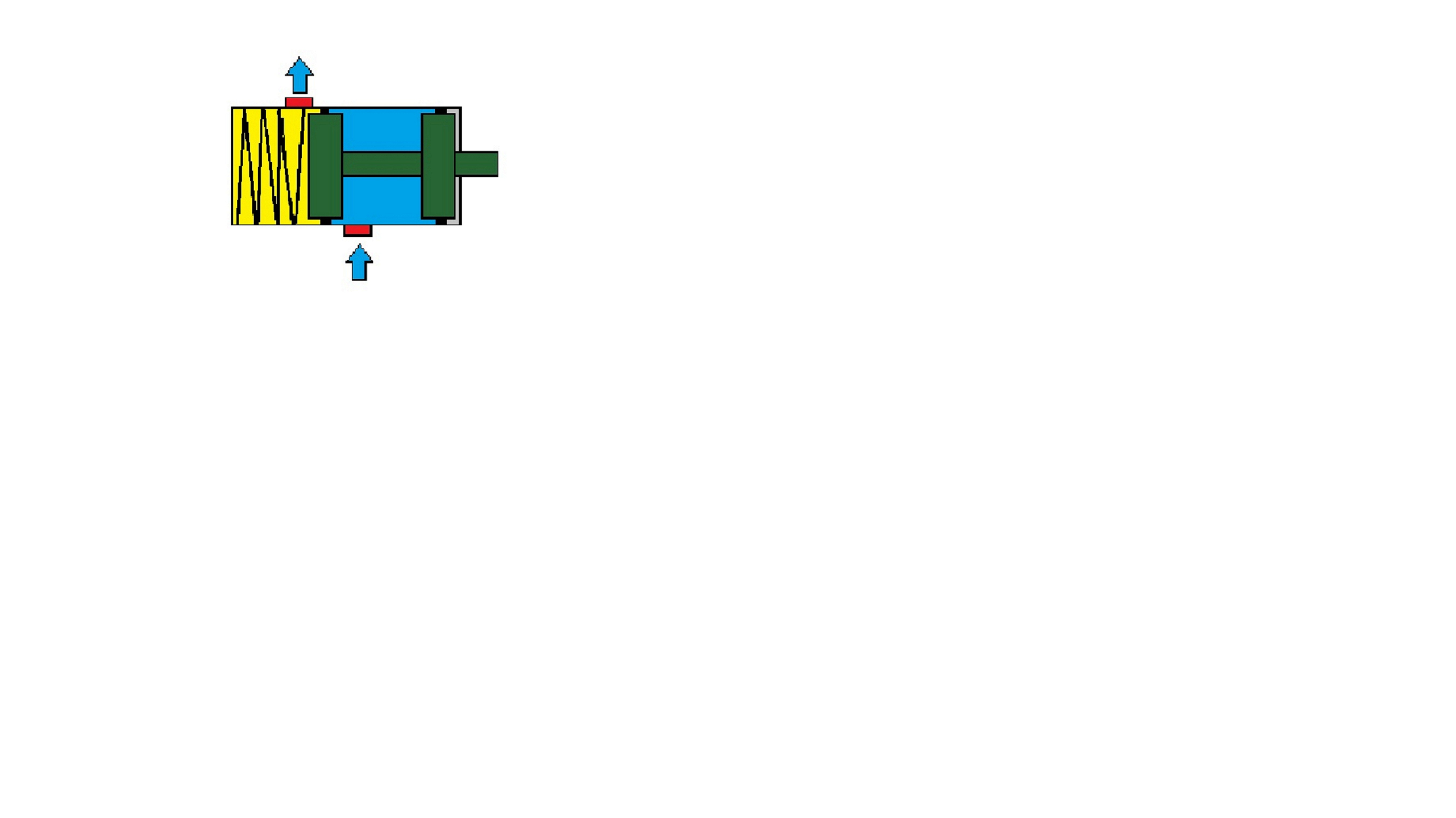

hi here an other config for a balanced hammer valve.
i show in this
http://www.spudfiles.com/forums/piston- ... 17684.html
thread an pic of it
