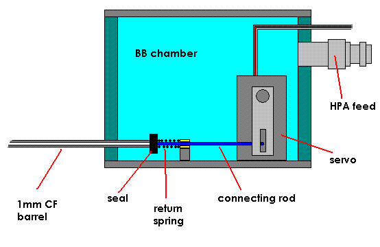

Clutching at straws here, any reason why this would not work, assuming I'd drill a couple of equalisation holes in the servo casing to avoid it imploding?

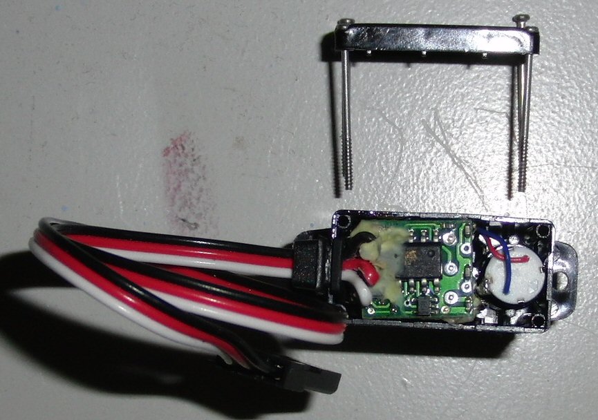

As long as the circuit board and motor housing has EQ holes as well. Make sure the motor in the servo isn't oil bathed, some are...
jrrdw wrote:Make sure the motor in the servo isn't oil bathed, some are...
Doesn't look like it, what do you think?

1mm holes in the casing ? :)
4mm, to match the flow from the HPA feed ;)
Pull the motor check for slots in the casing (where tangs are made to hold the field magnets). Factory EQ's. Nope, not a swimmer!

I'd be more worried about the grit you're using as ammo getting caught in moving parts.
Any particular reason why the barrel protrudes so much into the chamber? A piston similar to your first shell ejecting designs seems like a better option to me, for flow and feeding. (and in fact, the same goes for piston valve designs)
al-xg wrote:I'd be more worried about the grit you're using as ammo getting caught in moving parts.
Fair point, perhaps some sort of mesh is in order :)
I thought it would stop the piston being jammed open by the "grit" when it comes to re-close. Which piston are you referring to?

Long piston instead of long "inner barrel", and seat could even be cone shaped or profiled to which ever curve works best. The overall flow would be improved.
Instead of the spring you could just use the servo to return to initial position ? Or have a spring on the servo arm instead it might help making the design simpler and more reliable.
You mean it should be oriented upwards? I fear that would cause feed issues.

Just using a longer piston and a shorter seat tube on piston valves. It just makes the air (and ammo) flow much more straight forward.
But I do see the anti-grit jamming advantage in this case
Interesting thoughts. I'm wating for some CF tubing to be delivered for use as a barrel, I think I'll give this idea a go.
It avoids using a ball valve which saves a not inconsiderable amount of weight, plus the chamber is guaranteed to be at the full 800 psi before firing, surely the resultant flow will be enough to agitate the BBs and feed reliably...

It should just work like any other cloud BBMG, mmm actually isn't there a certain danger of exploding ? I'm guessing the chamber has to be quite a large diameter, and the epoxy plugs will have to be quite thick...
It will fit into the copper tube I used for the 12 bore, should be quite safe.
Alternatively I could have the piston rod extend out of the chamber and have the servo externally mounted, but that would mean tiny o-rings which I'm not terribly keen on...
