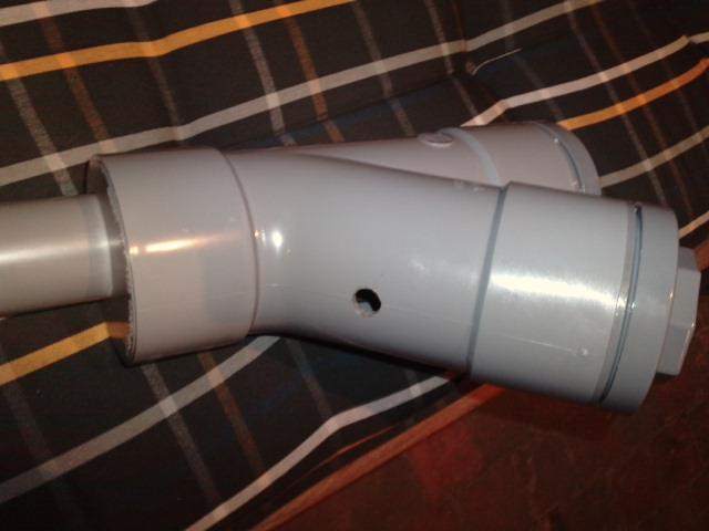

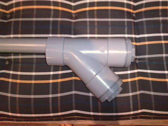

its a T out of pvc and at the side i made a hole where the candle lighter fits in. i'll see if i can post a picture. and what is a pilot hole?^^

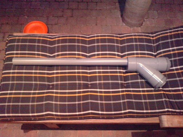

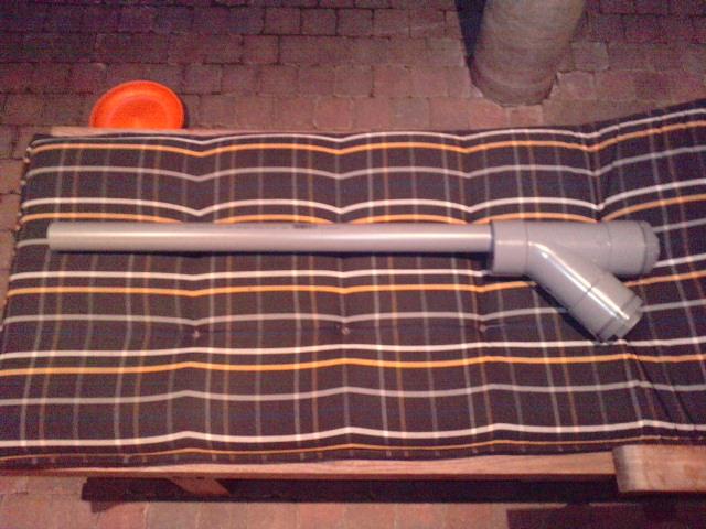

this are photos of my spudgun
here is put the candle lighter in
combustion chamber
combustion chamber

first off thats "Y" not a "T" and you are losing a lot of power due to the pilot hole. i dont have much experience in combustion cannons but try different fuels

kydavies wrote:first off thats "Y" not a "T" and you are losing a lot of power due to the pilot hole. i dont have much experience in combustion cannons but try different fuels
So you are saying the cannon is ok, but it loses some power thanks too the pilot hole but it will work? and that i just need to try other fuels

You are also losing power because the Y is an inefficient combustion chamber, a piece of 4" pipe would be better
You are probably spraying too much fuel, try with a very short spray. Also, there are better sprays to use, like starting fluid:
