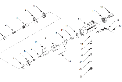

Does anyone have pictures, diagrams, drawings or any information on the workings of a pneumatic die grinder?
I tried pulling mine apart this afternoon, but I'd have had to destroy it. I couldn't really get a good look inside.

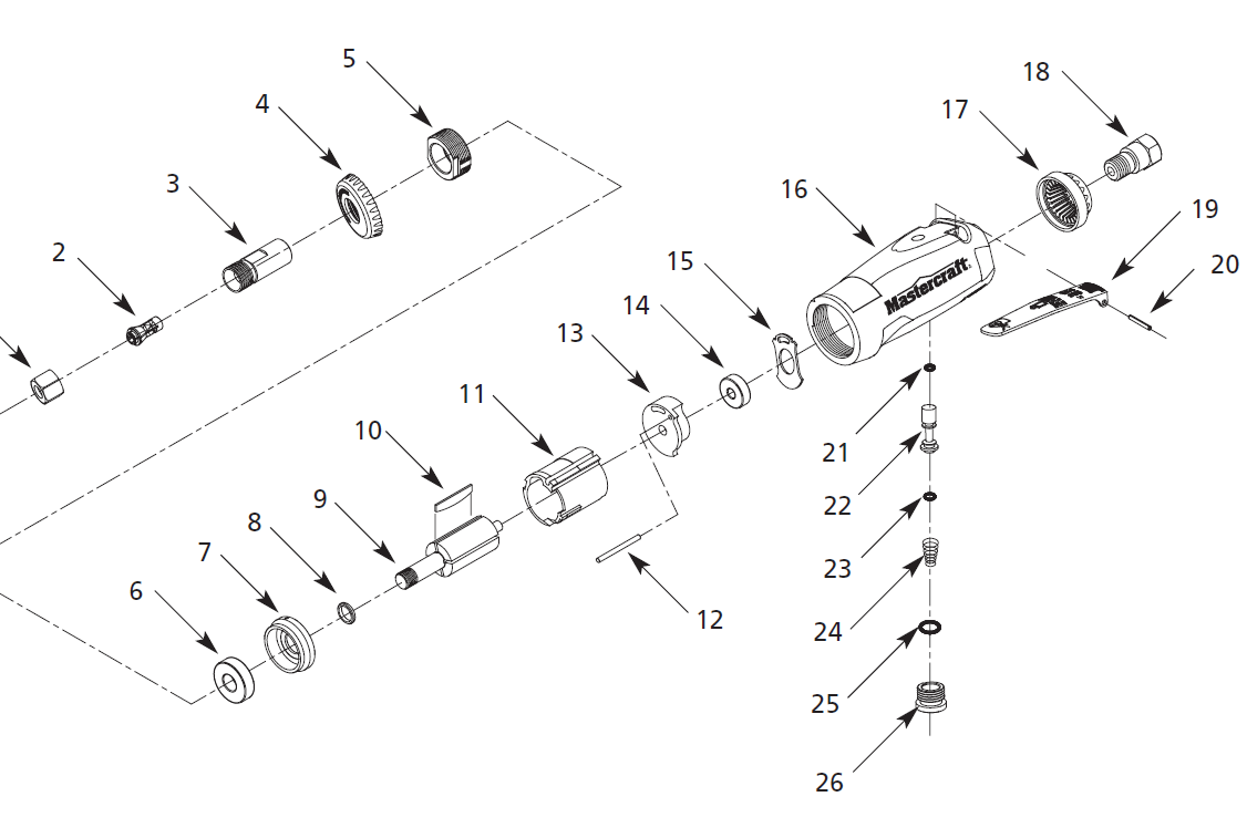

this is the best I can do also .....
here is the link for the pdf I took that from
http://d3cmirsdb60x3h.cloudfront.net/sc ... -2.big.pdf

hmm i think its like a propeller that spins when air flow through it
I was just looking at some air impact wrenches that claim ~500 lb-ft of torque. Does this rating include the effect of the hammering, or does it mean that if I attached a 1 ft horizontal bar to the end, it would lift 500 lbs?
IIRC, these things use rotary vane motors.

Thanks, this is what I was looking for. I found some pictures on the working of the rotary vane. Looks alright, but could be a PITA to machine.ramses wrote:I was just looking at some air impact wrenches that claim ~500 lb-ft of torque. Does this rating include the effect of the hammering, or does it mean that if I attached a 1 ft horizontal bar to the end, it would lift 500 lbs?
