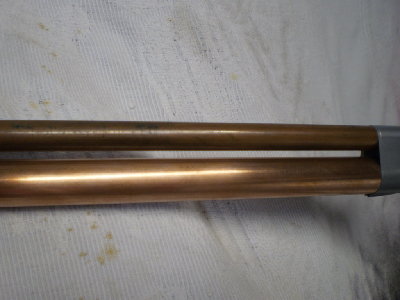

Hi, im building a 400+psi QEV bolt action copper rifle, with a oak stock.
4x32 scope. ammunition Holder, and bi-pod.
The gun it's self is about 60% completed and i just finished polishing the 3/4 copper chamber but the soldered weld's remain and i believe that
"If your not happy with it it's not finished."
So what would be the best way to remover them?
3/4 chamber with 1/2 barrel running alone length.
polishes 3/4 chamber with ugly weld's.

The light coating of solder and coper oxide from heating can be easly removed by using 0000 steel wool. After the surface is clean, then proceed to polish with your favorite metal polish. A buffing wheel and jewler's rouge works well and so does Brasso.
You can pre polish with 600 to 1200 grit sandpaper to remove the scratched appearance you already have and polish to a mirror finish.
Initial sanding produces a scratched appearance.
When you move to fine sandpaper, the larger scratches vanish and the metal starts to get a fine shine that can be finished with polish. The pipe below was only sanded. It is not polished yet. The smooth finish is for a valve. The pipe on the left is what the pipe looked like before I started.
Copper can be polished to a fine shine.

maybe you could use the stuff that you clean the weld marks off stainless steel, i think its called pickle juice. its a mix of nitric and hydrofluoric acid.

Just use fine sandpaper (wet + dry), then finish up with a foam scotch pad or steel wool.

What are you going to coat the copper with? Without a coating the sanding and polishing is waste of time, the copper will oxide within a few weeks.
IIRC, lacquer and tung oil are often used as protective coatings on copper.

I've coated none of my cannons but it might be of interest that the JustForCopper stuff used for creating the joins forms a protective transparent layer. There's strips around the joins which are as shiny as several years ago.
Can't say for sure what it is but I've heard that variations on the theme of cyanoacrylate are not uncommon for some kinds of pipe joining.

Just a wire wheel on and angle grinder or drill with a bit of silvo FTW.

I only used steel wool and ran it from top to bottom a few time and it seems like it weld marks really don't wanna go.
And i want to finish it and get it on here a.s.a.p Because it So Beautiful.
