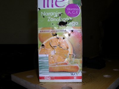

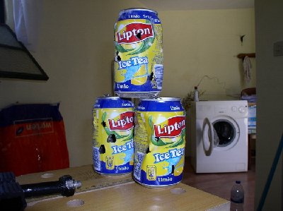

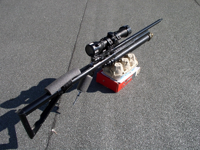

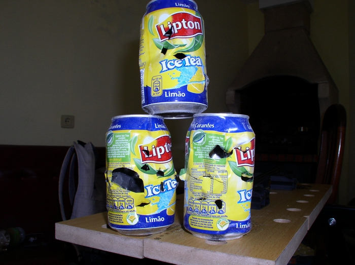

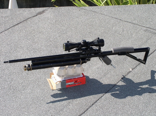

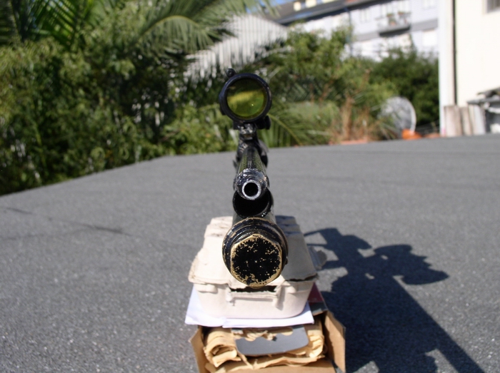

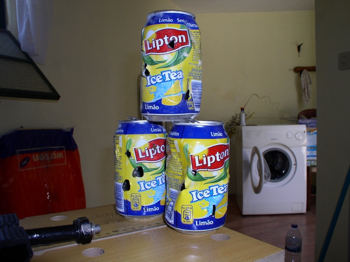

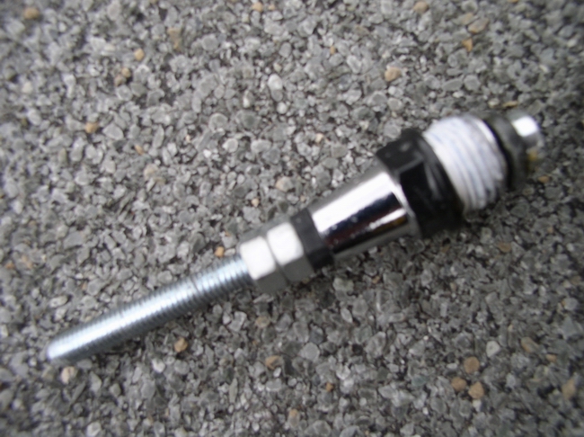

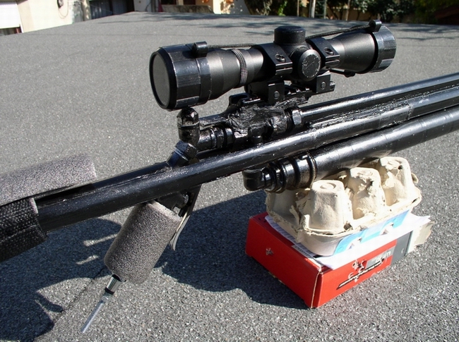

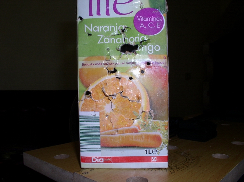

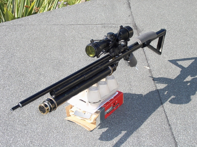

This is my latest build,a semi auto sniper rifle.With 150 psi i can chose shooting time from 3 to 15 :D . The barrel is 6mm in dia and 40cm long,1/2QEV pilot by a semi auto blowgun,30cm 1' chamber.This gun is accurant too :D it's great to shoot a apple at 30m :D.Damage pics :)

Looks very nice, very clean construction, i like it. And you should deffinately crank up the pressure, 15 psi is nothing. you could take that up to 250 plus psi no problem. You would notice an enormous power increase.

I would recomend a silencer or a muzzle break at that pressure...

thats epic, i want to make one now! nice job! 15 psi or 15 bar?

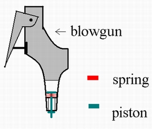

nice gun, but I can't quite tell what the loading mech is. care to elaborate?

I too would love to know. I would also like to know what you refer to when you say "Semi Auto Blowgun".

i think by semi auto blowgun he means this

ilovefire wrote:thats epic, i want to make one now! nice job! 15 psi or 15 bar?
right,i meens 150 psi :lol:
blind909 wrote:Looks very nice, very clean construction, i like it. And you should deffinately crank up the pressure, 15 psi is nothing. you could take that up to 250 plus psi no problem. You would notice an enormous power increase.
sorry i meen 150 psi :lol:
Lockednloaded wrote:nice gun, but I can't quite tell what the loading mech is. care to elaborate?
well i use a magazine that works like a shot gun,but automatic.

It's complicate to tell,but i give you a pic :)

You have left out lots of details though, Does the blow gun just let out a small burst of air or is the gun hooked up to an air supply? and when you said,
wyz2285 wrote:well i use a magazine that works like a shot gun,but automatic.
You are very unclear here...

As for the blowgun(this is how i think it works, dont quote me tho). I think what happens is that when the blowguns lever is pulled, it lets out a little air, piloting the qev,then seals the piston attatched to the blowgun, without letting all the air out of the chamber all at once, just my 2 cents

I use a nother tube for magazine under the barrel in parallel
Gun Freak wrote:Ahh, so it only lets out so much air, so it doesn't go through the whole tank in one shot, is what you're saying?
that's right :D
