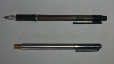

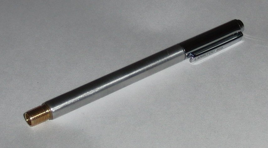

My original pen gun was built in a hurry for a spudfiles contest and wasn't very refined, I figured three years on it was time I made one that could actually pass for a pen :)
Since the focus is on aesthetics, dimensions are rather limited - for example the 3mm barrel is only 70mm long - but the 8mm I/D chamber tube gives a high C:B ratio. Internally it's similar to my pengun v2 with a solid rubber piston cut with a sharpened tube from 1/4" sheet. I also added a small neodymium magnet to the breech in order to stop projectiles from rolling out.

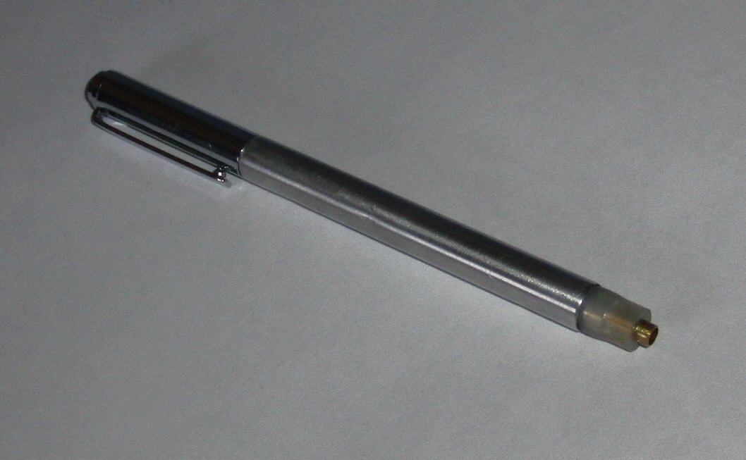

All that's left is to add a rod to the cap so it can be used as a trigger, meaning once it's loaded and pumped it can be carried alone and used without ancillary items. I would also like to find a suitable cap to disguise the schrader, maybe a turned down tyre dust cap.
edit: added the cap as a firing mechanism :)

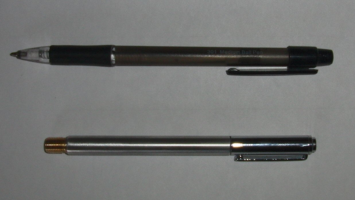

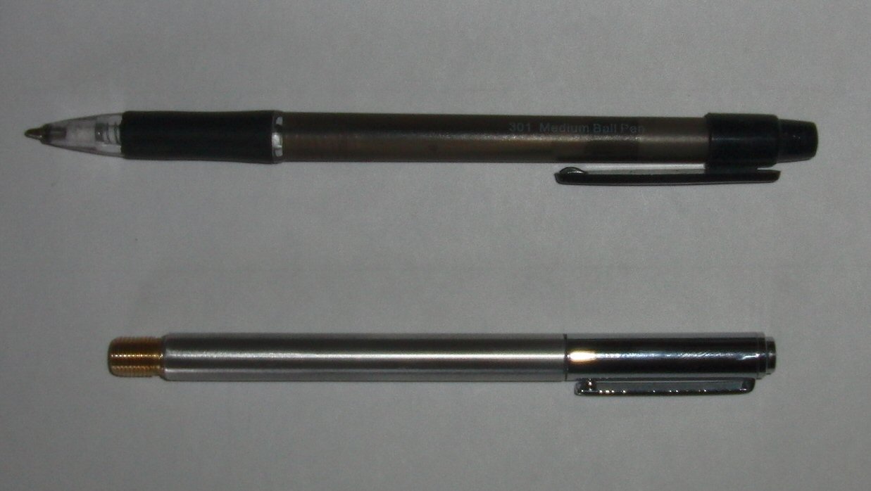

comparison with an actual pen
open (firing) configuration
closed (carry) configuration

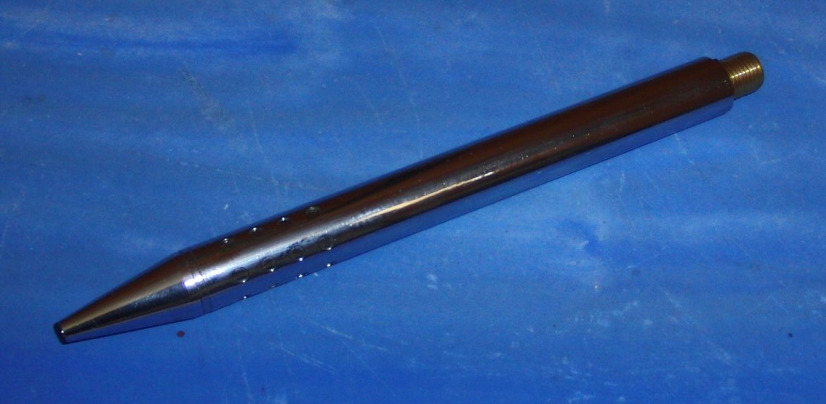

Mr.Sandman wrote:what pen was it that was used for this build, the cap would look perfect spray painted gold colored and put on my pengun.
This one.
Originally I wanted to fit the coax in the pen body, but I was a little too heavy handed while hacking it up :roll:

Location: East Coast
In the second picture is that solid epoxy you used to hold the barrel in the center
That is all.
lozz08
Posts: 239
Joined: Wed Jul 01, 2009 7:33 am
jackssmirkingrevenge wrote:
Mr.Sandman wrote:Dear lord jack, you just love 1up'ing people :lol:
Lol I know that's what it looks like, but actually this has been in the pipeline for a few weeks now, I was just waiting for the pen I ordered to arrive so I could cannibalise it for parts ;)
jajaja, we all know who the star of this forum is... in australia we have a thing called tall poppy syndrome for people like you...
clemsonguy1125 wrote:In the second picture is that solid epoxy you used to hold the barrel in the center
That's silicone tubing, it keeps the cap in place.
