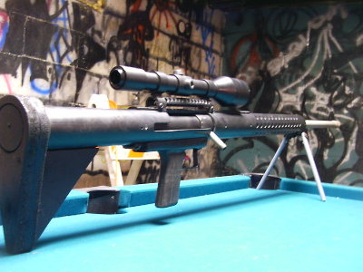

Wow. that looks beautiful. any chance of some more picks and detail?

Wow I love it! Very much like the Barrett M82!

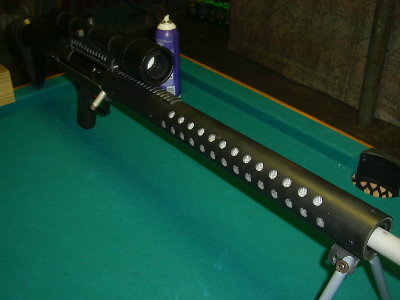

You know what I think would be good? If you could replace the screw end cap.
O-ring at the back of the chamber, O-ring an inch or two forwards, cut a hole in the side of the pipe between the two as your spray port...
Have the whole thing seal into the back of the stock (you might need to put a pipe in there), and that way you wouldn't need to unscrew the back each time - simply working the bolt action would open it up for you to spray into. And when you close it up, the O-rings would seal against the inside of the space in the stock.

I like that idea! Definitely would speed up the fueling and shooting process... even better, auto propane injection and venting

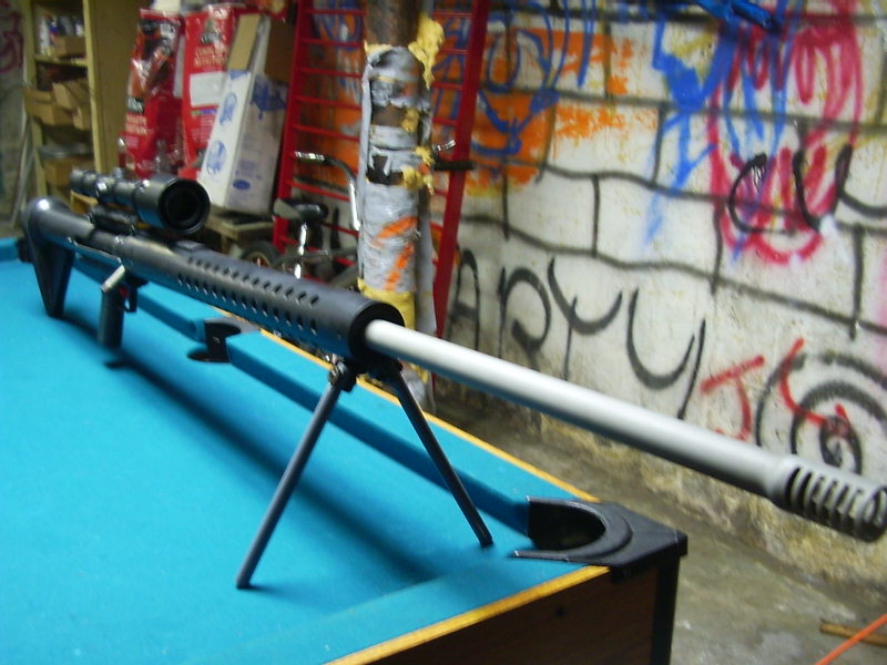

wow nice job! that is definately the best spray and pray i have ever seen too. hope you don't mind, but this gives me some serious inspiration and motivation for me to build an advanced combustion similar-ish to this

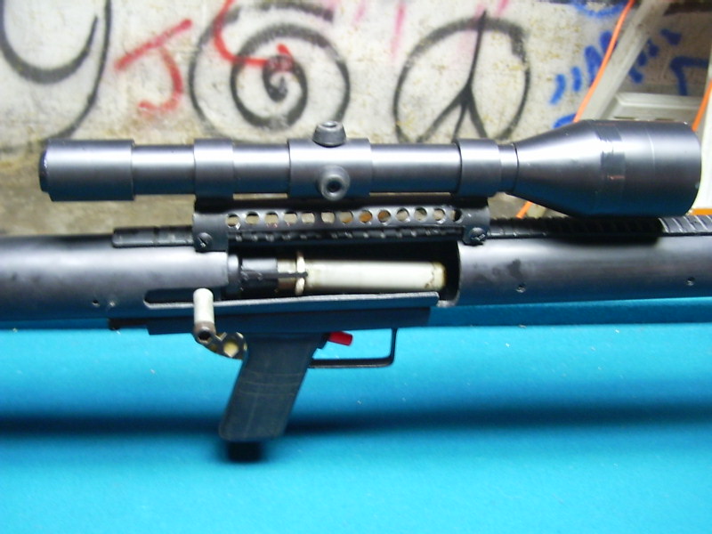

I had missed this, very well put together. I second the suggestion for proper metering though, and surely after what you've accomplished it would be worth fitting an extractor that pops the shell out after firing...
