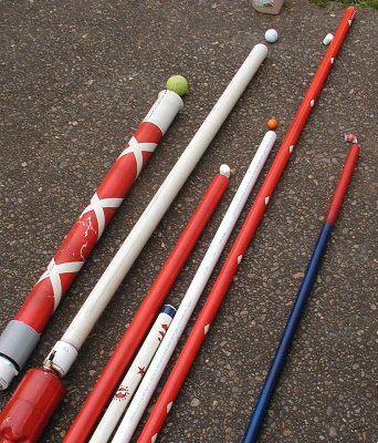

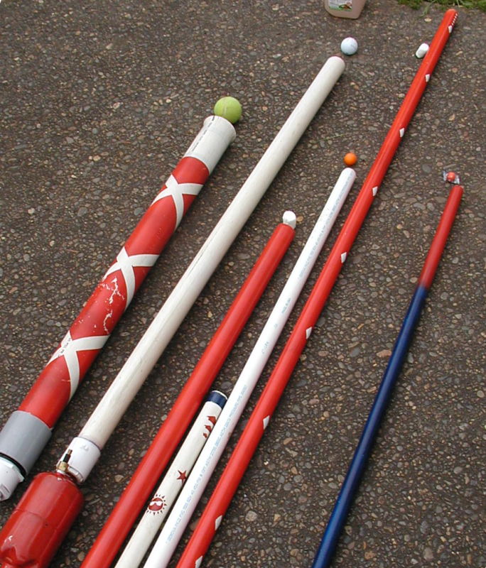

Definitely don't shorten it. Good performance can be had with high pressure and a moderate size chamber. Here is my Marshmallow cannon. I have a selection of screw on barrels for various ammo sizes. The golfball barrel is the one attached to the launcher in this photo.
