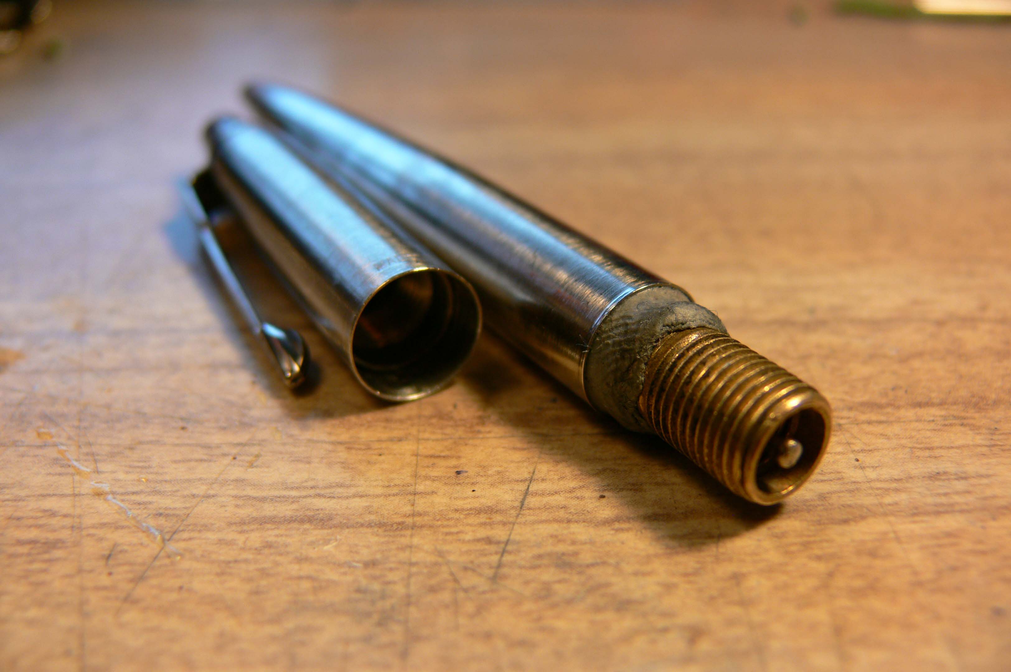

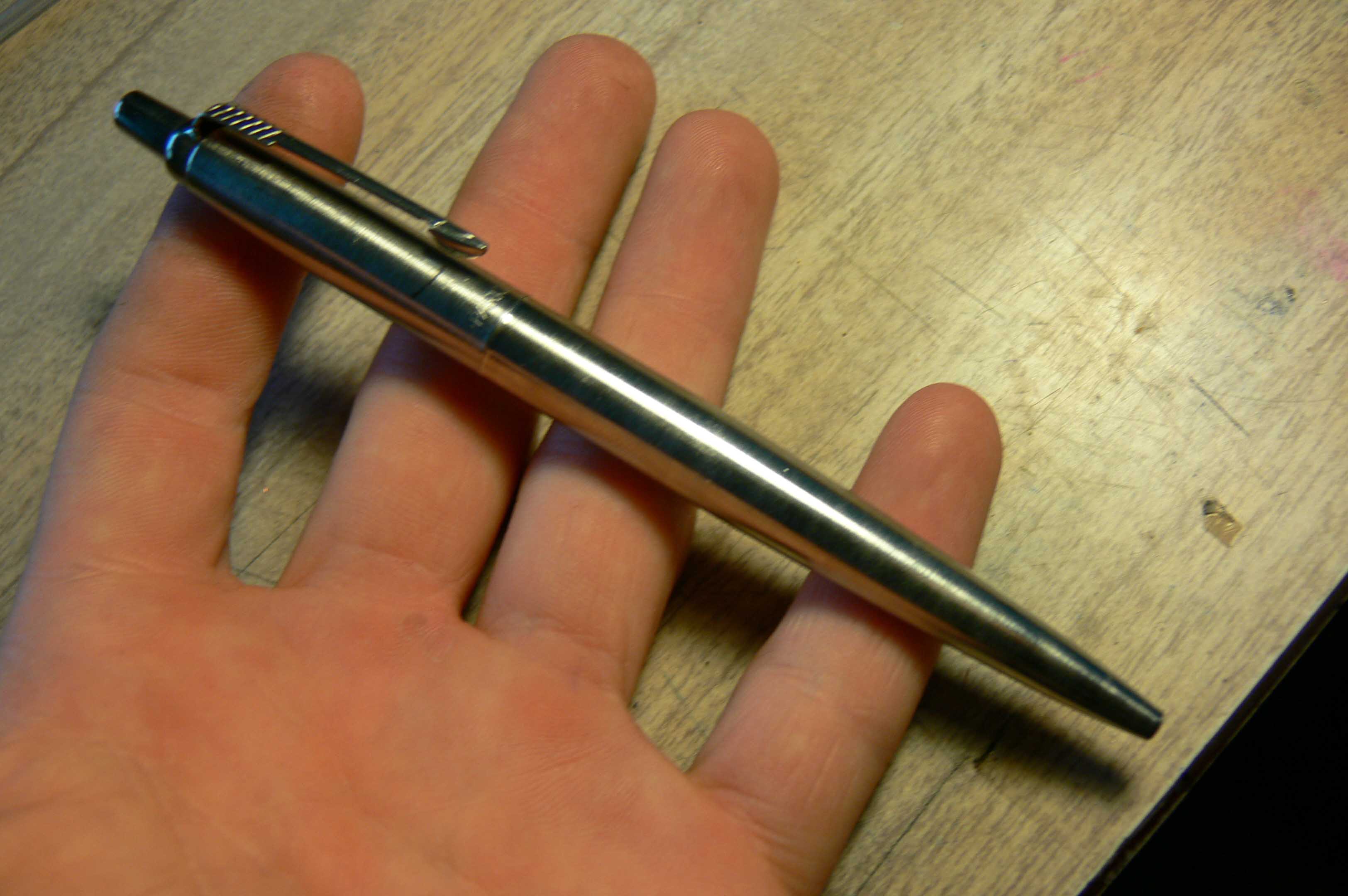

its a gun! this is my pen gun i made from a broken Parker pen, it looks just like it did before i started except the part when you push the button it shoots something, check it out!
barrel: 50mm x 2.5mm brass tube
chamber: pen
valve: schrader
firing mechanism: modified pen cap
pen: 130mm

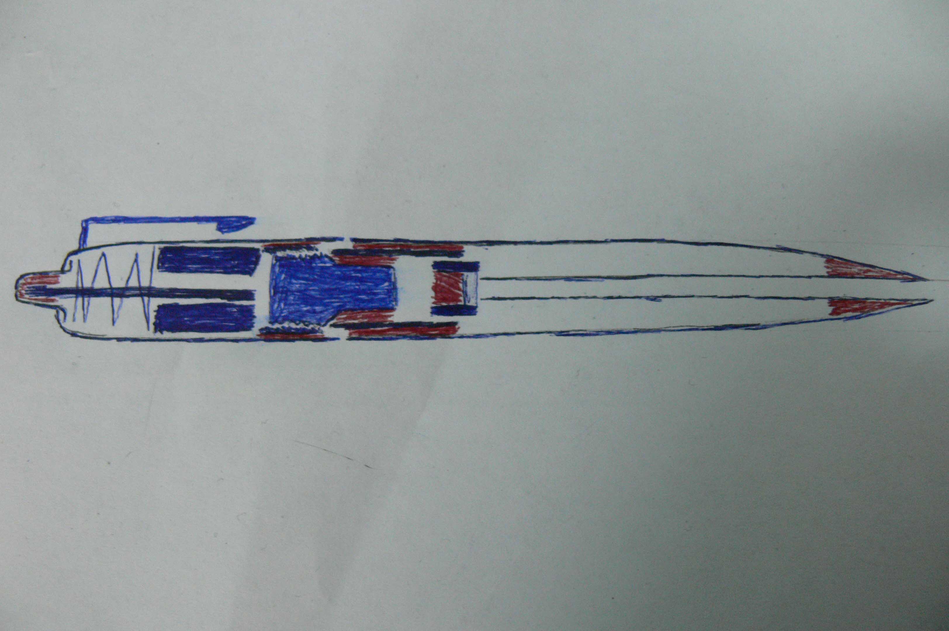

sorry about the bad drawing hope you can still understand it!

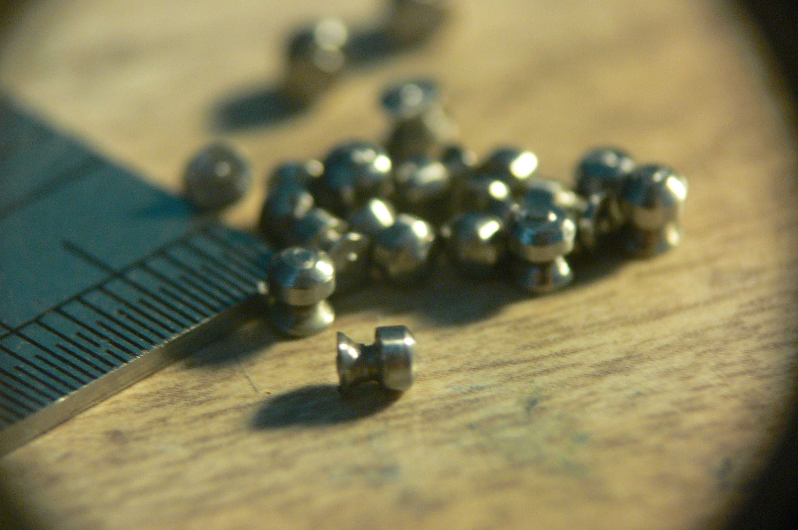

these are some 2.5mm ammo i made for it cut from a nail using my dads small grinder

It's beautiful! as long as you roughened the epoxy-bound surfaces well, I'd be very confident in taking that as far as a shock pump will give out. I used 5 minute epoxy on my last pengun, and it's 100% leakfree and it's structural integrity is fine. Roughening is definitely the key.

inonickname wrote:It's beautiful! as long as you roughened the epoxy-bound surfaces well, I'd be very confident in taking that as far as a shock pump will give out. I used 5 minute epoxy on my last pengun, and it's 100% leakfree and it's structural integrity is fine. Roughening is definitely the key.
thank you, yes i did roughen it a bit probably could have done some more but ill put it under something when i fill it first, and i have been able to get 80psi into it but there is a small leak from the piston not sealing properly could higher pressure fix this?
thanks
