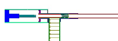

This is a design I hard drawn up for a gas piston operated cartridge fed design, never built it though.

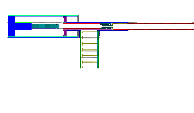

i was thinking about a low pressure valve at the end of the piston rod and using it similar to a relay to then activate a high pressure valve to then cycle the bolt and cock the the striker for firing

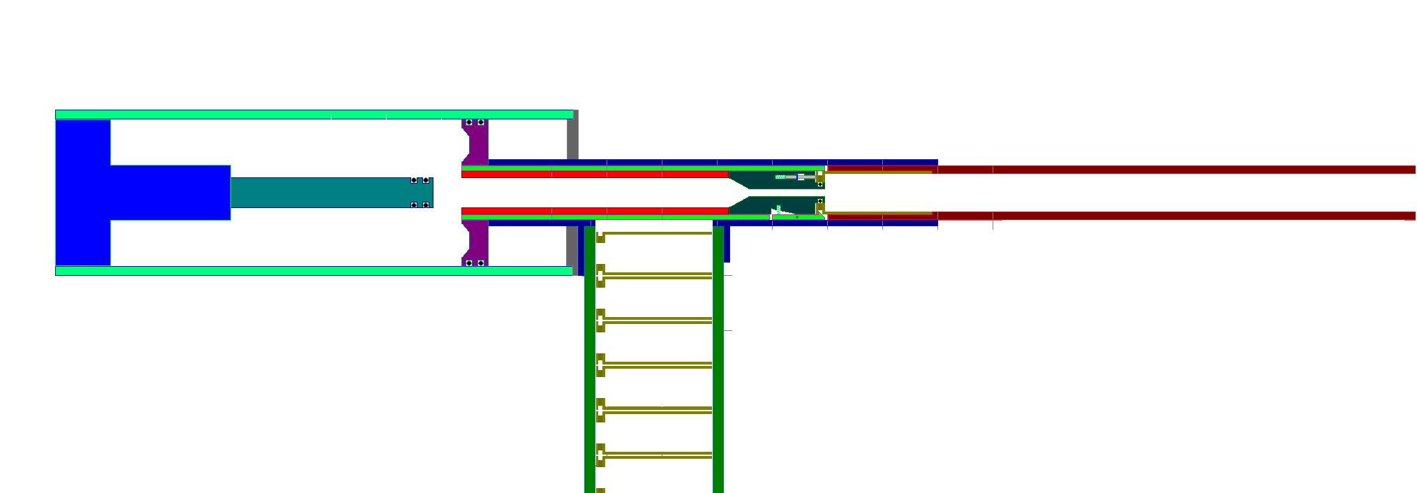

her is my concept design of a blow forward catridge firing air/co2 rifle that i finished last night. this particular design will allow to have 70% of the length of the rifle to be barrel. it comes in handy if your buiding a carbine and/or rifle that has high accuracy. feel free to post any comments, thoughts, ideas and improvments to my design

That's a fairly complex ejector/extractor mechanism you've got there, but if you can make it, it can work. My one gripe is that flow restriction in the bolt that will certainly hurt performance.

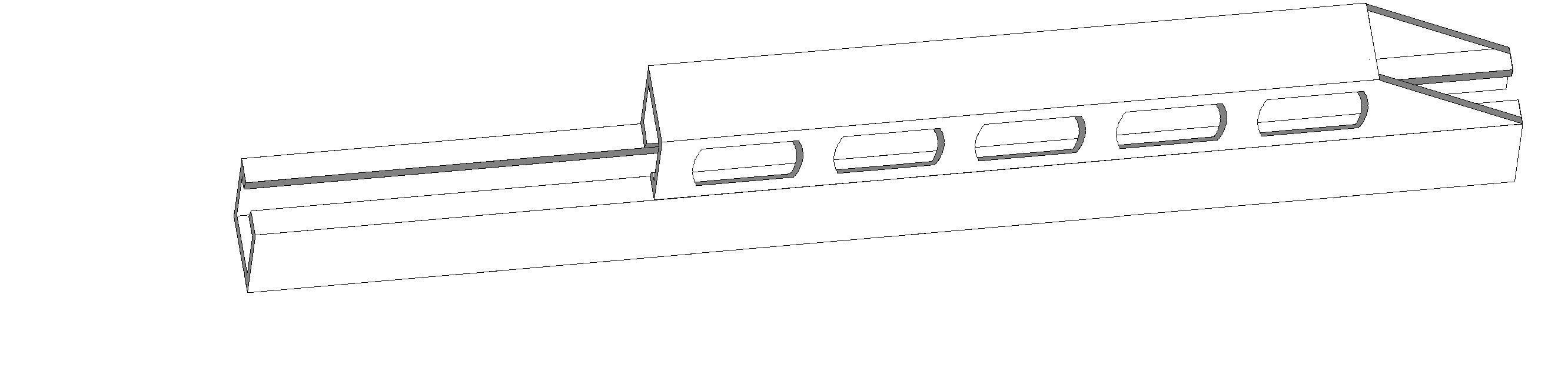

the air flow restriction in the bolt is one of my main concerns. i have limited access to materials do to the fact i live in rural alaska. i do not like to use any other materials than brass, aluminum, steel, copper, and that teflon stuff ( the name excapes me) i obtain my materials by recycling. the frame of my rifle is built out of 1"x1 1/2" aluminum channel.
any help is much welcomed so i can further refine and finalize my design.
