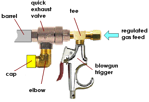

Here's what the semi-auto valve mechanism could look like using off-the-shelf parts, pretty self explanatory:

jackssmirkingrevenge wrote:Here's what the semi-auto valve mechanism could look like using off-the-shelf parts, pretty self explanatory:
Bah that setup is wasteful. Better off with a slide valve to actually shut off the air supply.
@Chosen_1: The parts are labeled in that diagram... It's just a matter of selecting their sizes and locating them. You have all you need. :lol:
