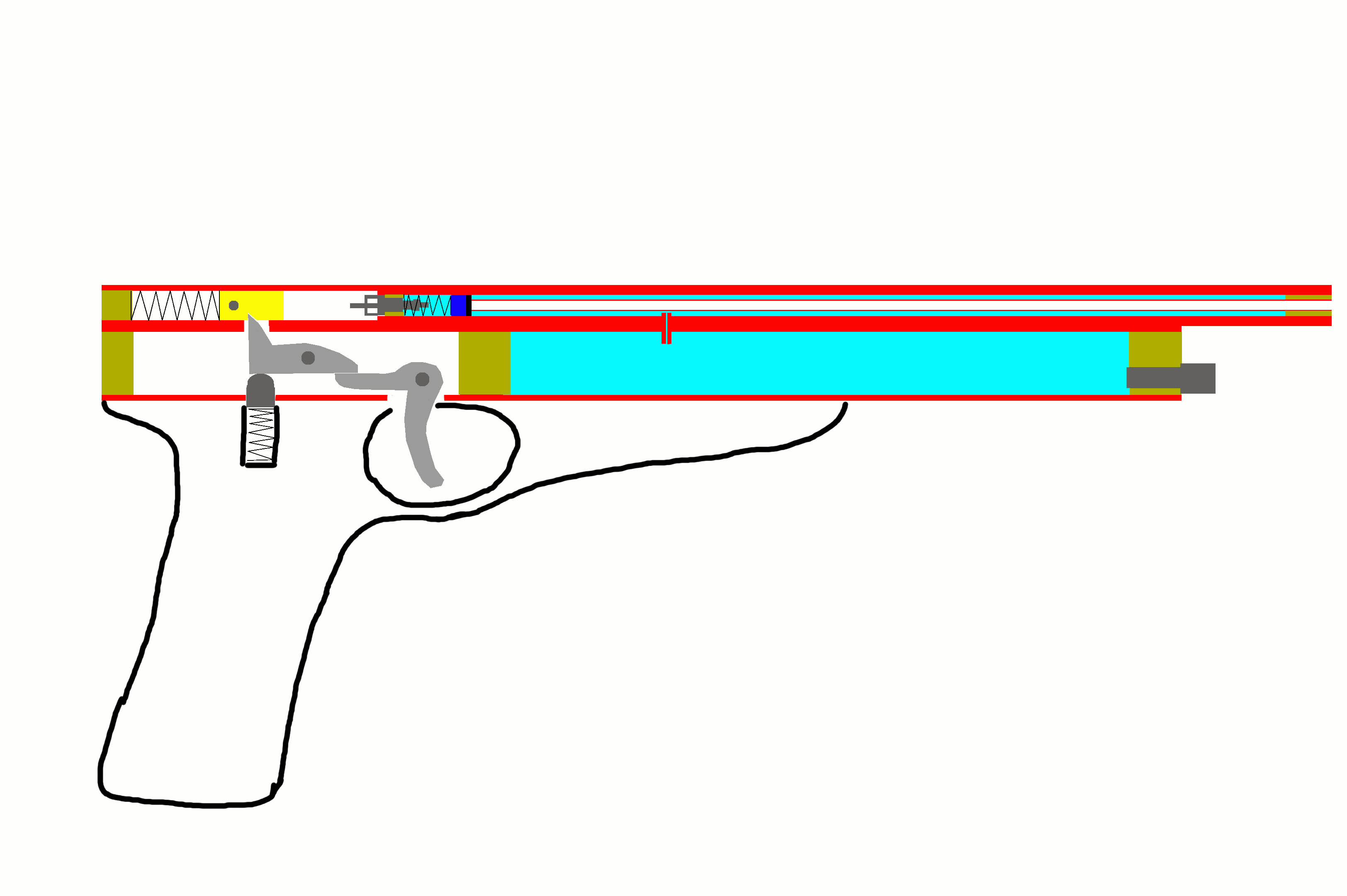

hey guys, i am thinking of making this design for a multiple shot 2.5mm bore air gun and would like to know if it would work or is my design floored?
just a quick diagram i made, shouldn't be to hard to understand but if there are any questions i will be happy to answer them.
thanks for your help

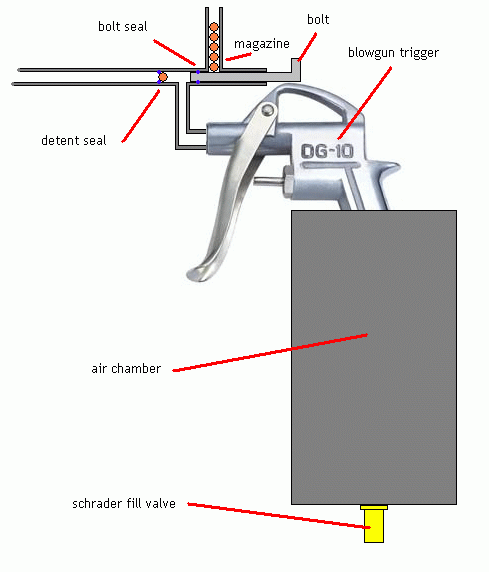

build a bolt action valveless gun... you can use blowgun as the trigger and it should have much better performance... I hope you know what I am talking about ??
Been thanked: 350 times
POLAND_SPUD wrote:build a bolt action valveless gun... you can use blowgun as the trigger and it should have much better performance... I hope you know what I am talking about ??
Something conceptually like this? It would certainly have much better performance and efficiency, though it is a tricky build with standard parts.
yea that dose look a bit tricky to do with the size im making it plus im kinda strange in a way that aesthetics to me are almost as important as performance, but i was hoping for it to be of similar power to my pen gun for a few shots at least
If you make it like this it will be much simpler and compact, and give you the option of auto fire as well. Also using a small calibre, 2-3mm, you'll get a lot more shots per fill.
yeah, that's what I was thinking about
You'd probably use epoxy to build it but I'd preffer two 1/4" Ts, barrel with two ports cut in it and a few compression fittings to seal it
with a single acting air cylinder it might work like a semi (provided that the pressure drops significantly when you press the trigger and the gun fire... and voila ! you've got a semi pistol )

both of your suggestions are good but i am kinda wanting the design i had there are just two things i really want to know
1 will the design work?
2 would it be capable of similar performance as a pen gun?

The second design is basically a scaled down version of this, it will give you better performance than a pen gun and the possibility of automatic fire.
However, your design will certainly work, but with certain disadvantages, namely:
- the hammer has to be manually recocked after every shot, unless you make it recock through pilot pressure by making it airtight, but this would involve a complex balancing act of spring pressure and venting
- you need to install a magazine unless you plan on reloading it through the muzzle for every shot, and this isn't too easy to achieve with a coaxial

jackssmirkingrevenge wrote:The second design is basically a scaled down version of this, it will give you better performance than a pen gun and the possibility of automatic fire.
thank you it is good to know that it will work and i have no problem with recocking and muzzle loading so i think i will give it a go, also i have a spear blowgun on my desk and i am kinda liking your idea even more but i think ill have to save it for when i find a supply of small ball bearings :)
