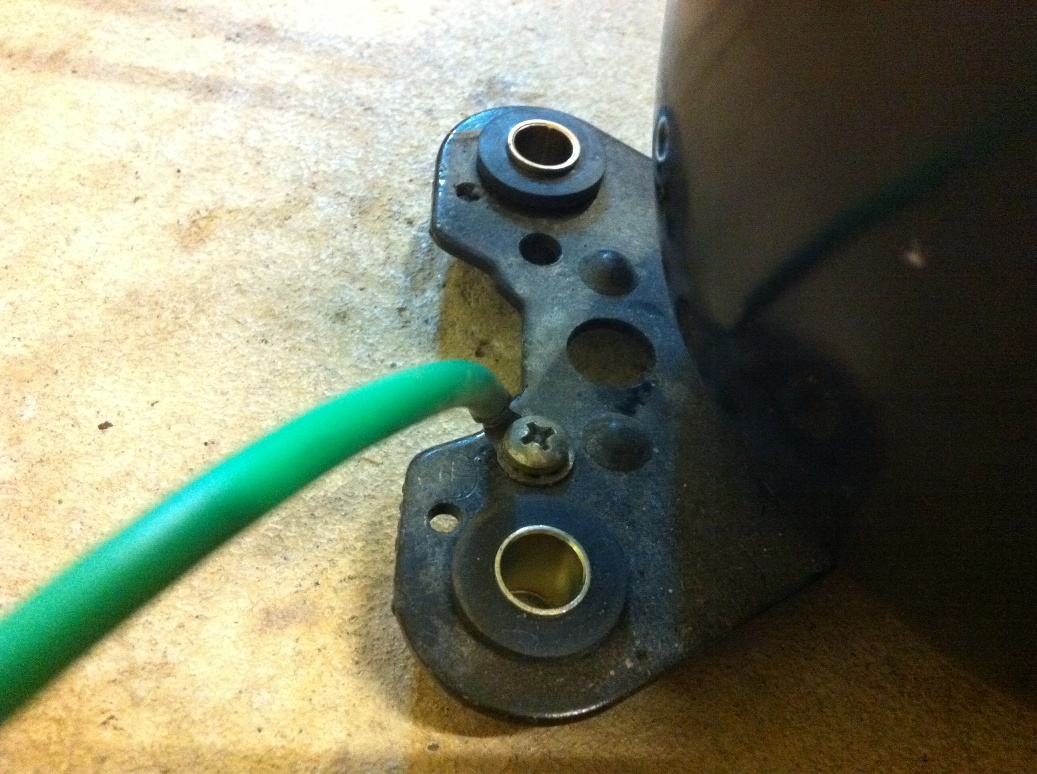

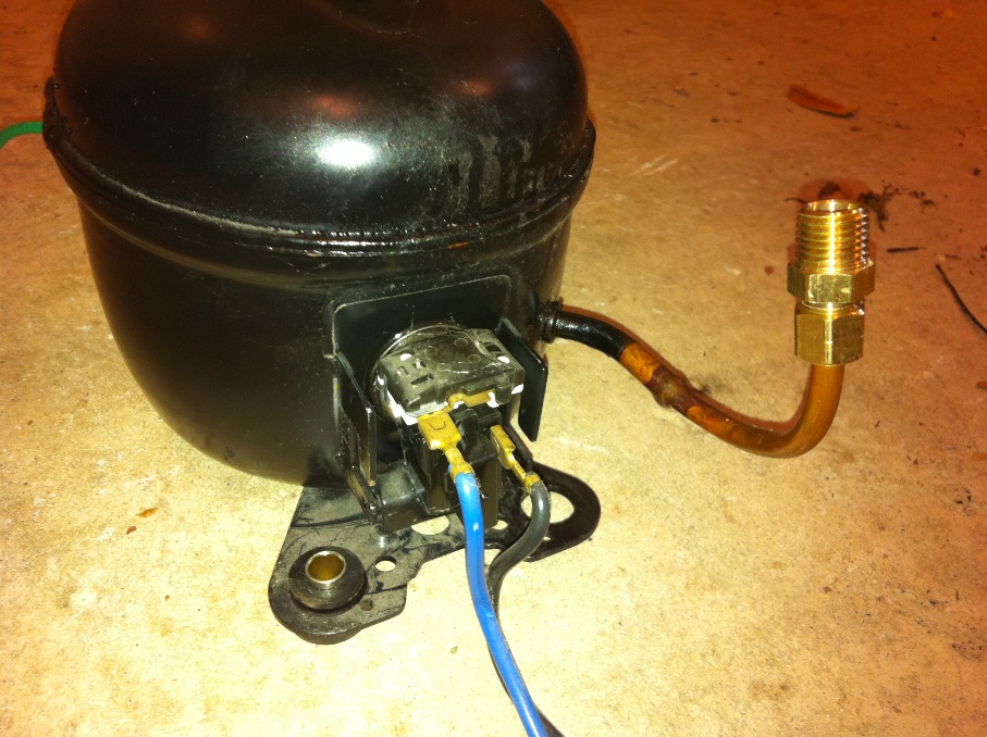

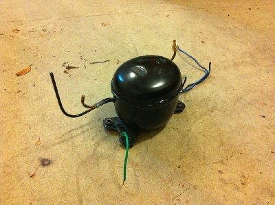

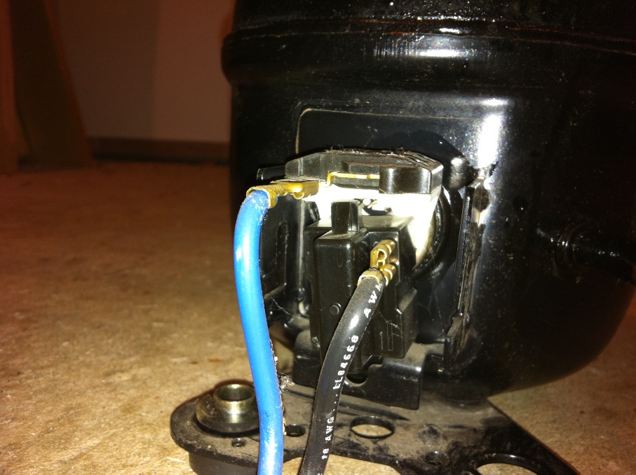

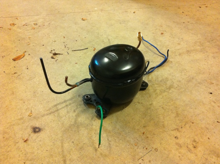

Well, today I managed to find a fridge compressor in a medium sized fridge. I was just curious how I am supposed to wire it up. Here are some pics:
There were only 3 wires entering the compressor, 2 wires (blue and black) to the side of the compressor, and one wire (green) bolted to the frame. I would assume that green is ground, black is -120 volts, and blue is neutral. How should I hook them up? I did not see any starting capaciters or relays. Just those 3 wires that entered the inside of the fridge compartment by the top. I just cut them near the hole, and unbolted the compressor.

Your assumption is correct. The phase shift for starting is taken care of by the starting relay which is the lump that the blue and black wires attach to. Underneath the lump (it unplugs from the compressor) is 3 terminals that goes through the steel shell. The 3 terminals are Common, Start, and Run. The frame safety ground is the green wire.

Yes, that lump is the starting relay. When stalled (not running) the run coil draws high current which pulls in the relay and connects the start winding too. When the compressor comes up to speed, the run current drops (start current is still high) and the relay drops out leaving power on just the run winding.
This external relay eliminates the internal centrifical switch on normal single phase induction motors such as found on sump pumps, bench grinders, drill presses, table saws and such.
The spark of an internal switch would damage the freon with each operation eventually destroying the freon. Placing the relay external allows the relay to be replaced when it fails and reduces the probability of a failure inside the sealed case.
