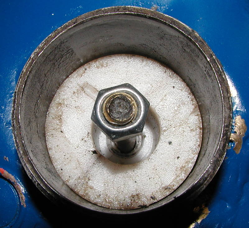

If you look at the bottom edge of the photo below inside the pipe, you will see the groove where the pipe seam is located. It is just right of the 6 o clock position. It is now a smooth wide valley and very shallow. It seals fine. This camera angle tends to hide it. I was showing off the polished pipe and piston clearance, not the seam of the pipe.

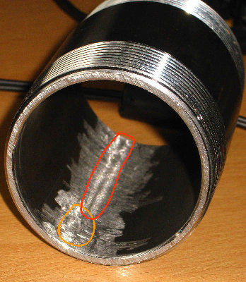

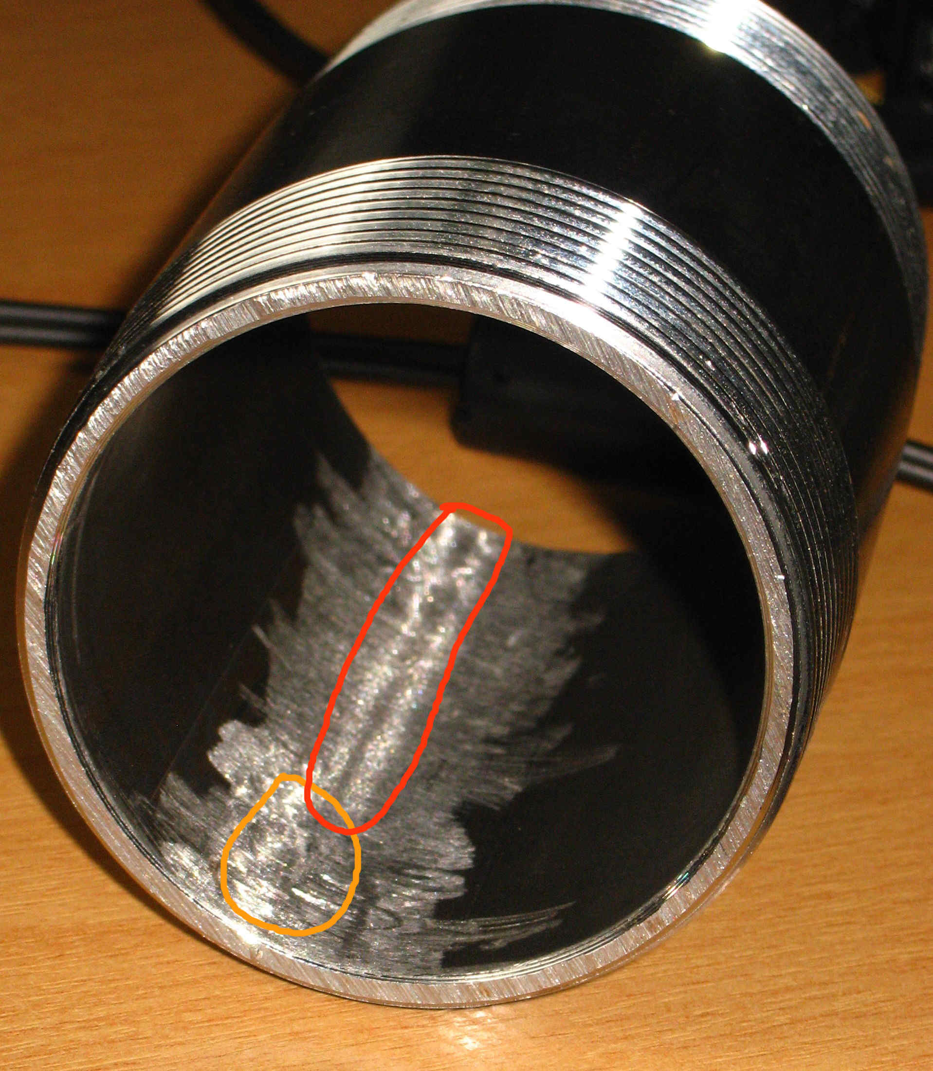

Attached is a photo of the barrel nipple. The red-orange area is where the seam was but as far as I can tell, is raised and not pitted. The yellow-orange area is where the seam was but appears to be pitted, i.e. has a surface deeper than the original inside diameter.
The red-orange area is where I will work on smoothing out to match the depth of the rest of the surface. The pitted area I will try and smooth out, though I am not too worried that it is pitted because this will be near the back of the valve with the o-rings being in front of this area. Once the o-rings are back behind this area, the valve will be open and the 100% seal wont matter anymore.

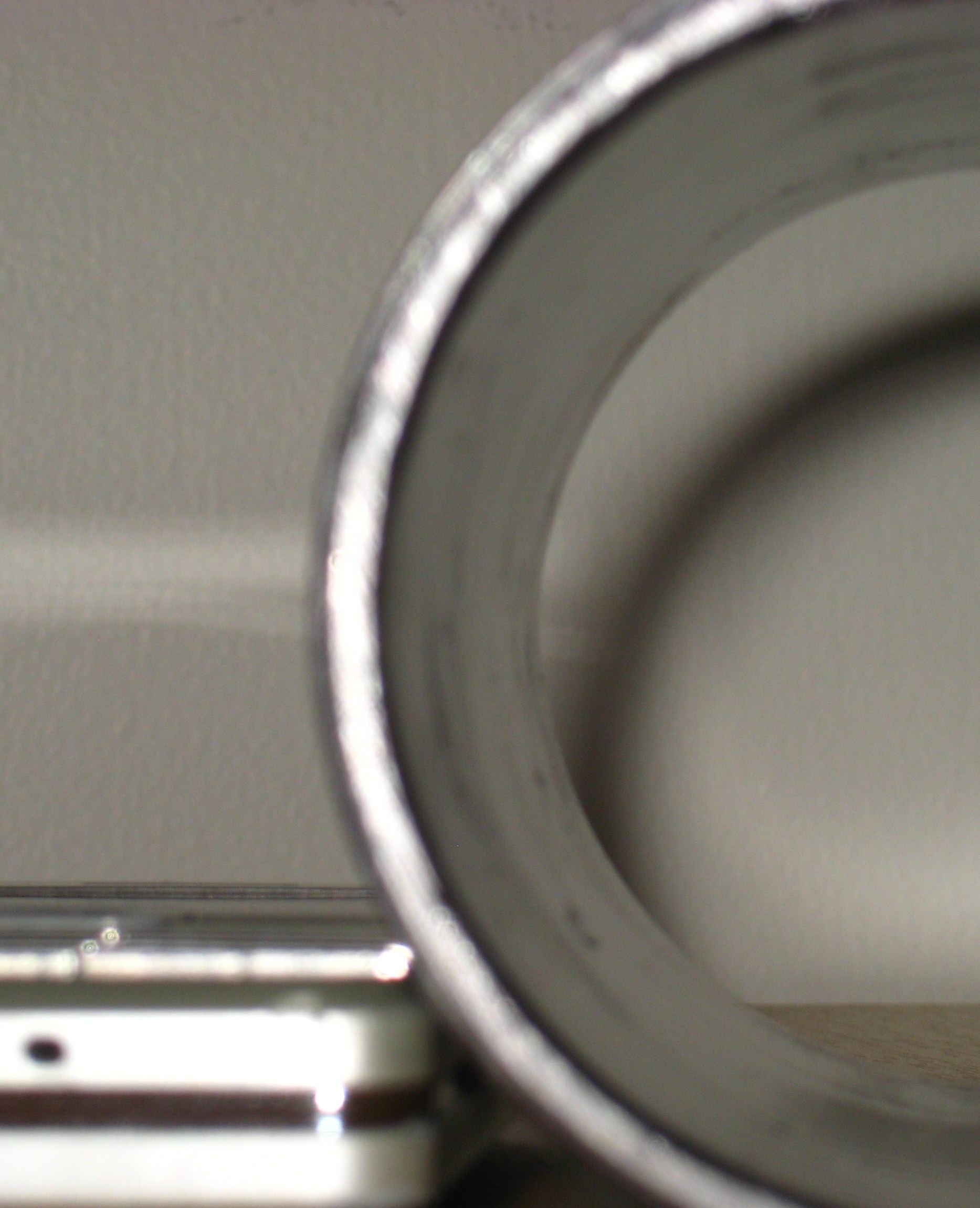

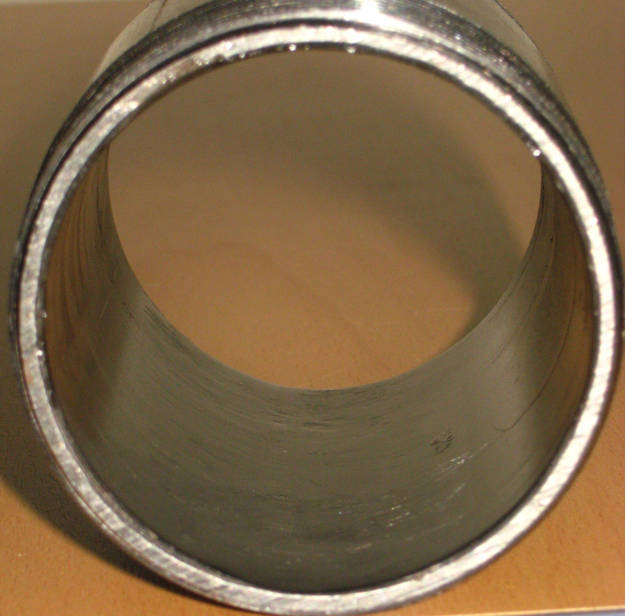

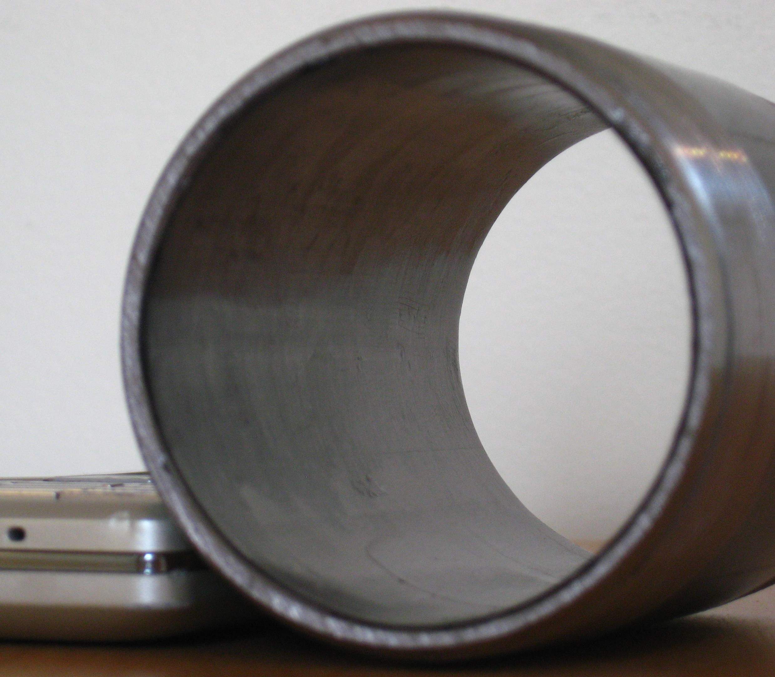

Thanks for all the help. Tech, I just tried the sanding flap wheel on my dremel (although, after I had already done all the hard work) and it worked pretty well. The sanding made it really clear where the pits are (seems to be about 3 or 4 near one end) and the seam is virtually gone and I can't feel it when running my finger over it.
The piston fits bloody great with the help of some vaseline. Can't see any light coming through (tested before I used the vaseline) at all. Here are some pictures. In the last picture, the seam is at the 6 o'clock position. You can see the pitting at the back of the nipple in this photo. In the other two photos the seam is at the 9 o'clock position.
