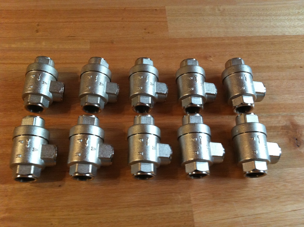

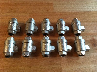

POLAND_SPUD wrote:(WTF??!!)
- Lockednloaded
- Staff Sergeant
- Posts: 1566
- Location: Texas, USA
- Been thanked: 7 times
You Lucky SOB!
what company screwed up so bad?
And a 1/4" QEV should solve the piloting problem,
Oh and if your planning to get rid of some, I'm your man
I love lamp
