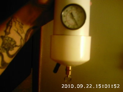

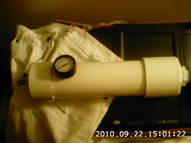

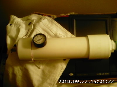

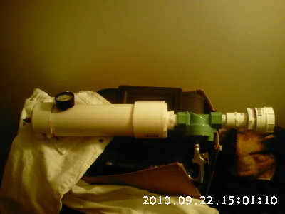

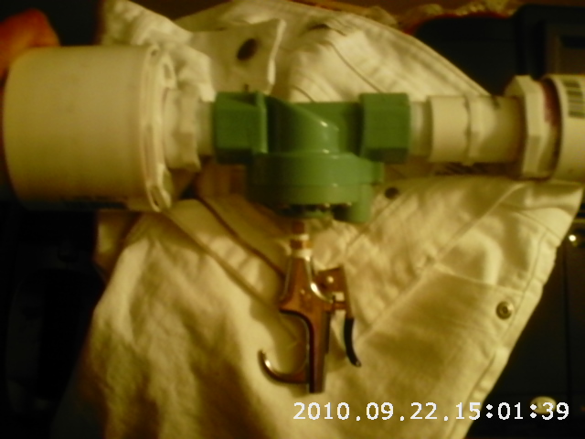

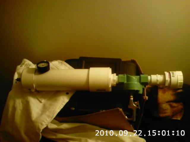

here is a few picks of the chamber and valve assembly. i didn't include the barrel cause i made it interchangeable, all my PVC pipes are pressure rated.
My downfall is the end cap, coupling's and other attachments i had to buy didn't say if they where pressure rated or not.
my modded 1 inch automatic inline sprinkler valve

the chamber is made from a 1' long piece of 3" sch 40 pvc the is pressure rated to 260 psi
here is the full chamber valve assembly

With that way you drilled into a single layer or pvc three times, I would only trust this launcher up to 100 psi. Some people may suggest even lower :D How high have you been using it?

The only problem I see is that you tapped the gauge into a single layer of pipe. If not for that I would say 80 PSI, but since you did personally I would rebuild it but at 30 you MAY be safe. Other than that nice, clean first pneumatic.
Edit-Gen Freak beat me to it but trust me, 100 PSI is not a good idea
Very good performance can be had if you didn't use a small restrictive valve between the chamber and barrel. Best performance is had when the valve is at least as large as the barrel. A 1.5 inch valve will out perform a 1 inch valve by about double. A 2 inch valve is often cost prohibitive. Price skyrockets with larger sizes.
