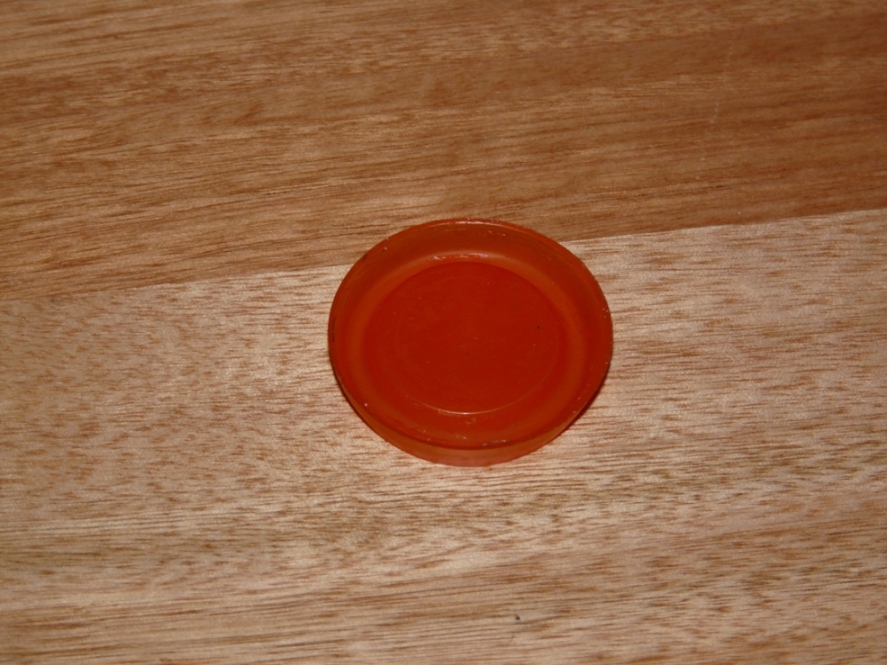

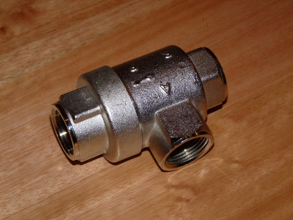

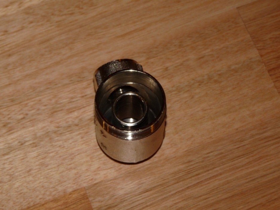

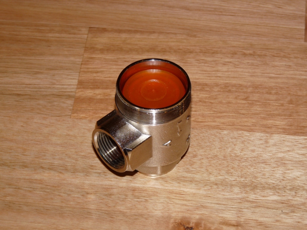

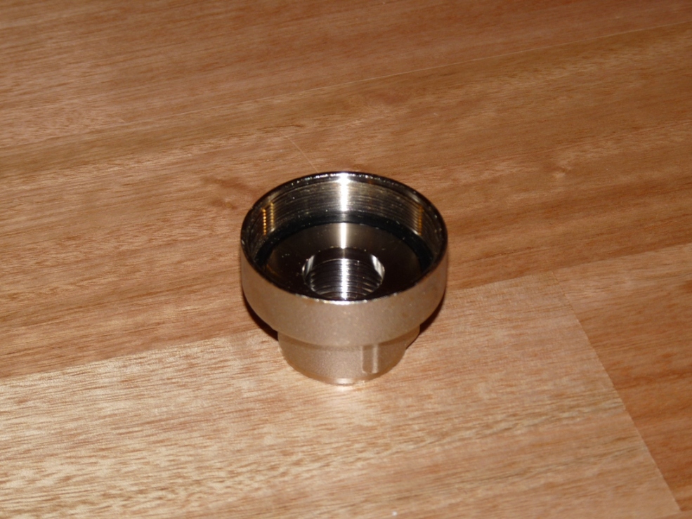

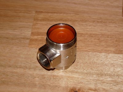

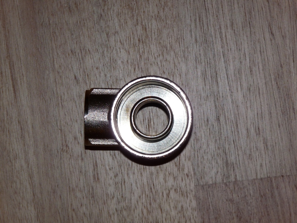

Well, I decided to take apart one of my 3/4" European QEV's to model it accurately in GGDT. Here are the specs:
-3/4" (pipe threads) input/pilot, chamber, and exhaust ports
-3/4" (actual) diameter diaphragm seat
-1.5" diameter diaphragm (extrememly light)
This particular model works very well, becuase it has no support struts in the pilot and exhaust ports.

Wow, the internals look very nice! Is it a diaphragm or a piston? I want to get my hands on one of those, but I don't really have the need for one. Hell maybe 10 of them will show up at my doorstep :D
BeaverRat
Posts: 161
Joined: Wed May 05, 2010 9:15 pm
Yeah, it's pretty beautiful construction... It is nickle plated brass.
Oh, and it is a piston design. Plus, it opens far enough to have no flow restriction too!

Anyway, for the sake of doing something a bit more relevant to the thread's original purpose than worrying about naming, I disassembled my 1/2" QEV (Piston or European style, whichever you prefer) earlier, and took some measurements.
1/2" BSP threading.
35.1mm piston diameter.
14.2mm seat diameter.
4.4mm piston movement.
4.76 gram piston.
15.3 cc internal (chamber side) volume, not including volume in the threaded port.
Internally pretty much identical to the pictures above (save for the fact that a few years of use has introduced a light coating of muck to the internals).
