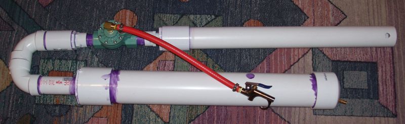

Off the top of my head, barrel length of 4-5 feet and a chamber volume 1-2 times that of the barrel should give you the performance you require, and it can be as simple as this:

Are you sure that size launcher can reach 400 yards? In testing my Marshmallow cannon with a golf ball barrel, it reached only 275 yards at 100PSI. I have my doubts that a compact 1 inch sprinkler valve launcher will meet the distance requirement.
Does anyone have measured distance for sprinkler valve GB launchers?
The 100 PSI GB shot was with a 1 inch valve launcher. The 50 PSI GB shot was with a 2 inch valve launcher.
With a larger chamber and longer barrel, it may gain the additional 125 yards needed to meet the goal. This is the launcher configuration that launched the 100 PSI shot. A compressor set to 100 PSI was used.
