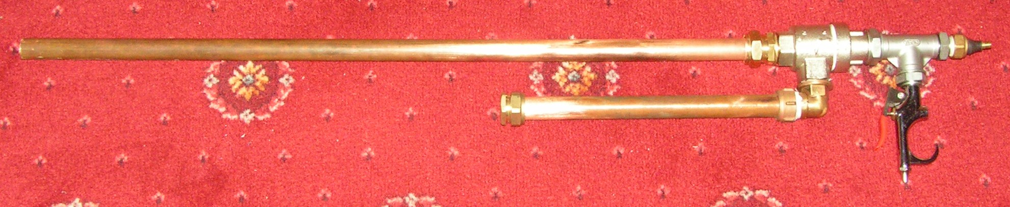

I joined the forum about a month or so ago and after having a good look around the forum thought it was time i had a go myself and the attached pic is the result, the problem i am having is i can only get it up to about 40 psi that is using a clark air compressor, what am i doing wrong ? would appreciate any help on this.

What happens at 40 psi, does it start to leak or can't the compressor cope? If you block off the compressor pipe will it pressurise it any higher?
Very nice first effort by the way, given the copper construction you should consider buying a shock pump or adapting a fridge compressor in order to take it to 300 psi and beyond

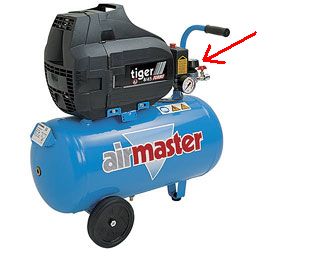

thanks for the reply, there is no leak and my compressor pumps no more than 40 psi the air transfer just stops, how do you mean block off the compressor pipe ?, this is my compressor I think it is good to 115 psi got a shock pump on the way to me but that might take a hell of a lot to pump to high pressure.
Check the regulator knob (arrowed), tighten it clockwise and see if it makes a difference

- untitled.jpg (13.3 KiB) Viewed 5004 times
What about the filling attachment, maybe it has an in-built limiter for 40 psi?

It would make sense, you don't fill up tires above 40 psi often. Look for a different attachment, maybe some quick disconnects or something.

you could put a male quick connect in the bottom of the blow gun and get rid of the tee, or leave it so you can still pump it with your shock pump

If the compressor is not at fault, either there is a restriction closing off flow when the cannon is up to pressure, or the gauge on the cannon is not indicating the correct pressure.
I have had the gasket in the fill adapter get grease in it which expands the rubber, which permits filling as air forces its way through, but when the differential is low such as the cannon rising in pressure the rubber closes back off. This is the most likely fault. Is the seal in the tire fill adapter replaceable? Is it swollen and soft?
How do you know the cannon is only at 40 PSI. Have you screwed the gauge into the compressor to test the gauge? In a rapid discharge situation of an air cannon, I have had gauges on the cannon go out of calibration.

there is no gauge on the cannon but when i pump it up with the compressor to 40 psi then connect a shock pump to the cannon the gauge on that show 40 psi i can then take it to 100 psi os so with the shock pump but take a while.
