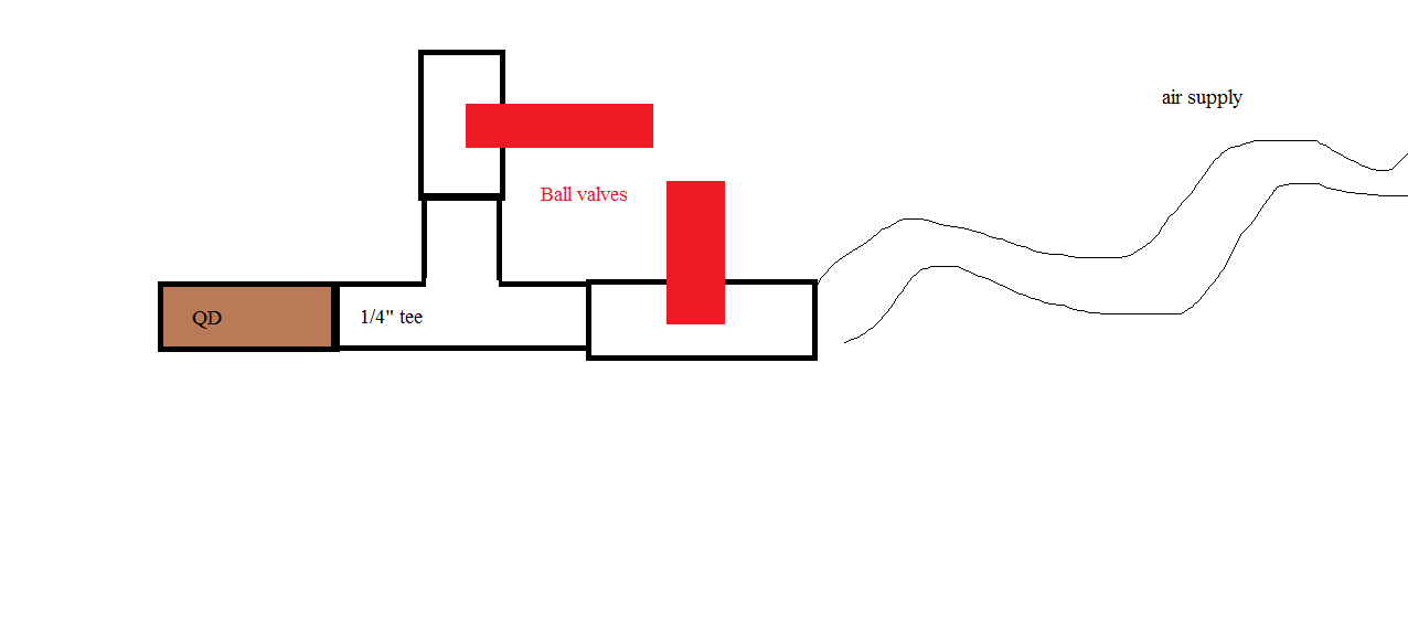

As long as you keep them under 250 psi, you should be able to disconnect them without draining the hose of pressure. Otherwise, you have to have a ball valve on the gun (even female QDs don't have a check valve, so if you try and drain the line without closing of the guns chamber with some sort of valve, the pressure will exit the guns chamber, because when a female and male QD are connected, the air has a straight path through) and a
Drain valve.

Gun Freak wrote:@BeaverRat, FQCs definitely have a check valve. They close themselves when there is no male QC inserted. (TWSS) :D
I never said they didn't close themselves when there is no male QC :wink: I simply stated that if you are at pressures above say 300 PSI, where it is nearly impossible to remove a QD female from a QD male, you must first drain the line pressure. Since the check valve is forced open when the male is in the female socket, draining the line before disconnecting will also drain the chamber. Where if there was a true stand alone check valve, the pressure couldn't leave the chamber, even if there was a male QD in the female socket. I stated (very messily) that an alternative to buying a check valve, would be to put a ball valve behind the female (or male) QD on the cannon, and a line drain somewhere else.
