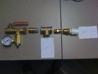

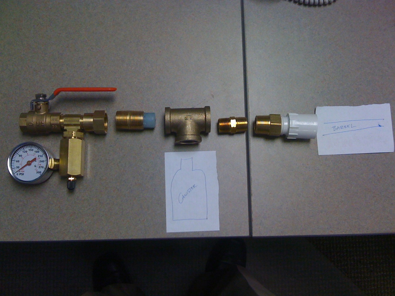

Sorry, not enough detail - I want to use these for air canisters. I'm having trouble finding a fire extinguisher bottle, so I thought this would be the next best option. But I want to know the down side to two vs one canister.
According to this How-To, I thought I could drill to opening out a bit (~5/8"), which is bigger than the orifice in my valve. So I hoped it would work. Am I misunderstanding something?Technician1002 wrote:Due to the way they are built, they are not able to provide high flow rates unless modified. The opening into the tank under the schrader valve is less than 1/8 inch in diameter.

I built one of the piston QEVs i found on here (finally found a solution to the hose barb needed - I used a pipe nipple instead) The smallest opening in there is about 1/2". I want to make two barrels that are interchangeable. I'm thinking marble size(~.5") and golf ball/potatoe size(~1.5"). I know the 1.5" barrel is probably going to compromise performance a bit, but this is my first cannon, so this is more about the build and experience than performance.
I attached a pic of my set up to this post. I haven't finished the piston yet. Any tips/critiques welcome.

A single bottle with as large as an opening as you can make will work best. Adding the plumbing to add two bottles will lengthen the pipe between the bottle and barrel and add more turns and fittings to cut the flow rate. You want as little plumbing as possible between the chamber and the barrel and it should be as large as possible.
