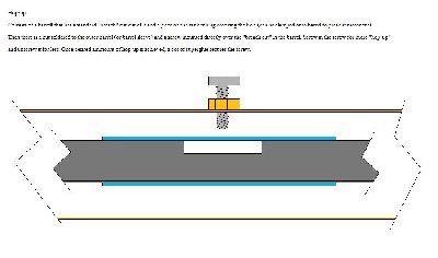

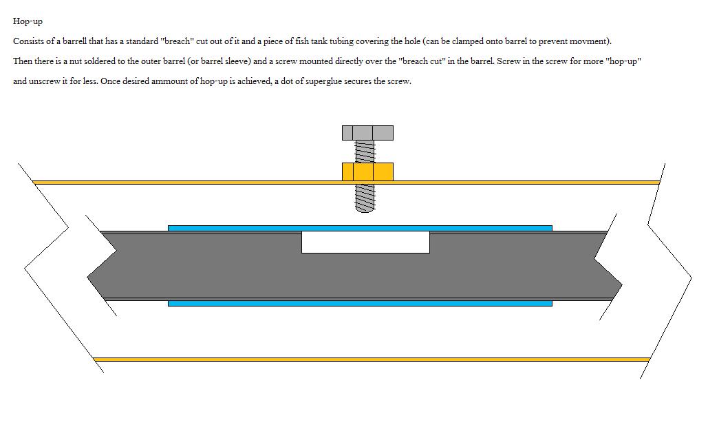

Edit: Just drew this up. would this work?
Thanks to the internet, I know everything about everything exept how to actually do anything.
Molybdenum wrote:would this work?
That should do nicely ;)

This is a subject near to my heart as I am currently building a vortex as well. The hop-up I was planing on using is basically the same thing BUT would be installed on the barrel a few cm past the vortex block.
A) Is this an acceptable hop-up design?
B) Is there any real benefit to having the hop-up at the ABSOLUTE beginning of the barrel?? or is it just as good to have it in front of the vortex block??
EDIT: sorry for the sub-par paint work... didn't feel like wasting 2hrs getting a point across. I believe its serviceable.
^(O_o)> Hi there
>(O_o)># I made you this waffle!
>(O_o)># then I remembered you were a dick.
(>#<) So I ate it.
ThornsofTime wrote:A) Is this an acceptable hop-up design?
It terms of spinning the projectile, it should work.
What could happen is that while the BB is stuck in the hopup, a following BB is "queued" behind it, so when the first BB fires the second one will blow the air flow and result in a weak shot.
Last edited by jackssmirkingrevenge on Mon Oct 25, 2010 3:43 am, edited 1 time in total.

The problem with the screw design is that it will either not put on much spin, or it will completely block the barrel. Why?
Look at airsoft hopup designs. The thing that pushes against the bucking (the rubber around the barrel) is pushed down by another little nub of rubber, this little nub is pushed down by a spring.
This means that even if the bucking is pushed far into the barrel (say it sticks in 1/3) the bb can still push through because the nub is spring-loaded.
In the case of a screw, in order to get adequate spin, you'd have to screw it in pretty far. But the bb can't push past the screw, because it's not on a spring- its rigid.
Which means your hopup will have to be set lower, and you won't get as much spin. Any amount of spin BELOW the sweet spot will actually make the bb dip down more than a bb with no spin at all. Here is the proof:
http://mackila.com/airsoft/ATP/03-a-01.htm
Scroll down to the graph of range vs. Spin.
